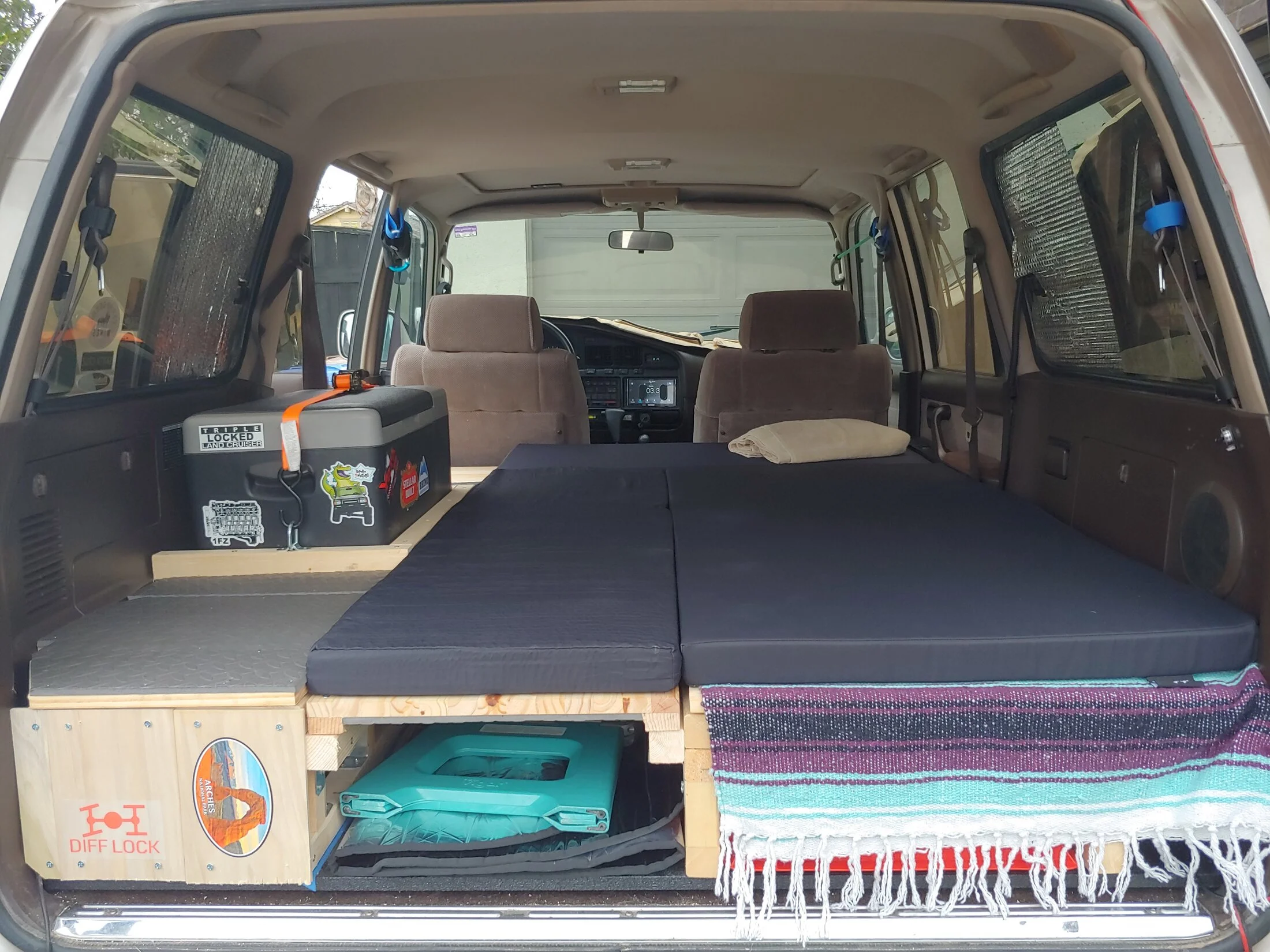

I put a drawer height sleeping platform in my LC.

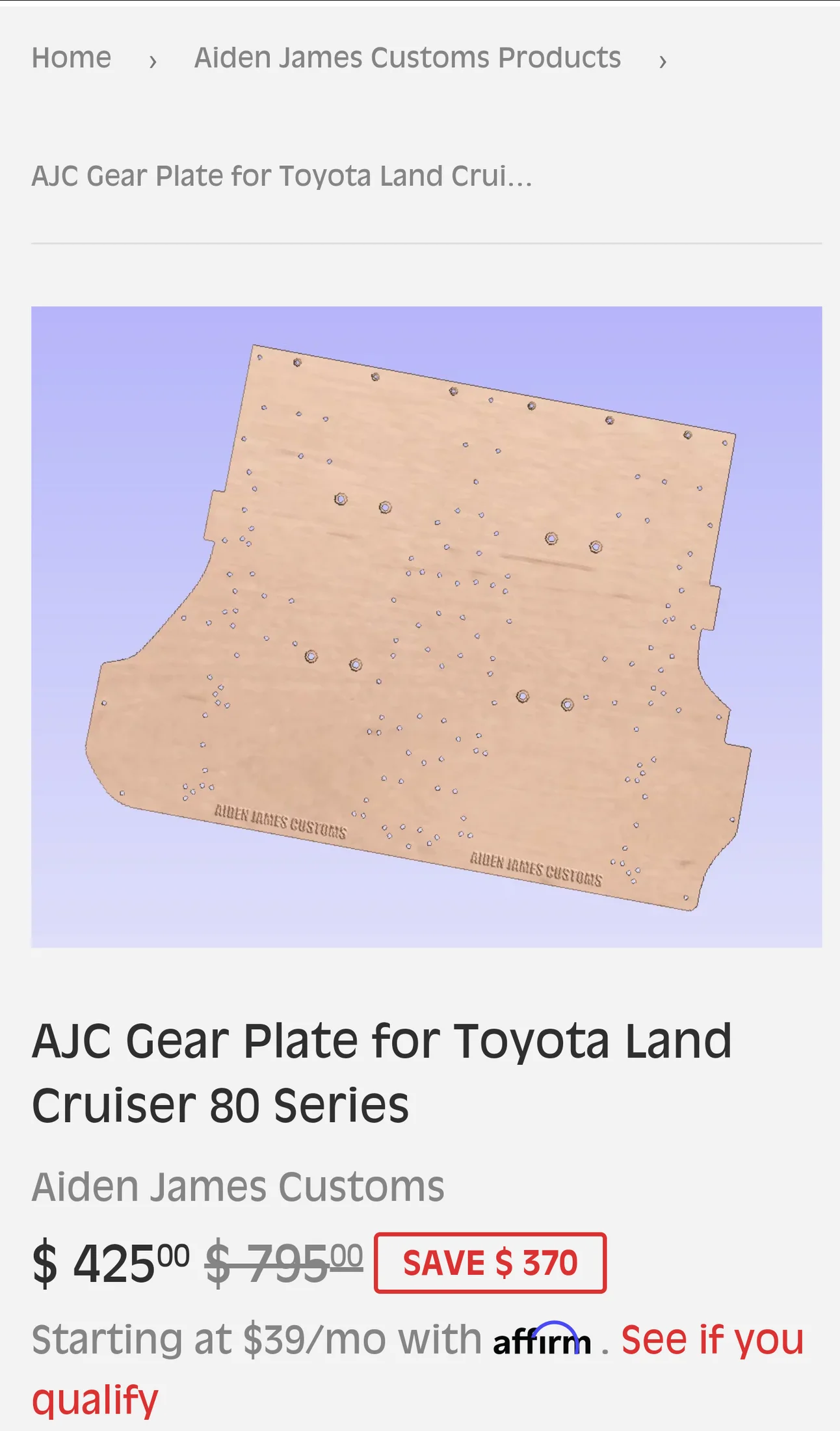

To save $$ i went with Aiden James Customs plates. Took longer to receive but price was in my range.

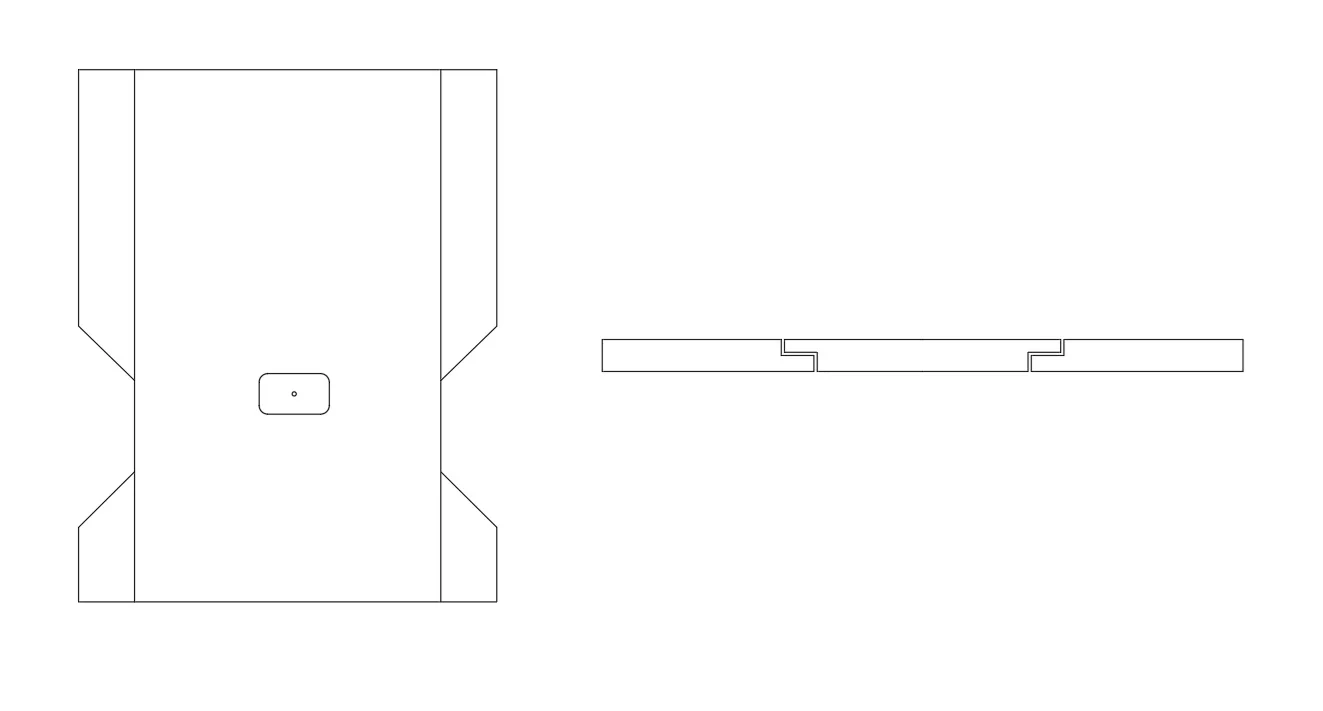

If you're going for an easy/affordable DIY build, I'd just run the sheet straight up the guts of the cruiser with bolt on (or just lay in place) wings on the sides. I've toyed with this idea a lot, I can draw you my thoughts but I can't really put them into words.
For support behind the front seats/under wings a simple frame built from this is cheap, lightweight, quick & plenty strong.
As for fuel pump, could you just jigsaw out a removable access panel and use a router to cut a lip for locating it? Something like you see on the right.
This is genius, I'm going to go this route. Thanks for posting it!

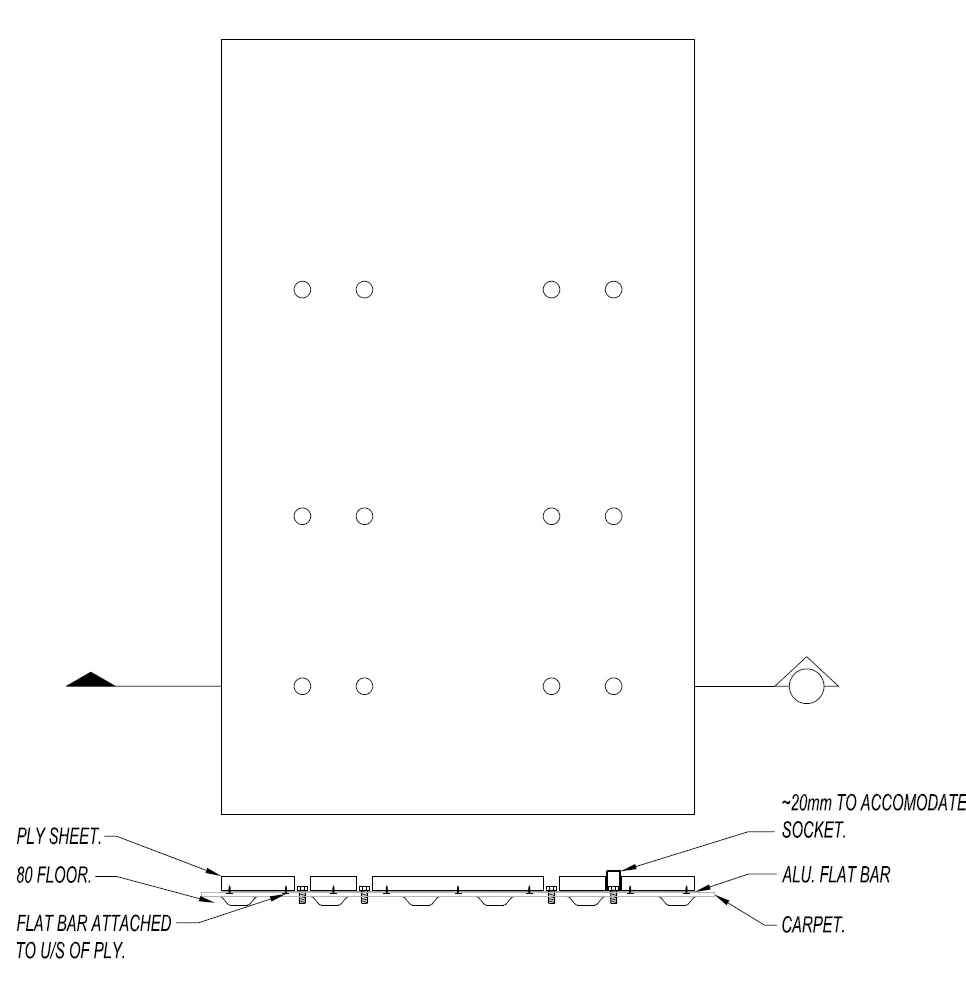

Buy some alu flat bar. Again, cheap, lightweight & only 1 - 3mm thick. Drill holes through to align with the factory seat mounting points. 6 points, 12 bolts I think.
Attach main sheet to the bar with a few screws.
Drill out an oversized hole through the sheet to fit bolt + socket.
Should give you a flush finish that can be removed in under 60 seconds with an impact driver.
Basic drawing with section below. Not to scale, but gets the idea across.

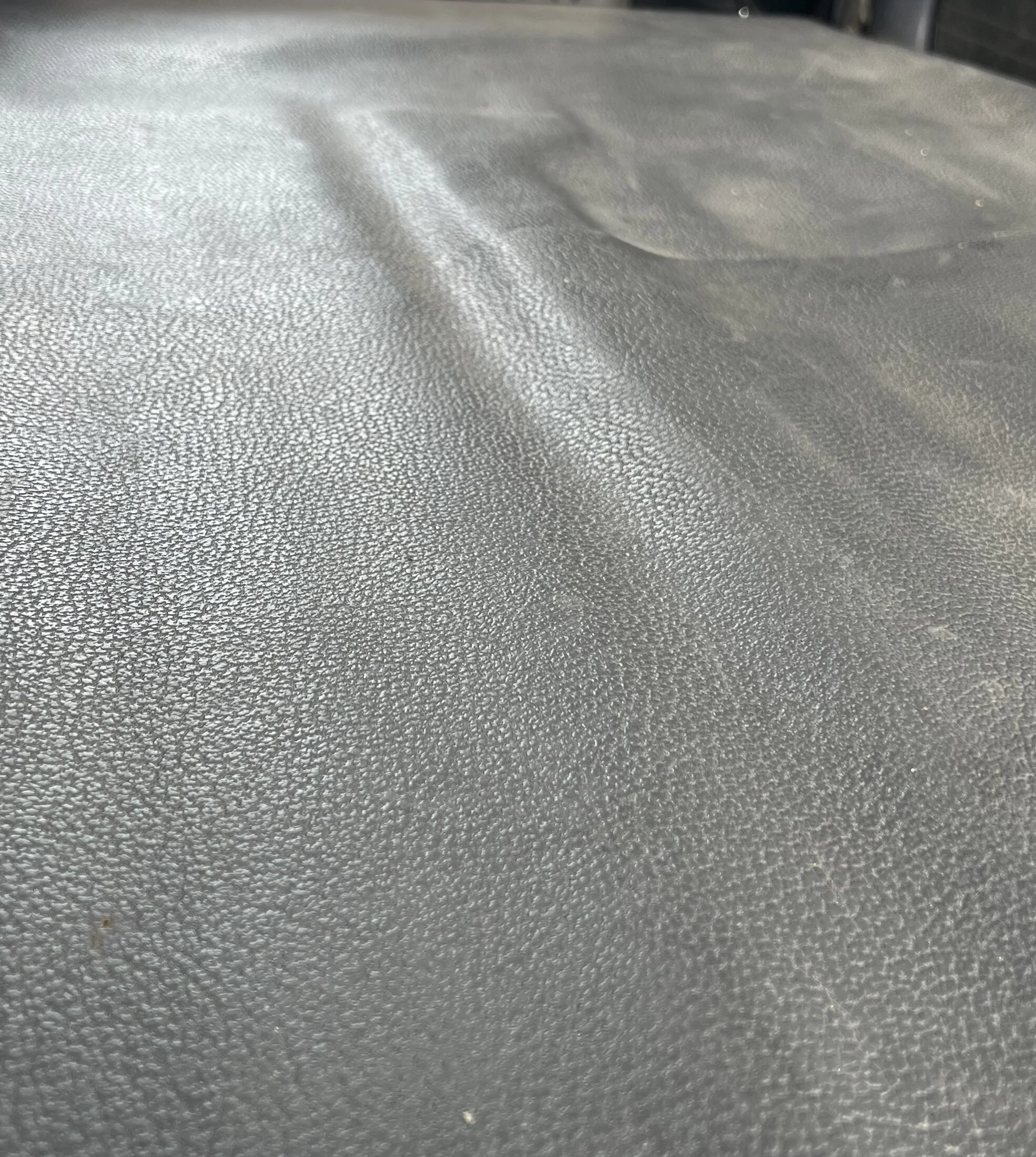

Not sure if this will come through in pictures, but you may be able to see the surface variation. There is one tall rib and the indentation for the seat latch that are most conspicuous. I removed all bolts, studs, and seat mount hardware previously.
Does that taller rib sit proud above the rest?
There are better options, but quick fix sounds like some thin rubber floor matting either side of that rib to pack it out flush.
