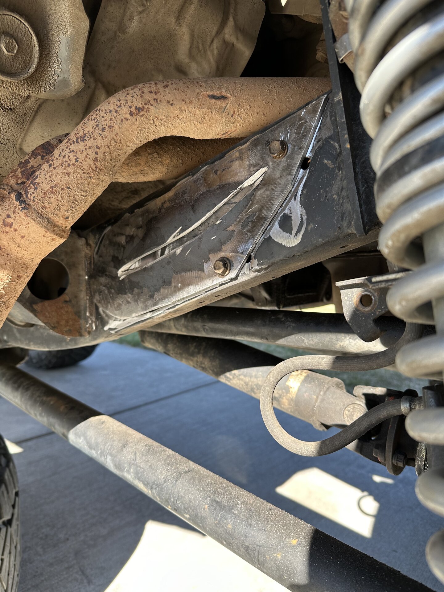

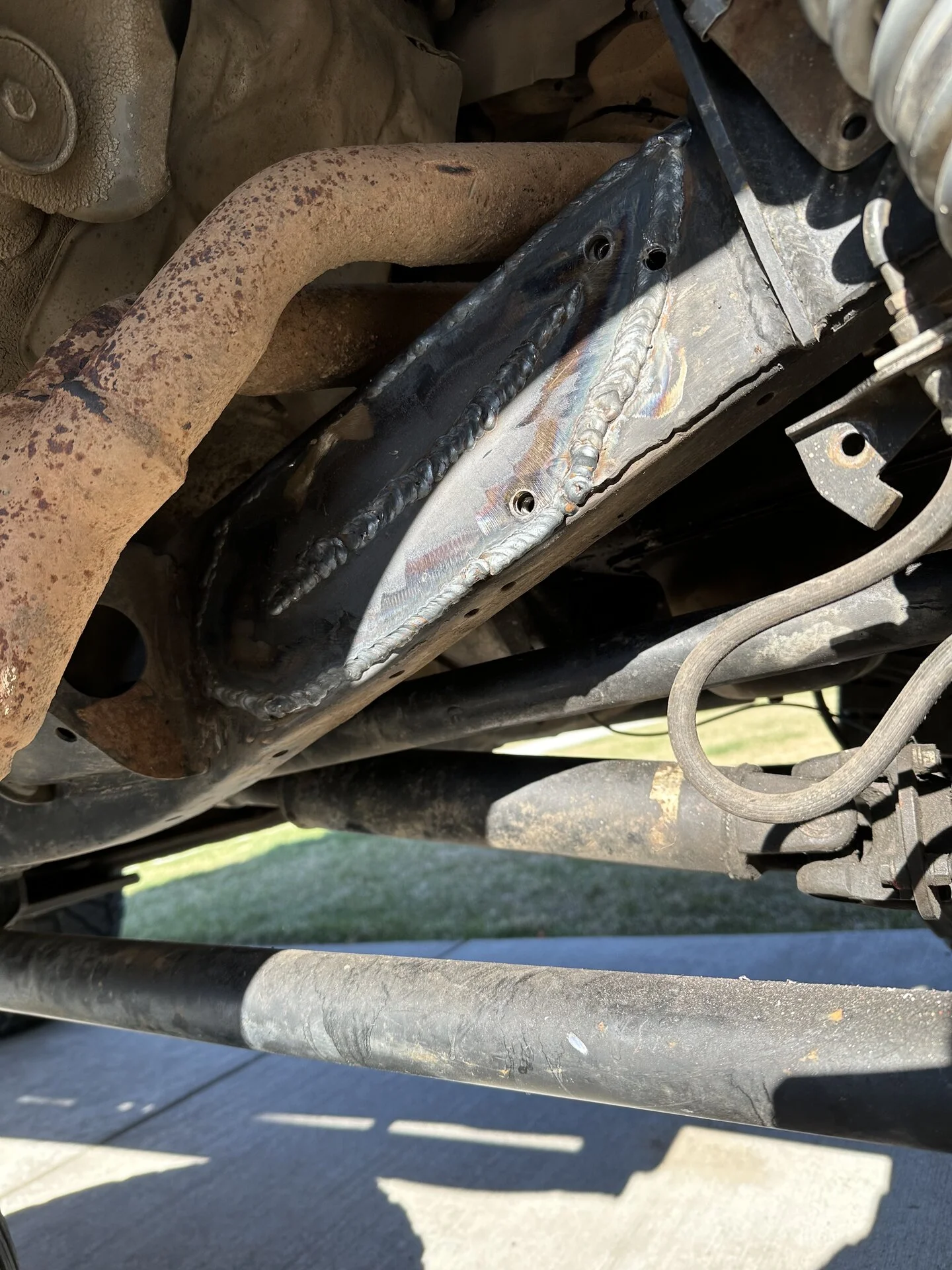

Got the frame plated today, the welds are pretty ugly but I’m past caring at this point😑

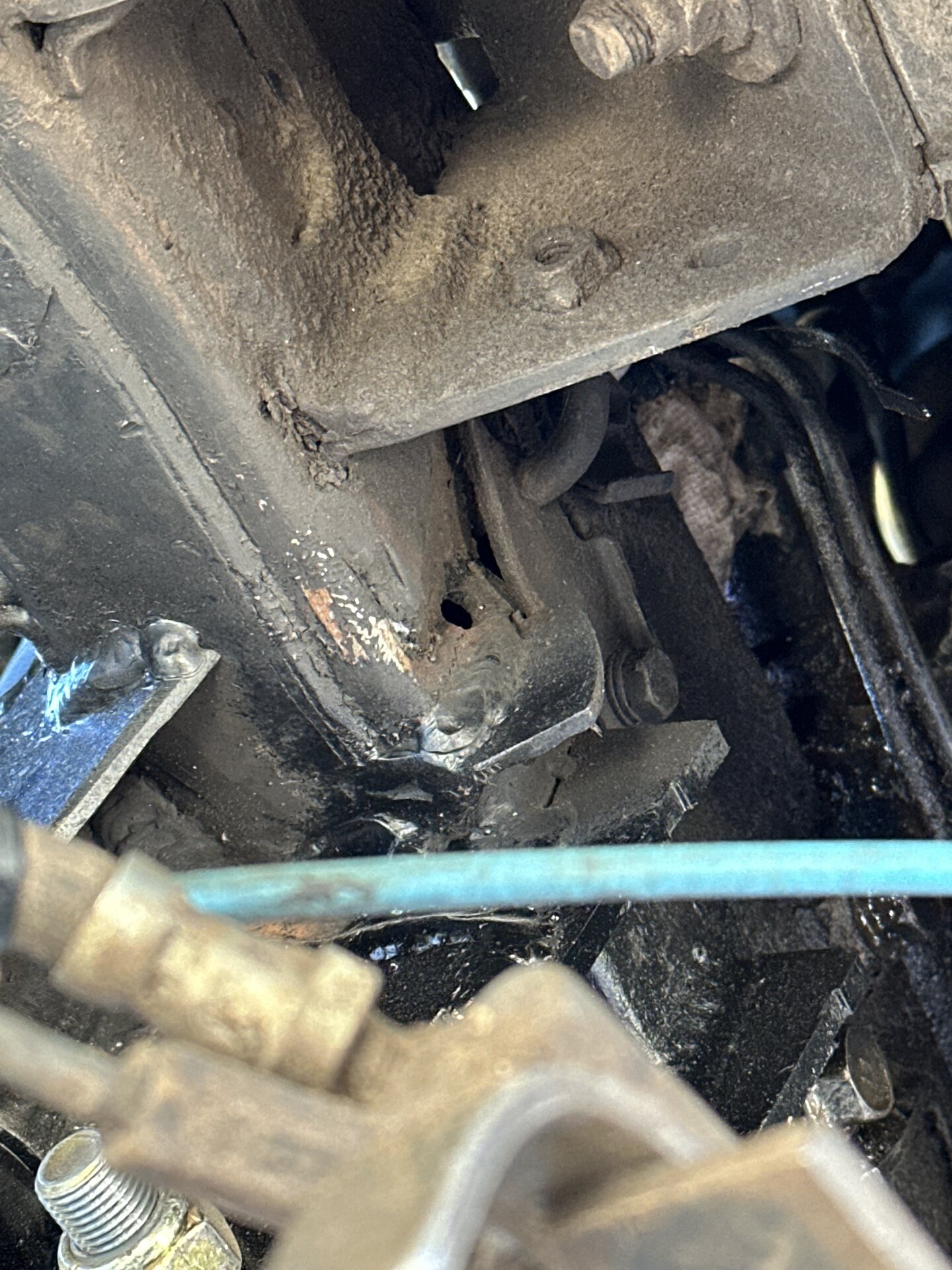

And I found another buckle in the frame that I’m probably not going to worry about

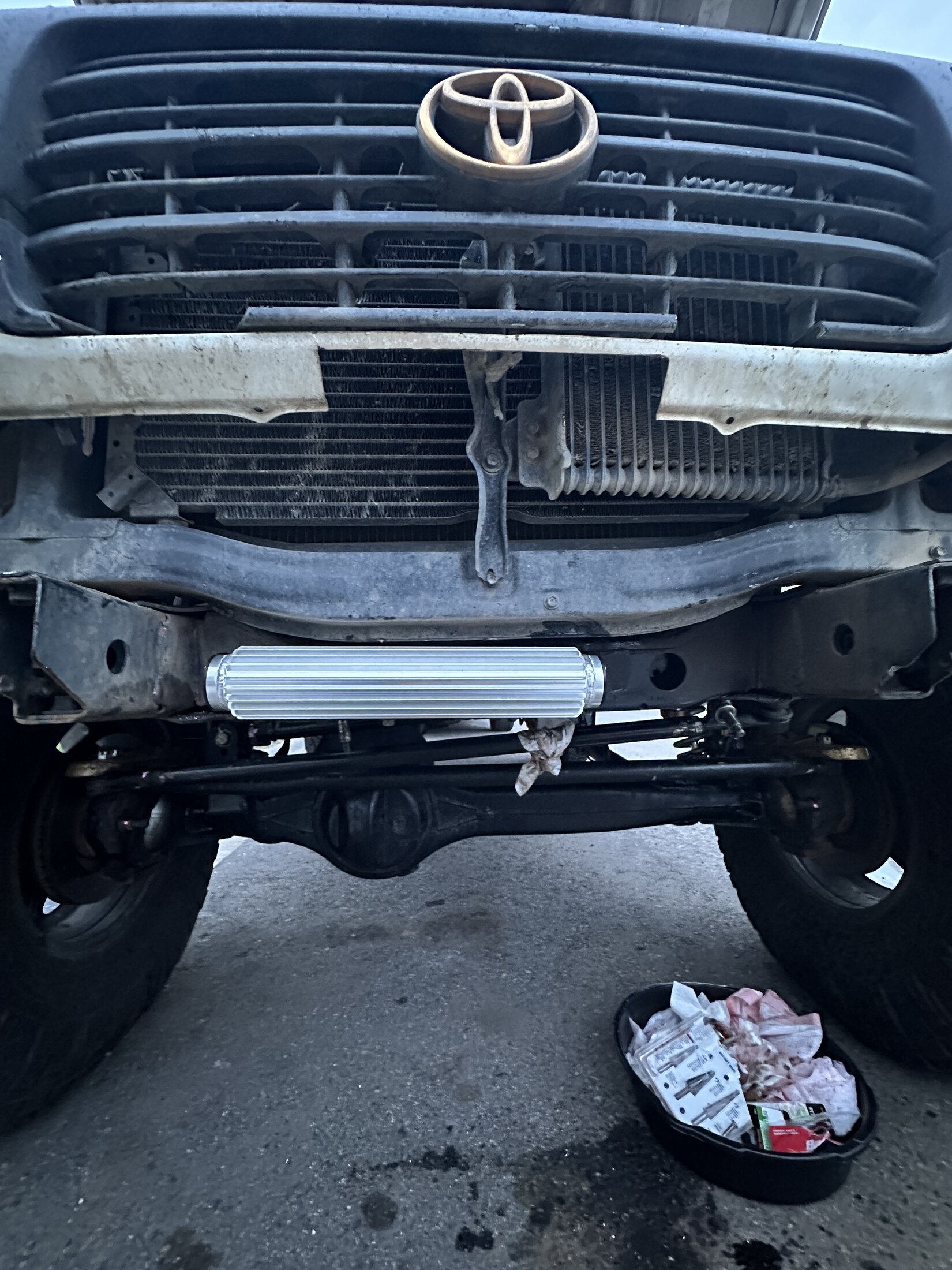

I did something today. I mostly mounted the oil cooler. I can’t tell if the crossmembers crooked if the body is crooked, or if I just mounted it crooked. I also couldn’t get one of the to nuts to seat so it’s mounted with 3. Apart of me cares a lot, but appart of me knows that it’ll get hidden behind the bumper and I’ll never think about it again
Is that for hydro assist?

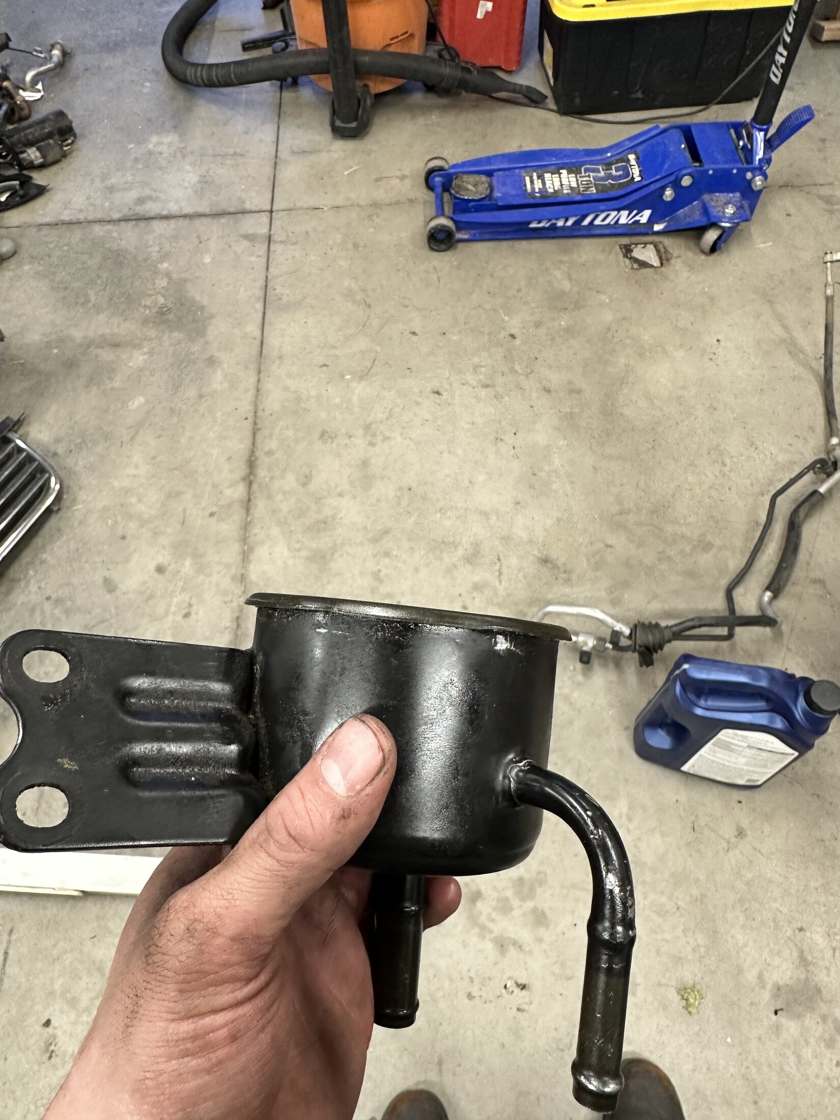

Siiiii, I’m doing this guy and I’m cutting and extending the stock reservoir for more fluid volume
Better reservoir solutions are at your finger tips.
But I’m cheeeaaaapppp and the psc one is so wildly overpriced
What’s not over priced especially with Land Cruisers? With the PSC you get a better and easily replaced filter and a second return port (on the correct p/n) for when you install a hydro booster. Plus, it’s a handsome unit with a lid that actually seals.

I’m going to be chopping the lip off and welding on a 3.5” piece of exhaust pipe to make it deeper. I saw the trick in a pirate post from like 14 year ago or something. It’s fun/ easy/ cheapView attachment 3621776
Others here on mud have done the same with great results 😎 carry on.
