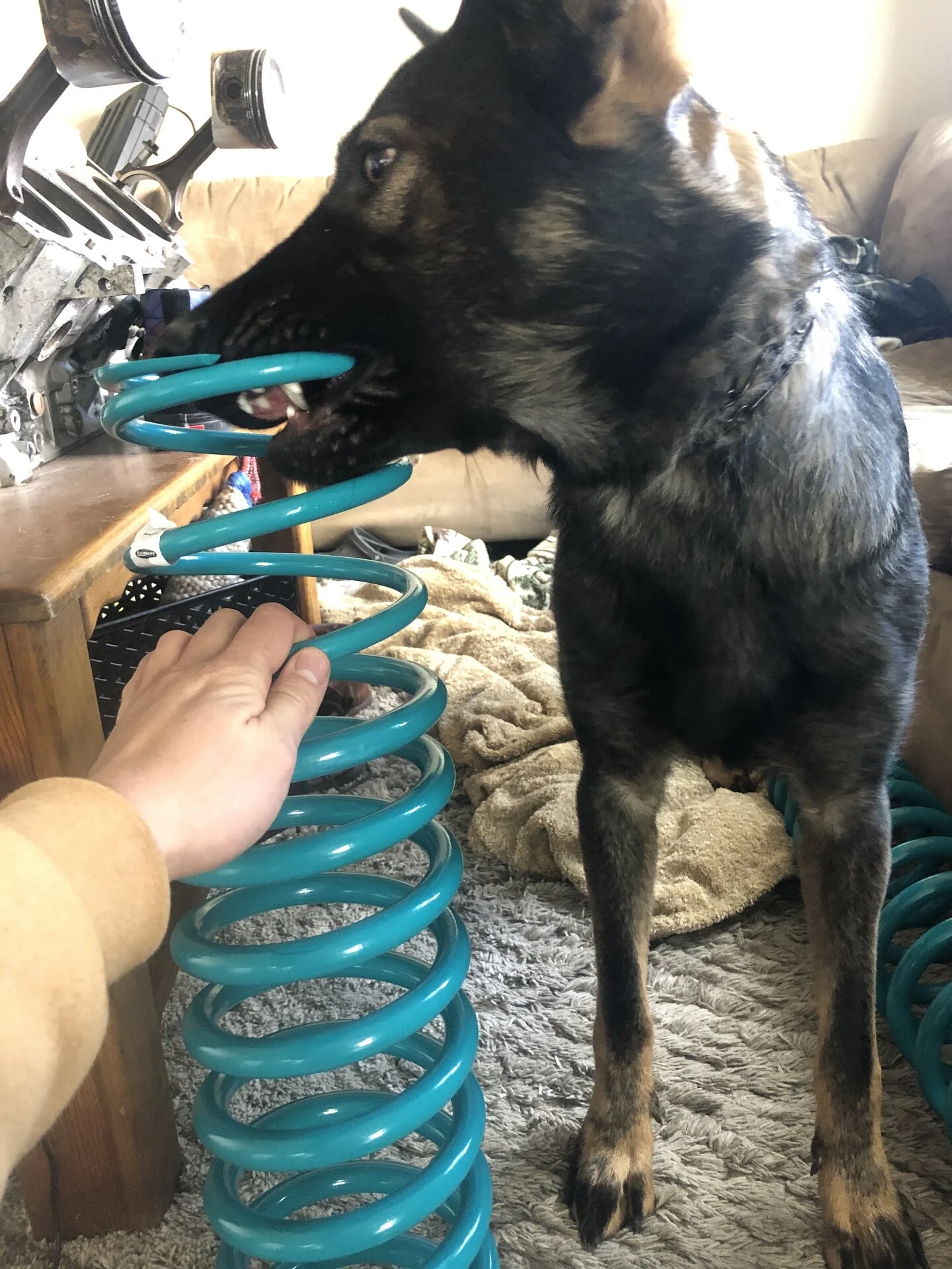

I bought the 80 with J springs and it was somewhere between 4-5" of lift. I think it came with slee plates too, I don't really remember. It was tall and drove super bad, like choppy, super over sprung, not enough caster kinda bad. It didn't flex well so I got a set of first gen dobinsons 2" tapered coils. Dahlia approved.View attachment 3389018

Anyway, the dobinsons springs were kinda stupid, they gave me like 4" of lift, were still over sprung, and sagged a ton, dobinsons warrantied one side but not the other. Whatever, they flexed as much as the 4' shocks would let it.

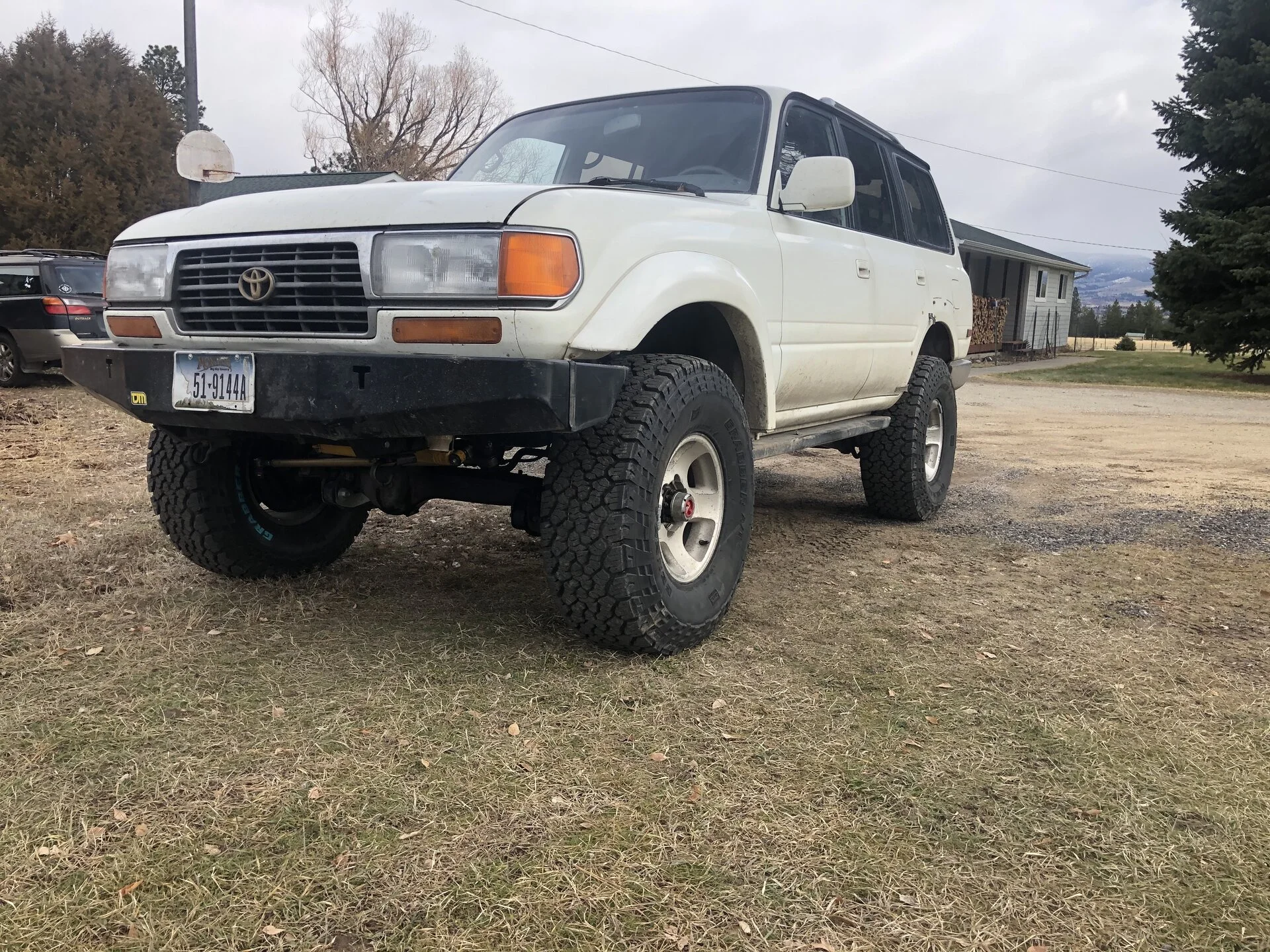

Oh I also cut the rear side wing things off of the body and made the bumper live ontop of the frame. I really dont like the look/ fuctionality of normal recovery points soooo I sandwitched the frame with 1/4" plate and put a 3" piece of DOM through the whole thing. Kinda cool and I think it looks nice and clean with a little frame chop. View attachment 3389021
My rears are a little rotted out and I want to chop them like this, how or what did you do to plug the holes after chopping?
I made a little patch panel and welded it in. It feels scary but it’s a really straight forward process
Light gauge welding isn’t really my thing ( could be with more time ) I’d might make the cuts and have a reputable body shop fab in plugs and weld them in. And rattle can the finished work. Cause when it’s behind a bumper who really cares how good it looks.
What gauge metal did you use and what wire dia. I really need to get some light gauge welding experience but as a full time mechanic I’m stretched thin. Too many projects too little time.
You want 18 gauge sheet metal & 0.24 wire
That’s what I used! I don’t recommend it. My welds did not turn out well
They should have only been spot welds every inch or so then sealed with seam sealer.
Why didn’t you tell me this 3 years ago!!!
I also didn’t tell a lot of things there whipper snapper. Just to put a furrow in the mud fabricator’s forehead, I’ll use quarter inch plate on my current mess, I mean build. Looking forward to seeing the outcome of your efforts gained in building your very own taco truck.
