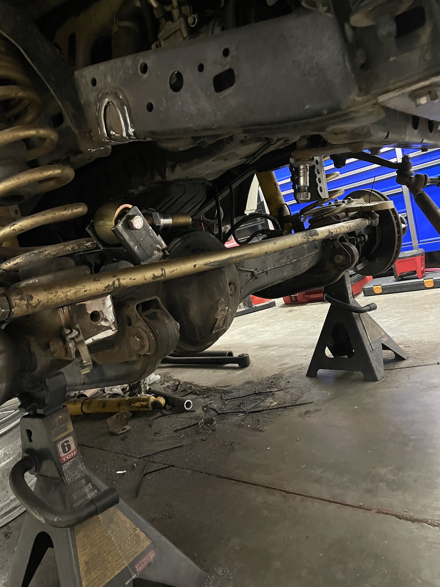

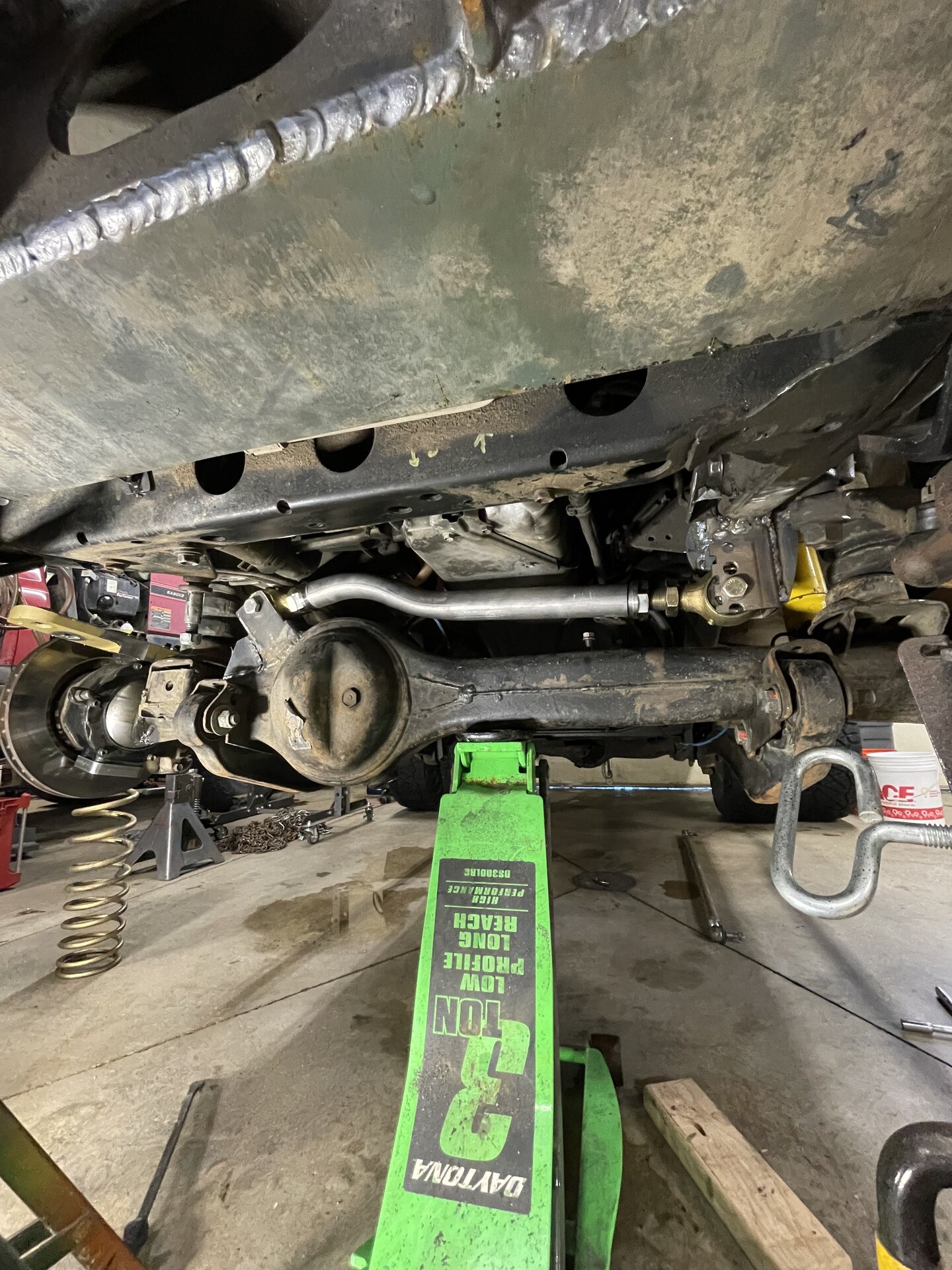

Now that the theories done. I really made a weird panhard....
I wanted 5/8" bolts so I went with a 2 5/8" joint from barnes 4wd... I since learned that johnny joints make a 2" version and its going to be what I go with next time because this giant joint sucked to package. uuuuhhhhh I did a 1.75"x 1/8" tube that sucked to package and put a silly bend in it. This was a very overkill panhard and I think it only measured like 29" long???? It was a little shorty boi, but it worked extremely well.
My biggest gripe with this set up is that it kinda sucks with a low ride height. I ended up adding in a 1" spacer to my spring so I had a total of 3" of lift. This made it so that there was a 4" span between the axle side panhard joint and the frame before it went metal on metal. The dent in my frame says that it went metal on metal alot because I probally didnt space the timbrens down enough. If you have super tight clearances and you want to smash into bumps... dont use timbrens... get air bumps its..... alot easier to tell when those will reach full bump.
I give this set up aaaaaa 6/10. Mostly because the joint crashing into the frame made a really scary sound.

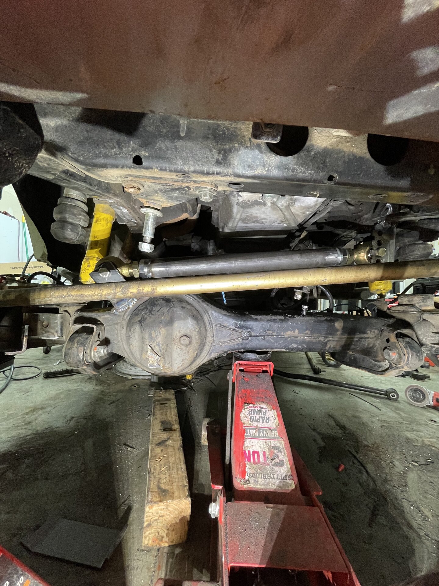

The distance from tie rod end hole to tie rod end hole is more for the front range knuckles than stock so I had to make a new tie rod. For all tube inserts I like to rosette weld them, it's a great way make sure that your bungs won't pull out and kill you or someone else... or at least help with that. Because the wall thickness of the inserts was very very thin and the likelihood of warping the threads is super high, I elected to have @arcworxs root pass them with a tig and I cover passed them with a mig. Seemed like the next best thing?
It touched the diff at full lock so once a little bend had to be put in.
The steering was super annoying. The tapered inserts from marlin are not as thick as the steering arms. This caused the tie rod to kind of sink into the arm. AAAAnd because of this the tie rods would hit the arm at full lock... so I pulled out the grinder and uh... make it all fit. I was really really determined to make cross over steering with tie rods work.

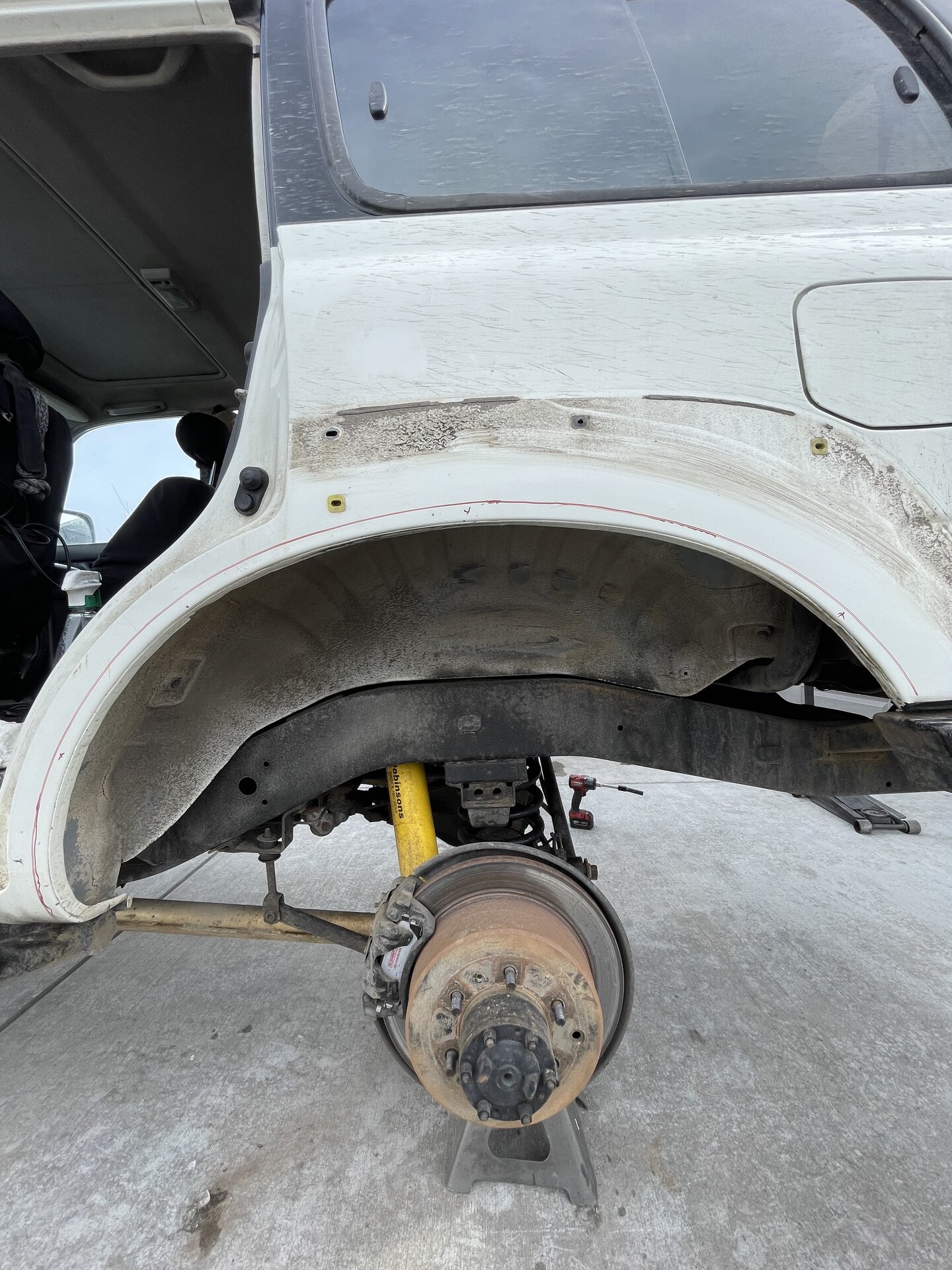

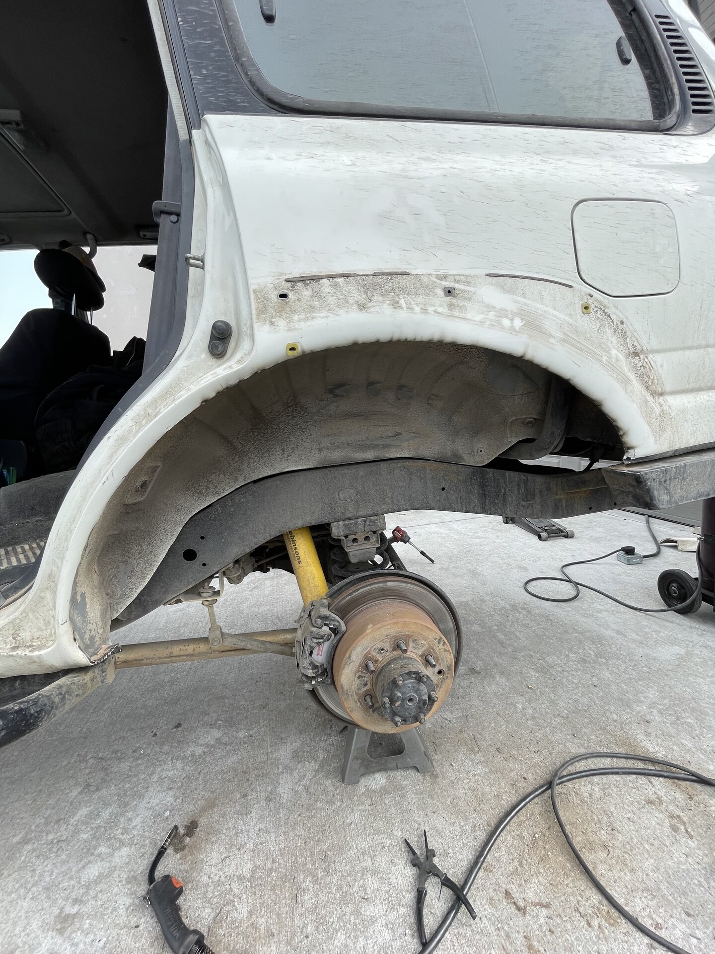

The last thing I did for moab prep was to do a mini tub on the rear. I pretty much cut the lip off and hammered the fender over to get a "nice" roll. I welded it and put a seam sealer for a roof on it. It took like a week to dry but it seems like its working well. Its a pretty nasty way to do it but it was cold outside. Thats my excuse and I'm sticking to it.
I trimmed the bumper too and the tire kinda rubs on both still but lets not worry about that. I have 1.5" of bump stop extension in the rear and I'll probably extend it to run a longer shock anyway:cheers:

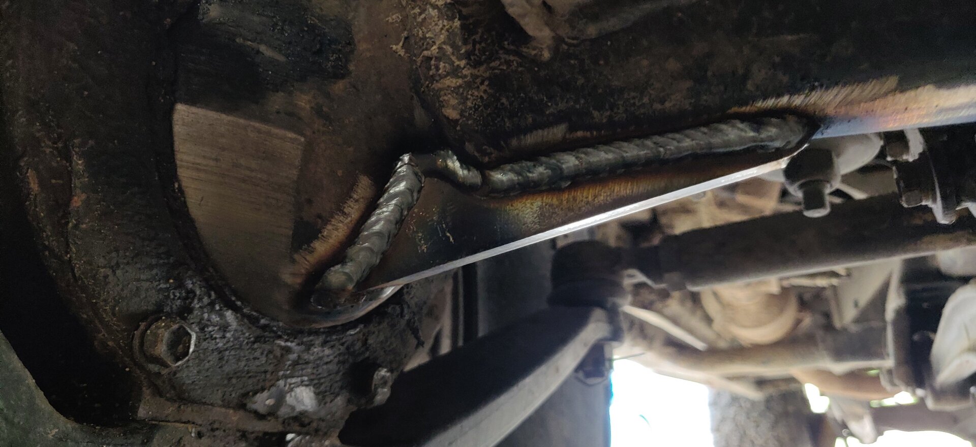

Lastly, I got @arcworx to make knuckle gussets. Pheonix debated on making one for the upper section of the knuckleball but ultimately decided that it wasn't worth it. The gusset would be so short that it would not be effective at dispersing load into the rest of the axle. He's an engineer so I'm inclined to agree. I would highly recommend these, I do not worry about bending the knuckle balls anymore and I'm not easy on my front axle.
You can find these at 80 series knuckle gussets — Contact us - https://www.arcworxs.com/products/p/80-series-knuckle-gussets
