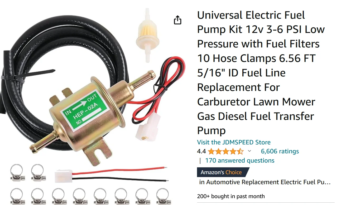

You will get better results when you provide details for what you are after. I now use the like $10 electric fuel pump off e-bay. They last for years. I use them to make transfer pumps to move fuel from 5 gallon cans into tanks.

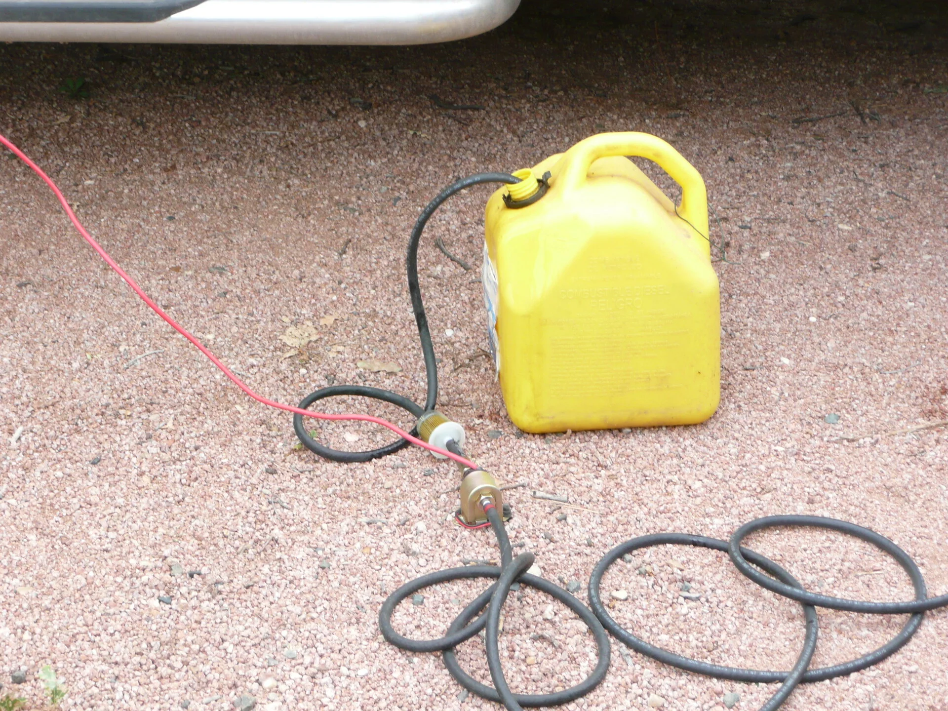

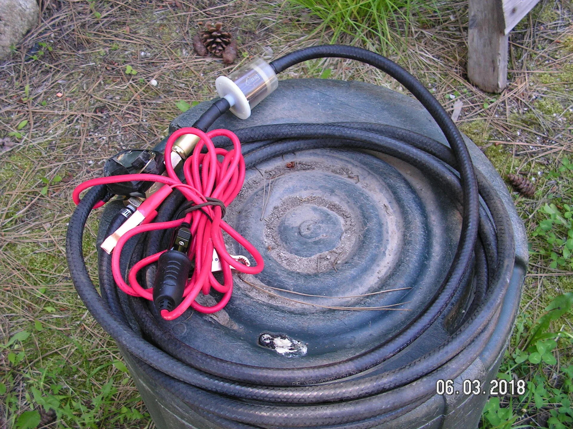

I'm getting old, its hard to hold the new crappy gas cans that are poorly vented up long enough to dump the fuel into the tank. My sis is 10 years older and has even more issues. she also has a an old Dodge Ram diesel. We tested the pump/filter with diesel on her truck - worked like a champ.
$10 electric fuel pump. $20 for 25' roll of gas hose. $3 fuel filter. $12 for 12V 12' extension cord (fused). $5 water proof switch. Battery clamps $5. I cut about a foot off the cord at the female end , stripped back the wire and put on the battery clamps. The cord is wired to the switch and then to the fuel pump. I put 5' of hose on the suction side of the pump with the filter. 20' on the delivery side.
Unit plugs into cig lighter port or into the battery clamp adapter.

i started using a shaker siphon but you need to lift gas above your tank
what is link for your 10$ fuel pump?

Electric fuel pumps are typically geared toward fuel injection applications and thus introduces increased fuel pressure. Not sure how that affects the carburetor and emissions. For states requiring smog checks I'd certainly be cautious.
I was only intending to use it for fuel transfer. I am partial to mechanical pumps.
