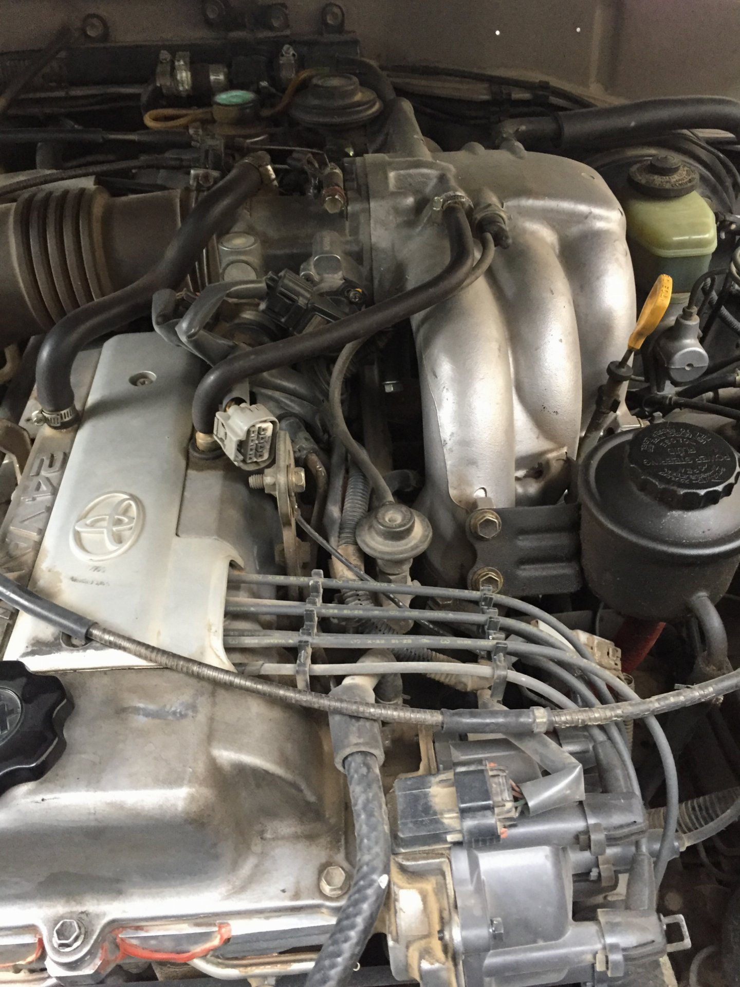

Considering that is a pic of my trucks engine you used, yes it has been fine , toss all that stuff
Yessir! We spoke about it via PM. I was just trying to get a larger sample size. Thanks for your help!

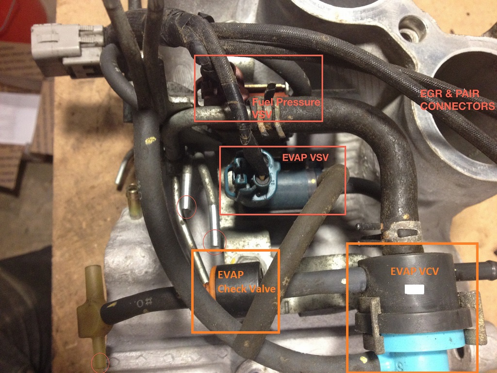

@slow95z & @Will Van :
By "every one of the switches" do you literally mean EVERYTHING that's running on vacuum?
Did y'all remove every VSV, every check valve, & every single vacuum line?
Basically everything pointed out and bolded on page EG-172 in the FSM?
