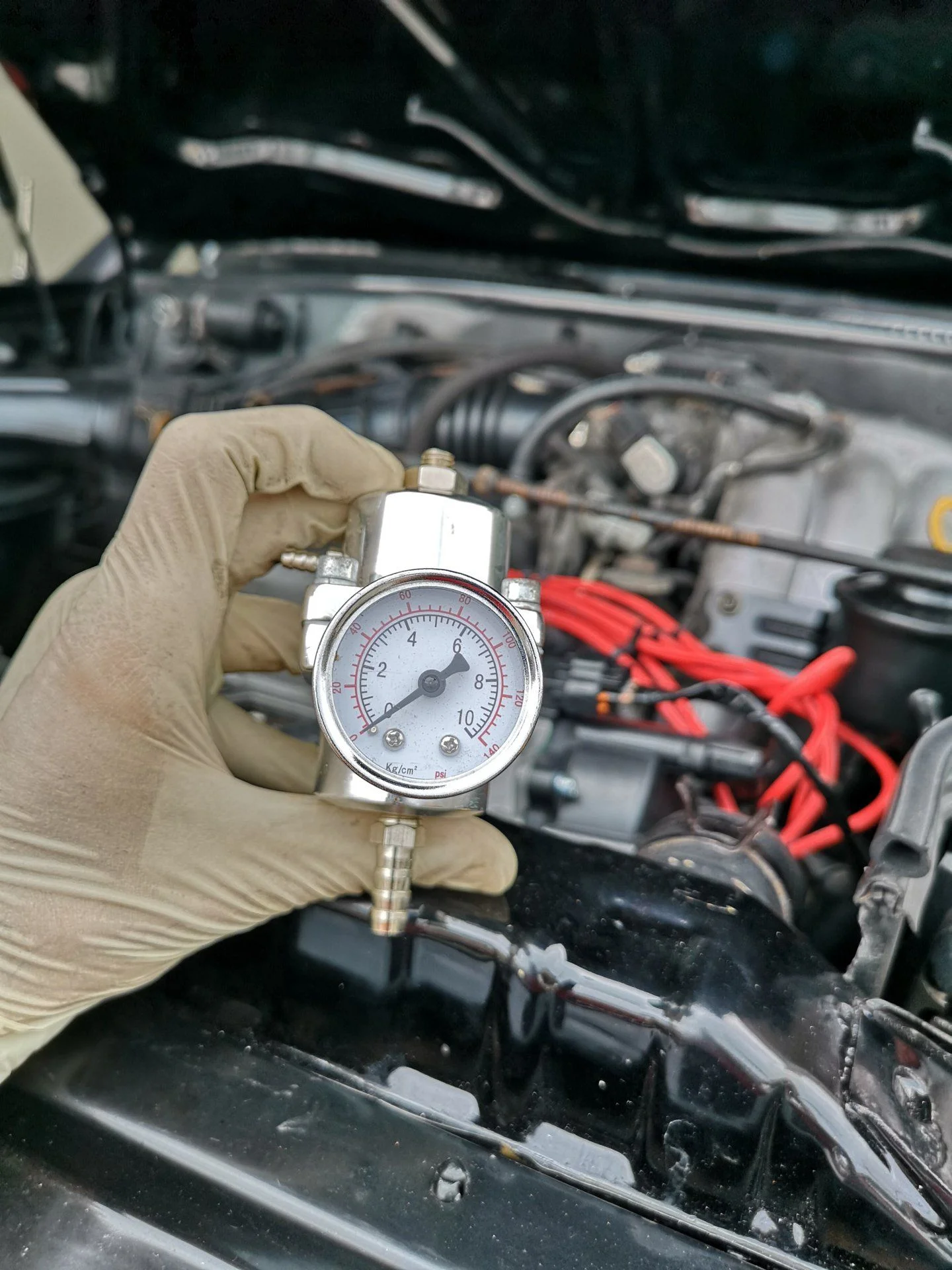

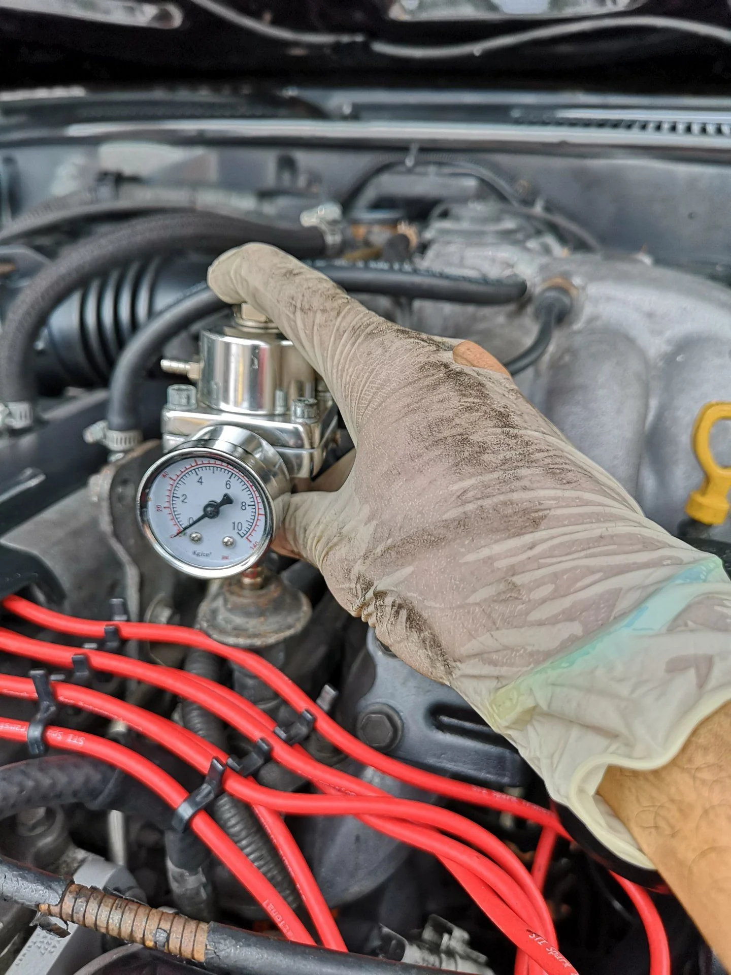

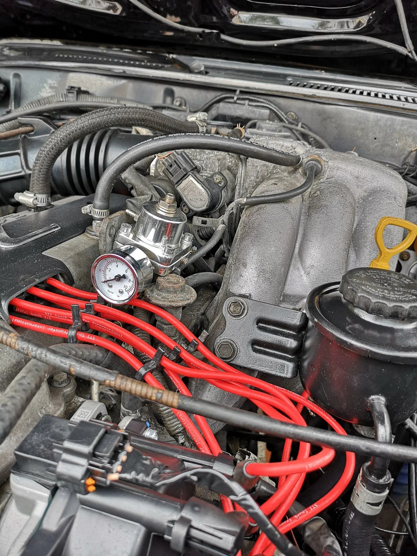

Hi bros!, I want to put this Gauge inside the motor, have anybody done this before? I'm thinking it goes over here...
Any tips or ideas?

That looks to be a pressure regulator with a mounted gauge. make sure that you are not limiting the fuel pressure under the recommended pressure
Agreed with NCFJ that looks like a fuel pressure regulator with a gauge attached. You could add a mechanical gauge to the existing system. It would just let you know that the base fuel pressure was right at idle. Or you could add a sender and gauge in the cab so you could make sure you’re getting enough fuel when it’s actually important and that’s under load.
