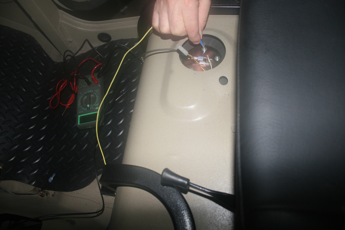

We are also getting power at the sending unit from the gauge cluster.... yet the gas guage is not moving, and I have about a 1/2 tank of gas in there

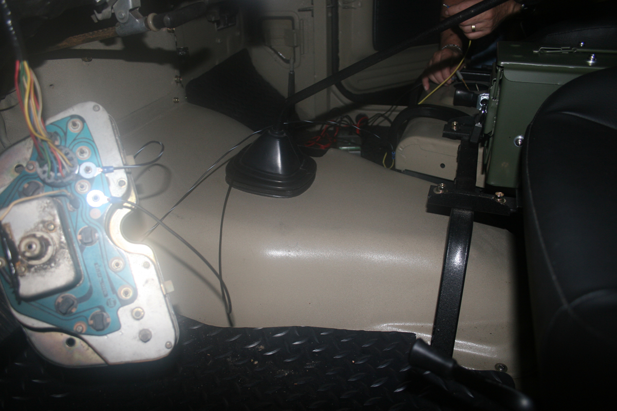

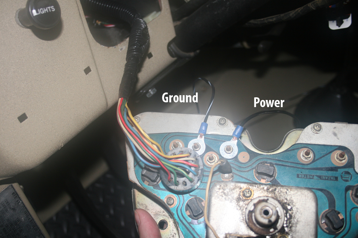

It would appear that the yellow red wire coming out of the round plug is not completing the current to the tank, so that wire must have gotten soldered wrong or something, so I created a jumper wire that is connected on the back of the gauge cluster to the fuel power post and then connected to the sending unit, that is where we showed the sender getting power. We then grounded the sender to one of the seat bracket bolts. So I guess I either have my ground messed up or the gauge is actually broken.
Okay, we finally got it.... man this electronic stuff is hard to figure out, although hindsight, I probably should have wired this thing myself instead of having a neighbor do it, that way i would have been a little more familiar with it.
Anyways, here's what we had to do in order to get it to work. I created 2 jumper wires that connect to the rear of the gauge cluster, the power to the fuel sender being on the passenger side of the fuel gauge (if sitting in the seat looking at the front of the gauge cluster) and the ground being on the drivers side. We then connected the power to the tab connector and touched the ground to one of the sender screws and it worked!

A BIG THANKS to spangly and lostmarbles, thanks for sharing that pdf, and the pics of the gauge cluster
