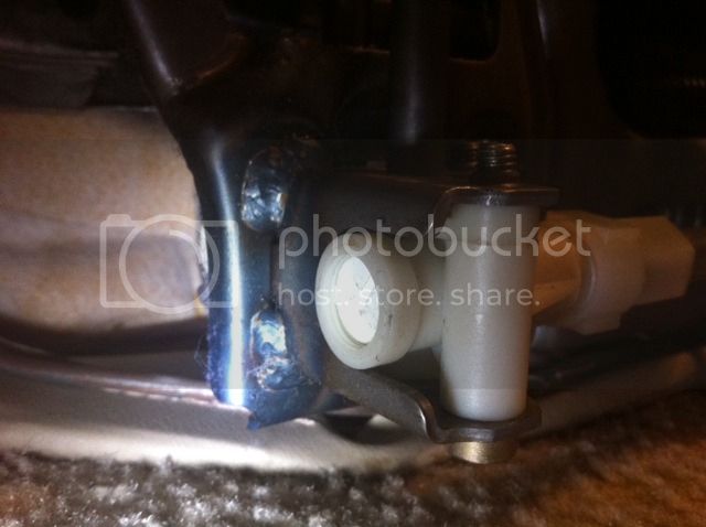

Any advice on how far to screw in the white end cap? I've seen pictures where the cap is flush with the gear housing... however mine can be screwed in much deeper.
Does it have anything to do with the "drive shaft" that connects the left and right side of the seat ?
What exactly does the end cap do ?
The end cap keeps the worm gear in alignment with the seat gear. I turned mine until it was snug and then gave it a 1/4 turn or so and used blue loctite. I also removed the complete motor assembly and pulled the gear housing from the shaft/motor so I could check the gear tension when I installed the cap. Mine was not flush either.
I know some have had a problem with the seat binding by cranking the white cap in too far, so if anyone else chooses to glue it please test your seat first to make sure it's working ok.
I thought the binding would be caused by the mis-alignment of the seat rails.
I don't understand the purpose of the white cap, or how it would cause binding...
having the cap in too far would create more load on the shaft than is necessary, which is synonymous with binding. You need it far enough in to hold the shaft on center so that the worm gear can freely turn it, but too tight and it creates more stress on the system, which can in turn strip your plastic gear. :beer:

Works great, takes a little more than an hour, would like to note that the front of the seat needs to be tilted back to it's highest point to make the cover removal and gear disassembly much easier.
I had top my PS back in and hook back up to make this adjustment, probably mentioned earlier I likely overlooked that advice.
Nice job with the repair parts, thanks!
Seat controls are reversed
Got the gears installed and the end caps. Worked great till I find out the slide back and forth controls are functioning in reverse. Any ideas what I screwed up?
Hour on the first side, :beer:less intense hour on the last one. Note that if you can, put the seat in topped out vertical beforehand, makes it possible to remove the plastic trim piece on the seat front. :beer: And if the seat was crooked before you took it out, it could be when you put it back in. Surefire way to get shaft alignment right is to count threads, :beer:(hill, dale, both if you like) can't go wrong. :banana: Great to have the gears, maybe take a look at a thermoplastic solution to wobbblly mirrors? I think the demand is out here. :cheers:
If the seat moves in the opposite direction, you need to take the gear assembly and turn it around, so that now the new cap is on the tunnel side of the seat, not the door side. That's how the PS side was before you took it apart. OR, it should be mild entertainment each time someone moves the seat, maybe leave it that way for a while.
