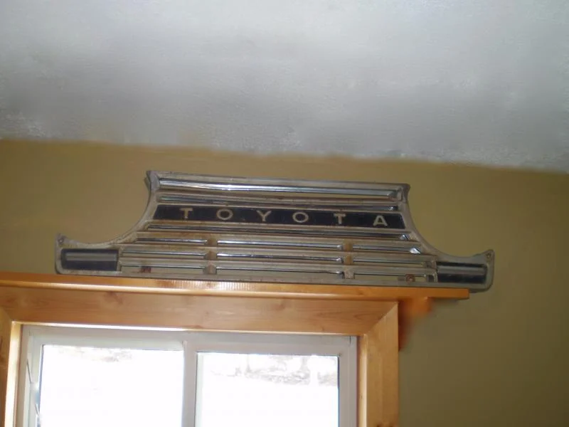

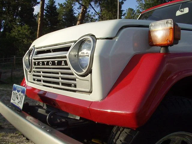

I sandblasted mine and used the Rustoleum Hammer Pewter color. A year later it's holding up very well and that's sitting outside in the AZ sun. I tried to paint the letters white after the silver but it turned out s***ty so I just went all silver.
from this
To this
I did the headlamp rings and bumpers also.

I found that if you paint the pewter first and then come back and tape over it and cut the letters you can then paint the black.
