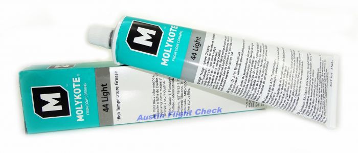

I love my e-hubs. No I did not replace the torx screws, but I would have if I had some. I think the biggest unique thing people will need are new e-hub brushes and some special electrical slip ring grease to go in there. Now if you can find those you'll have a winning kit. I had to make my own new e-hub brushes and used "Dow Corning Molykote 44 Light" grease in the e-hubs. 4 years and counting they still work great. I used regular bearing grease in the wheel bearings of course.

Hi, did you putt new grese on the brushes?
Yes, I put grease on the brushes, slip rings and motor gears. I did this to reduce the rate of wear. Seems to be working very well. This is the stuff:
