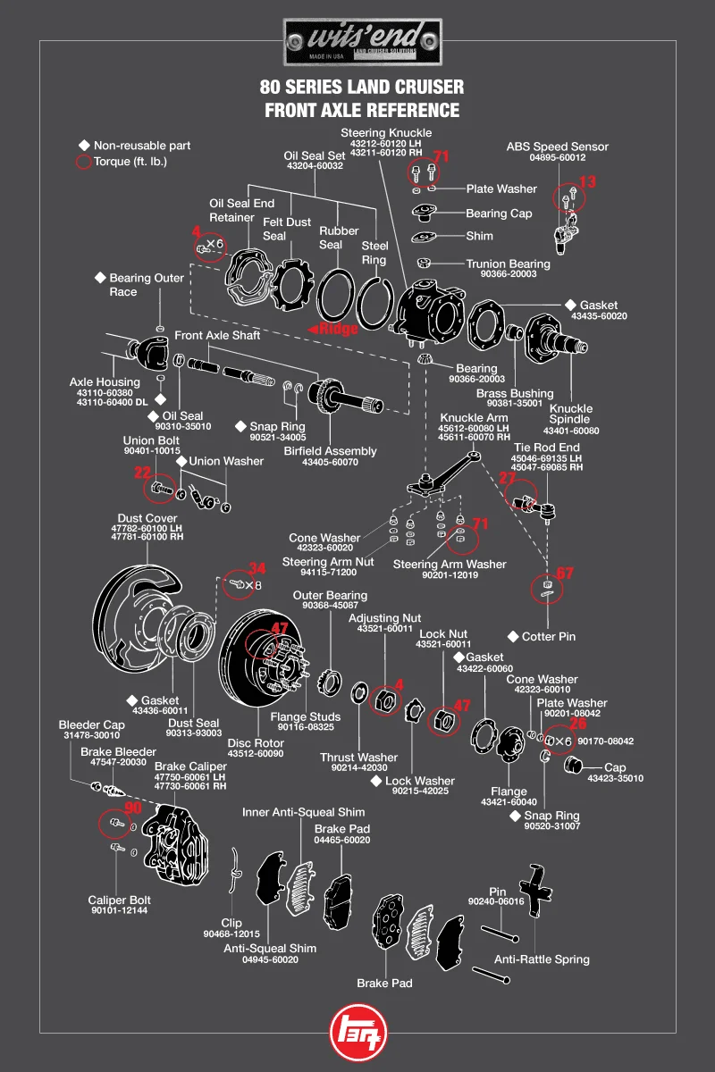

Front Axle Cheatsheet

Besides the ABS sensor not being present on my rig, is there any reason I should NOT also leverage these cheaters for my '92??
Your rear axle is semi-float I believe but the procedures and torque values should be similar. The lug nut torque does change from the 93/94 to post 94 and that is very critical. We're talking 100+ ft-lb to 76 ft-lb. I'm not sure if the 91/92 lug nut torque values are the same as 93/94 though.
This will definitely help for our burf rebuild this weekend. Thanks for the cheat sheet.
I found this cheat sheet very handy during my knuckle rebuild last weekend, even though I had all the torque specs in my step-by-step directions (see attached). Thanks for the hard work!

Great cheat sheet. I have had this printed out in the shop since you made it. Used it last weekend. So much faster. I'm getting close to having all the tourqes mesmerized (spelling) Thanks!!!
I put the FSM preload procedure on it. I figure if someone wants to do their own variations, they can. Don't want to add too much to the sheet or it will become unwieldy. Thanks.
OK, I had two meetings cancelled on me so I got stuck with nothing to do. So I recreated your hard work and started making it in 100% vector so that I can scale to any size. I might actually make some posters of it. Dunno. I just wanted something a little different in my work area.
Still need to fill in a bunch of part numbers. The Steering Knuckle cone washers were missing in the FSM so I added those and add the brake pads.

Uber nice. If I right click/save as, will I get high quality art that I can make into a poster? Or is that something you want someone even doing with your work?

OK I found a bunch of missing numbers and added those as well. I also included a few more components that weren't on the original FSM page.
I am currently looking into making posters that are 18" x 27" laminated. Probably only 100.
It would be cool if @beno took a look to check my handy work to make sure I don't have any glaring errors in here :P
