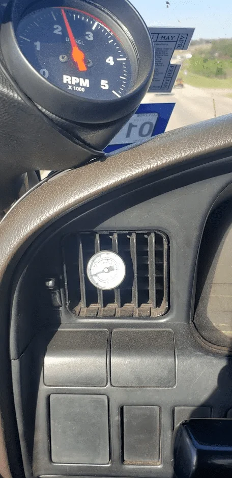

Finally was able to button everything up and got the truck back on the road. I did have couple of leaks that I found with some soapy water. I also had an issue with the quick disconnect fitting used on the boost gauge. It was leaking and the truck wasn't able to go past 10psi. After fixing all of that, I am now able to boost to 18-20 psi rather easily.

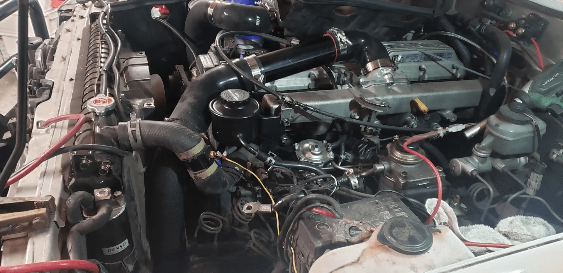

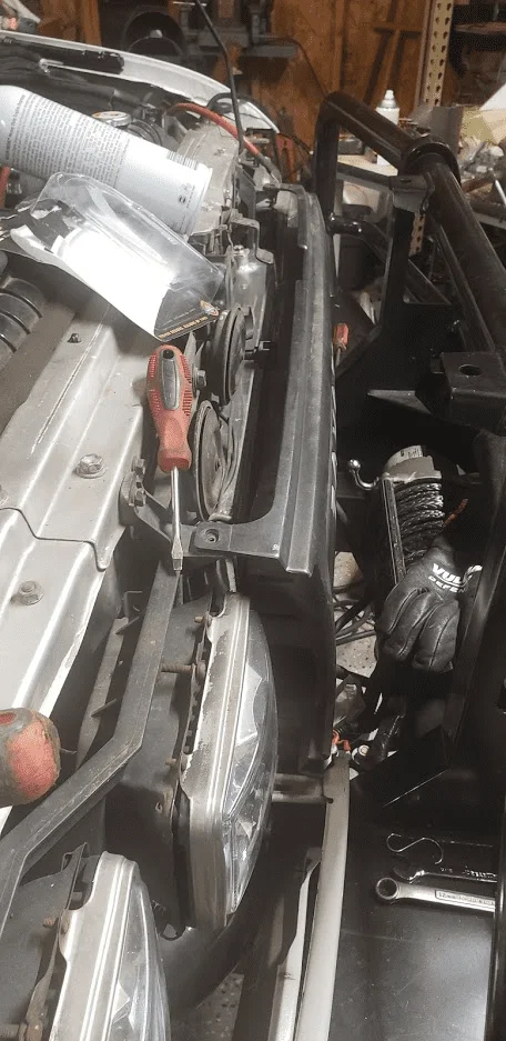

Pic of the IC piping.
I was very surprised that I only had to hack off the lower mounting leg on the grill. I was worried that I had to clearance out the plastic on the backside of the grill, but that wasn't the case.

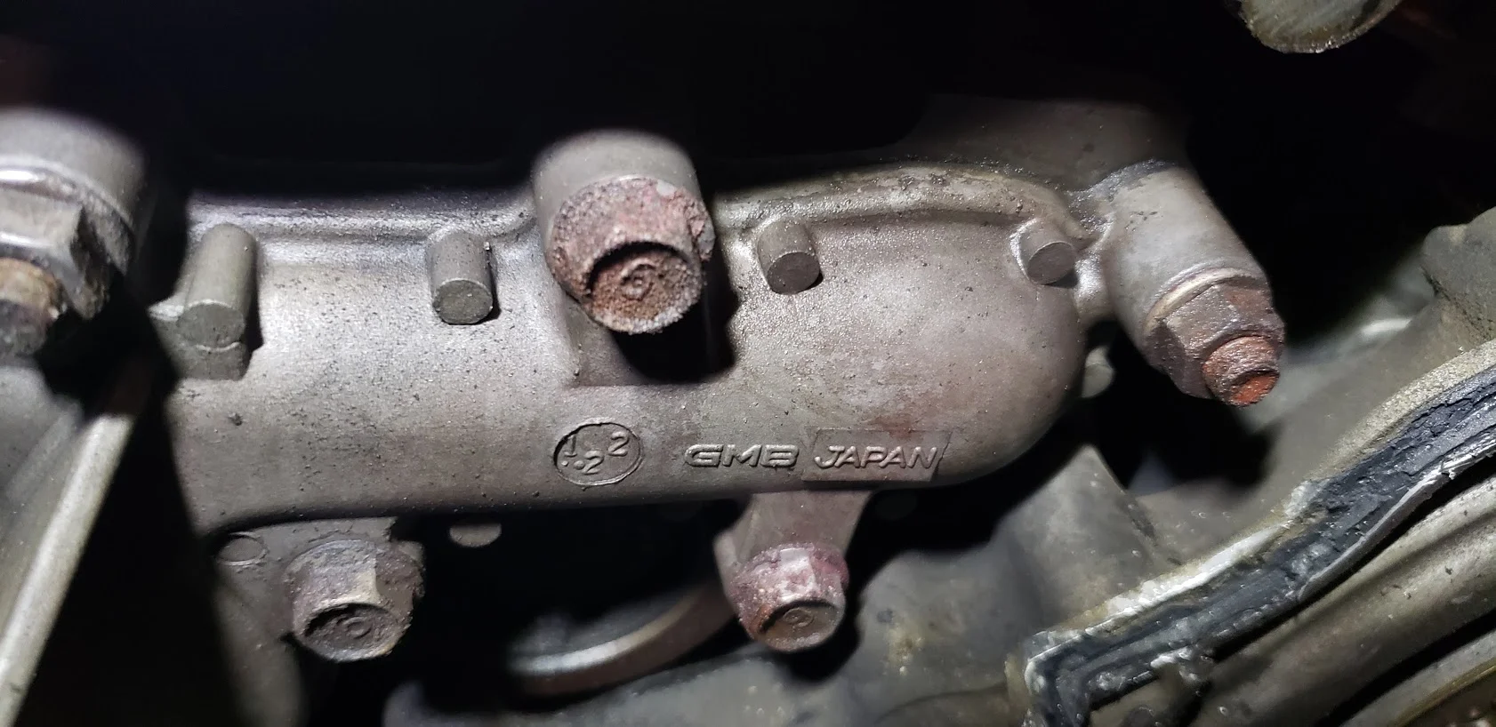

I noticed that the water pump that was in it was a GMB from Japan. These are the cheapest alternatives that Partsouq sells. When I was ordering parts, I was tempted to go cheap. Glad I didn't because this one failed early (about 40k kilometers since the timing belt/pump were done by the original PO).

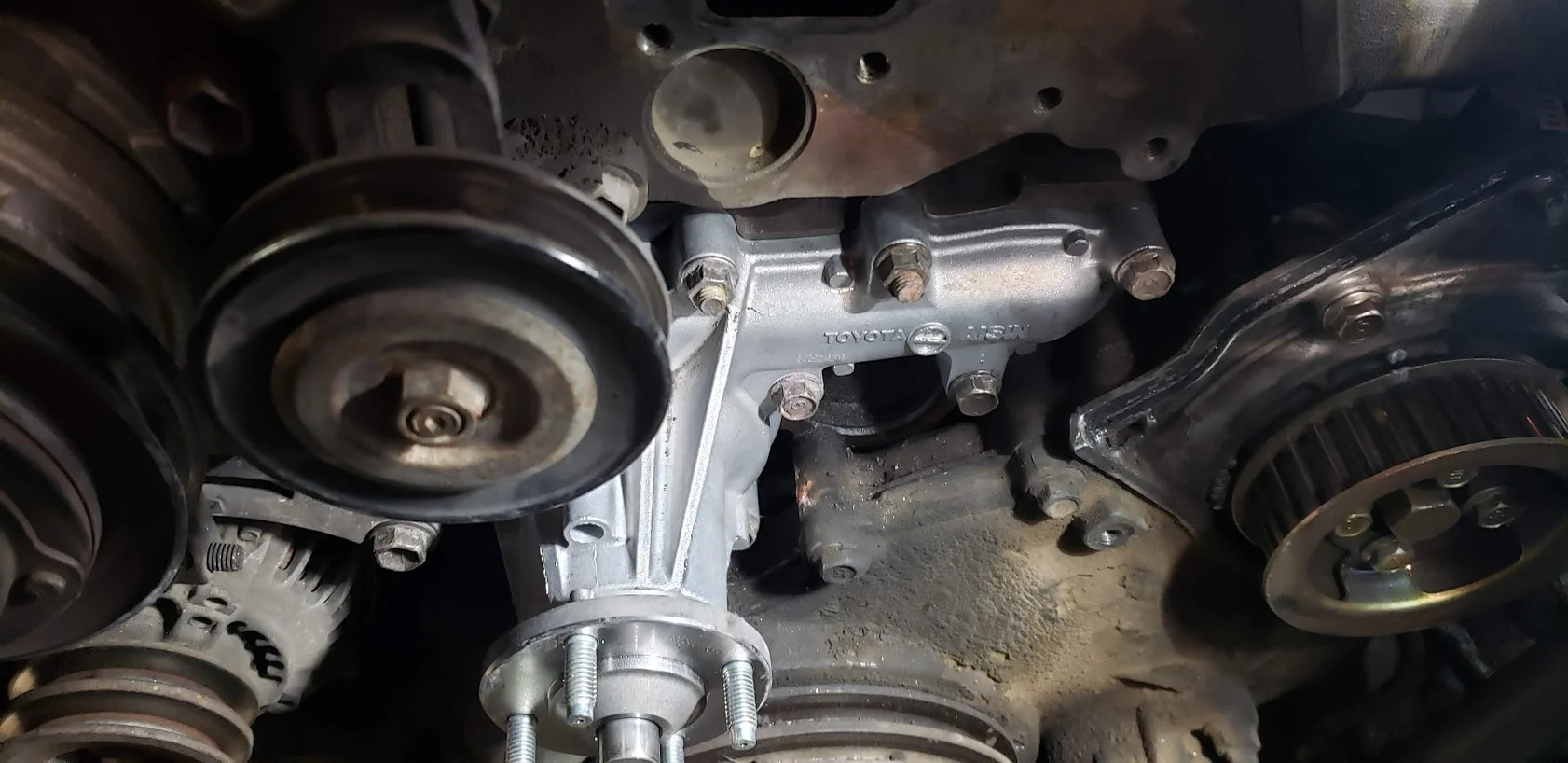

This is how it looks without the cam gear and the tensioner.
Pic of the dong-shaped GMB water pump. It is interesting to see that this pump has a metal impeller compared to the Toyota, which uses a plastic one.
