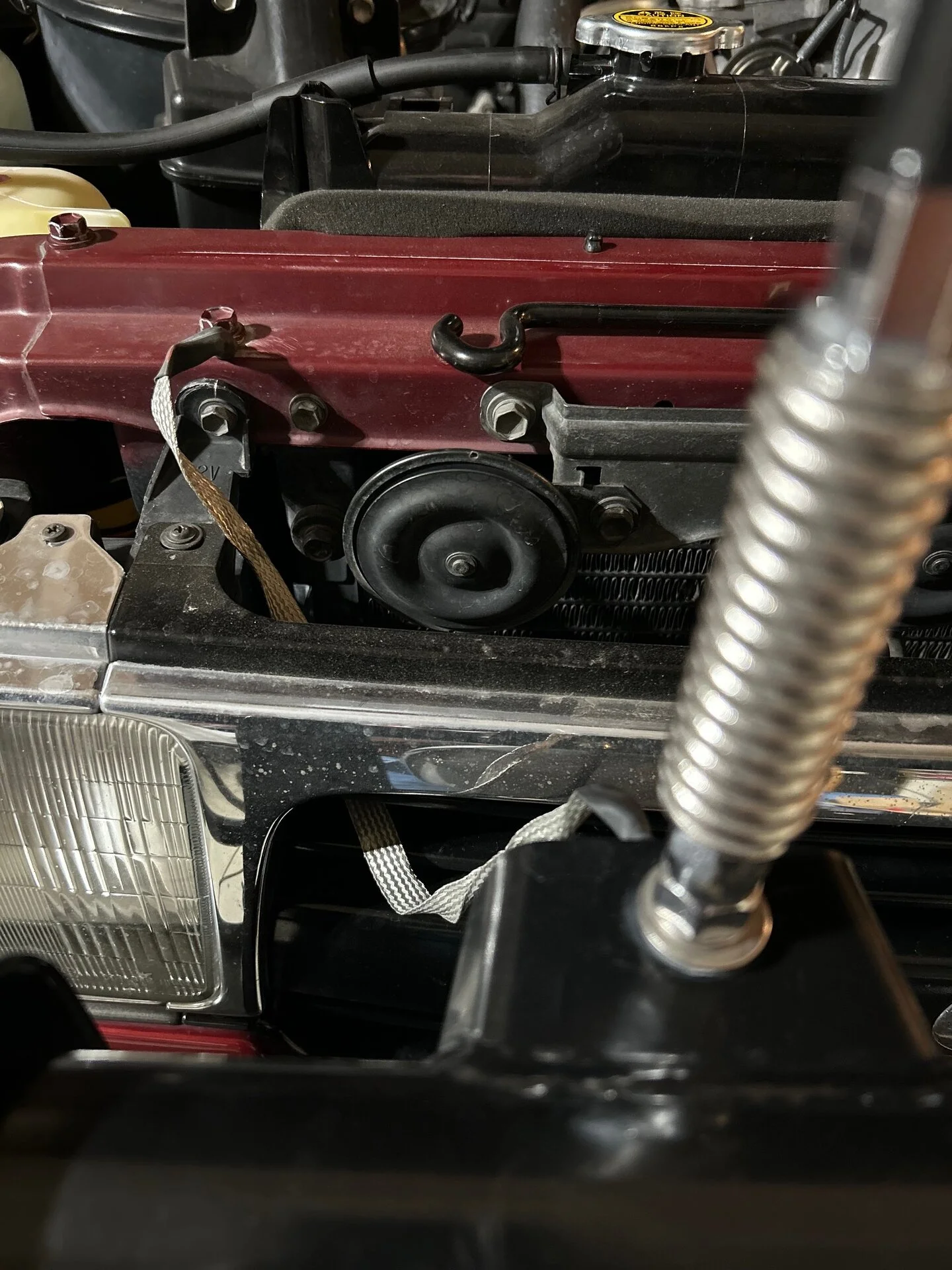

A Firestik antenna was installed and tuned at the front left corner of the ARB. This position worked well on 80 and tuned to around 1.2 SWR on 19, 1.5 on 1 and 1.7 on 40.

I ran some ground strap from antenna ground above powerdercoat to my frame. Had to re-tune, sharper resonance, but performs WAY better with the improved ground plane. Your truck looks great.
Thanks. Good tip on the ground strap.
