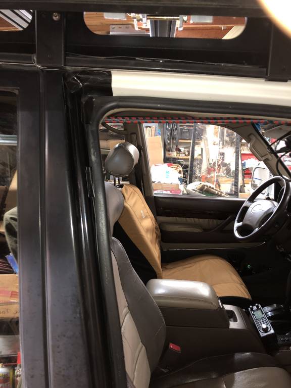

Then I got to a point where I realized I can't see up there (I'm 6'2") so neither can anyone else, so it became good e'nuf.

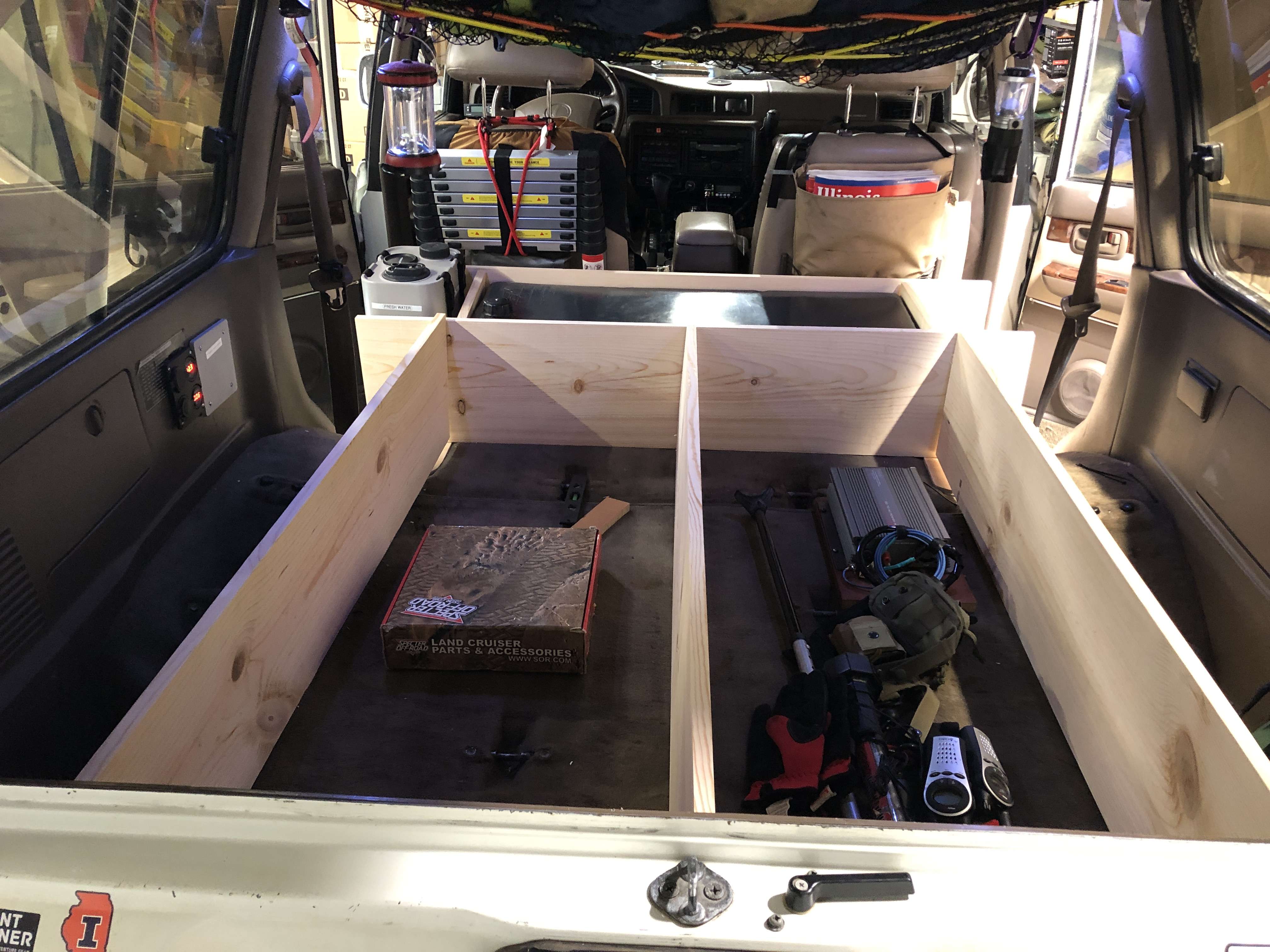

I rested part of the day due to recent surgery, then got restless and went at the lumber I bought before going under the knife, urr, laser. Anyway. Here's some of where I got design wise in the cabinetry. These are nominal 1x12, picked over Select boards that cost well under $100 for the 5 x 8' I bought. Tie downs coming soon as appropriate. BTW, these are the unripped boards, They will be cut a bit shorter by final design, in such a way as to come out level with the top; of the water tank. I plan on using maple or some other high quality plywood for the top deck.
Left side rear holds a fridge slide, the right side rear a big drawer, forward lf that will be two large compatments and a number of cubby holdes

Here I'm finishing up the drawer/sleeper so mostly about woodworking.
The threshold at the bottom of the rear tailgate offers a way to tightly squeeze in a piece of oak top pull things together.

This shows the water tank tie downs that also stabilize the whole drawer/sleeper frame work. And it's tested, as this is an improved version of the same basic design in the "test truck" you can see in the pic on page one...
Here's the underframe showing the framing for the lift panels added along both sides. The rear steel bar tie-down is also obvious in this pic.
Here the top panels are roughed in. The rear most one on the left covers the opening that will be left when the fridge is slid out over the tailgate. When the fridge is in, it is fastened to the deck top otherwise.
The next pic show it bolted down next to the fridge slide, as well as carpet making this area less harsh to slide around on.
This is also a handy area to sit and dress in given the limited overhead space in the truck. One negative note is that I glued the carpet down when it was a little on the cold side of recommended install use for the carpet glued.
Here we see the fridge slid out, along with the extended kitchen counter/cutting board that slides underneath the fridge slide.
Here all is tucked in for travel.
