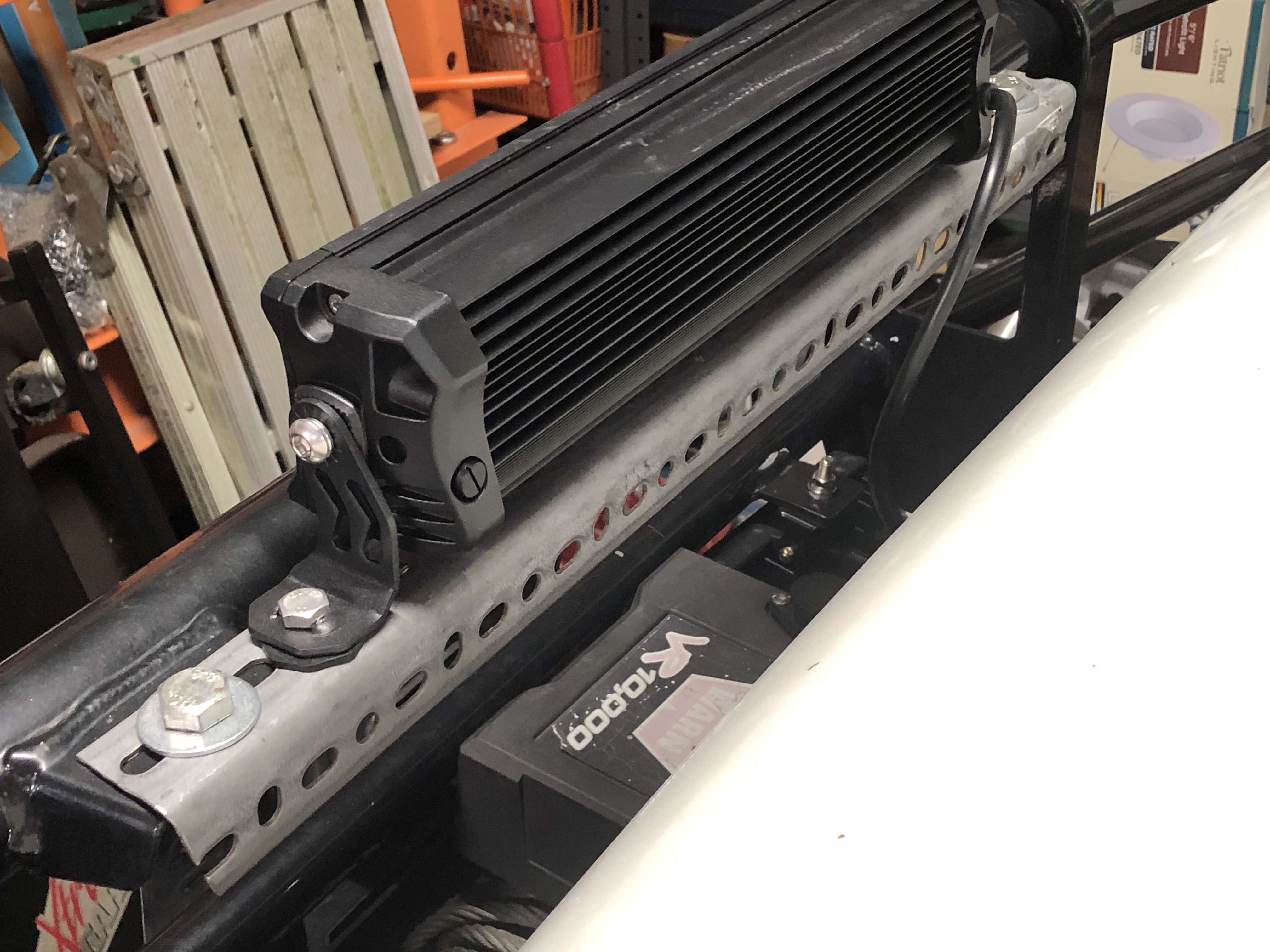

Up front, I added some more lighting with one of the new Harbor Freight LED Roadshock lightsm, the 14" spot & flood light bar., I considered a pair of the big round lamps, but was a bit worried about blocking air flow to the radiator. Ultimately, I mounted the light bar on top so that a pair of the others can still be installed later below the top of the ARB bar.
The light bar protrudes a little above the hood linen
but is unobtrusive for me, although shorter drivers might have a different viewe.
