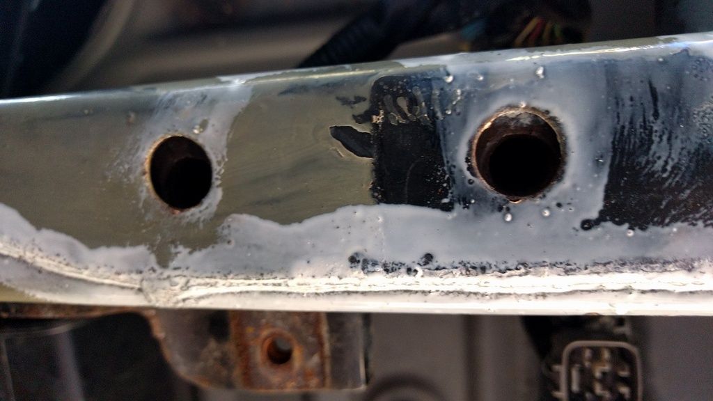

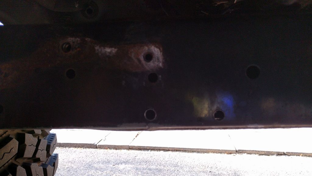

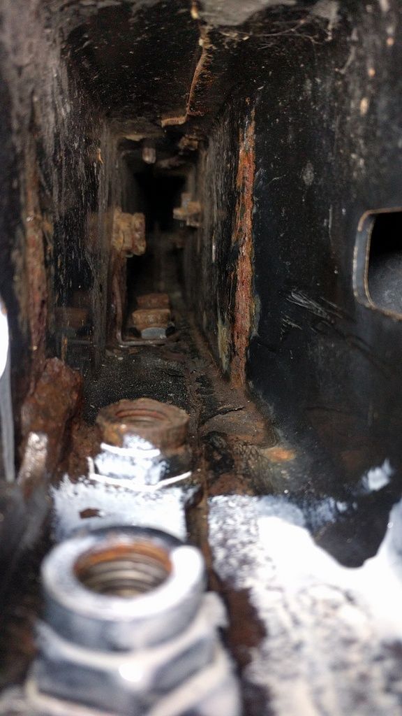

A common problem from what I have read but the rear bolts holes are misaligned.
I tried to pry them before I put the bumper on but there must be some rust between the tab and the frame.
I tried opening the holes by grinding them with the dremel but had no luck they where too far off. I also drilled some pilot holes on the inside of the frame and tried to push the nuts into place - they didn't move.
So I don't have the extra wing supports on now. Looking at options. I will either cut a hole in the frame to fit a real nut & tool in OR put in a rivet nut.

I got it done with an 1/4" air die grinder and a course cone tool. I think the dremel was just not enough HP. I was able too grind the frame without getting into the nut threads.
@cmck thanks for the suggestion. I picked up some of the cones and tried it today was able to get the nut hole opened up but I must have screwed up the threads in my other attempts.
I ending up taping it for a bigger SAE bolt using my pilot holes to move the nut over some, it kinda works but I wasn't too happy with it and I couldn't get the 2nd nut to move at all and grinding did not work (the nut is actually at an angle - the bracket must be bent). So I ended up drilling into the side and using that nut. Still need to work on the other side.
Final Result will have to do for now
