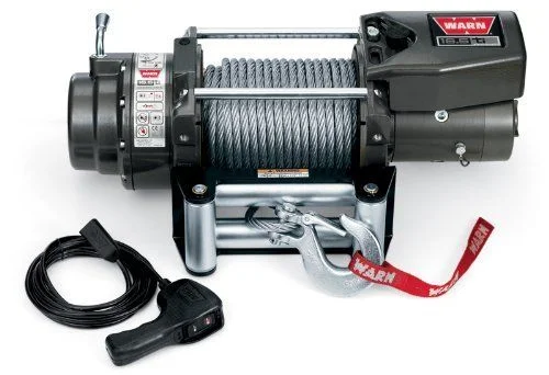

Remember you will be winching a fully loaded vehicle in less than optimal condition.Temperature and humidity is super high so a 12000 pound winch should be the minimum.Most guys I know in Central America are running the Warn 16.5 thermo winch on there bigger rigs because all the rest fails after a while.If you really want to get to the remote mountain villages you better be prepared.If you stay in populated areas with other vehicles around you can put a 9.5 on it and use a snatchblok and if it fails start walking until you find someone to set you free;)
Ok, well that's a bummer cost wise but I def don't want to burn one out right as I need it! :o

Holy frijoles that winch is expensive!!!
$1,699.00... :o
http://www.amazon.com/gp/aw/d/B0002Z9T1O

Buy one on CL for a quarter of that and do some maintenance and upgrades.
Agreed...I'll start looking!
-Daniel Kent
If "Warn" is attached to it, its gonna cost ya.
This. Lots of people are having good luck with the Harbor Freight Badlands 12000 lb winch. I'm tempted but the stigma is still there for me. Goes on sale for $299 all the time.
Yeah there are some great winches out there, but lots them would be super hard to get parts for in Honduras when they break. :(

The conditions are very different over there and the heat in combination with the moisture guarantees you to destroy your cheap winch in no time.Trust me I have been there and seen them all.Best winch would be to find a pto winch for the 60 or to make a winch cradle and keep the winch most time out of the elements and the river crossings.I used a Warn 9.5 XP for 3 years there and a buddy of mine is using it still now.

I know several of you are saying go with a 15k lb winch, but to save money we would love to use our current winch Warn XD9000. If I did my math right the BJ weight is around 5360ish and add 1000lbs for bumpers, people, etc. = 6,360 and x that by 1.5 = 9,554 and that puts us just 500ish above winch capability. If we use a snatch block we get double the pull power, will it work? Or will this just burn up the winch to fast? Thanks!
-Daniel Kent

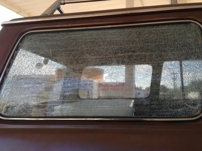

So here's what happen to the window: we hit a super large bump at 60mph causing my giant and heavy Yeti cooler to bounce up and smash into the center of the window and thus shattering it! Here's a pic after I put tape on it so all the glass wouldn't fall out.
Oh well, I guess that's life sometimes. ;)
-Daniel Kent
Oh the memories! I did that to the rear hatch window after owning the truck only a very short time...not as short as you, though, lol.
