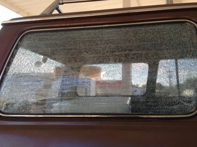

Well one of the bumps here in Colorado just shattered one of the back side windows on the BJ!!! So I guess I'm in need of one of those asap if anyone has one laying around. Frustrating!
-Daniel Kent
So here's what happen to the window: we hit a super large bump at 60mph causing my giant and heavy Yeti cooler to bounce up and smash into the center of the window and thus shattering it! Here's a pic after I put tape on it so all the glass wouldn't fall out.
