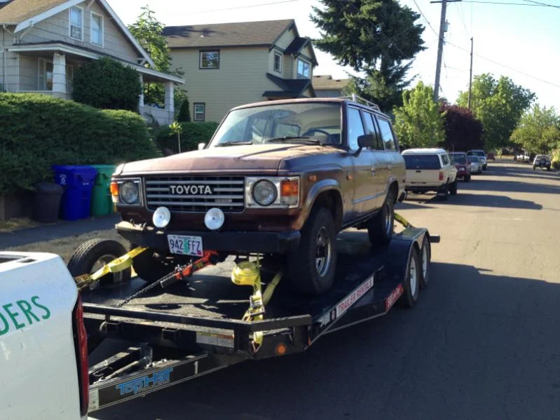

Are you on your way to pick this rig up or did you already do this ?
On our way (Texas to Oregon and back). Getting up now to drive 5 more hours to the LC and then hauling it back. I'm tired of driving!

Got her! Now we just have to make it back.
-Daniel Kent

How does she run?
On the quick test drive she ran strong and slow, the slow I expected. :D Can't wait to take her out for a proper spin at home.
