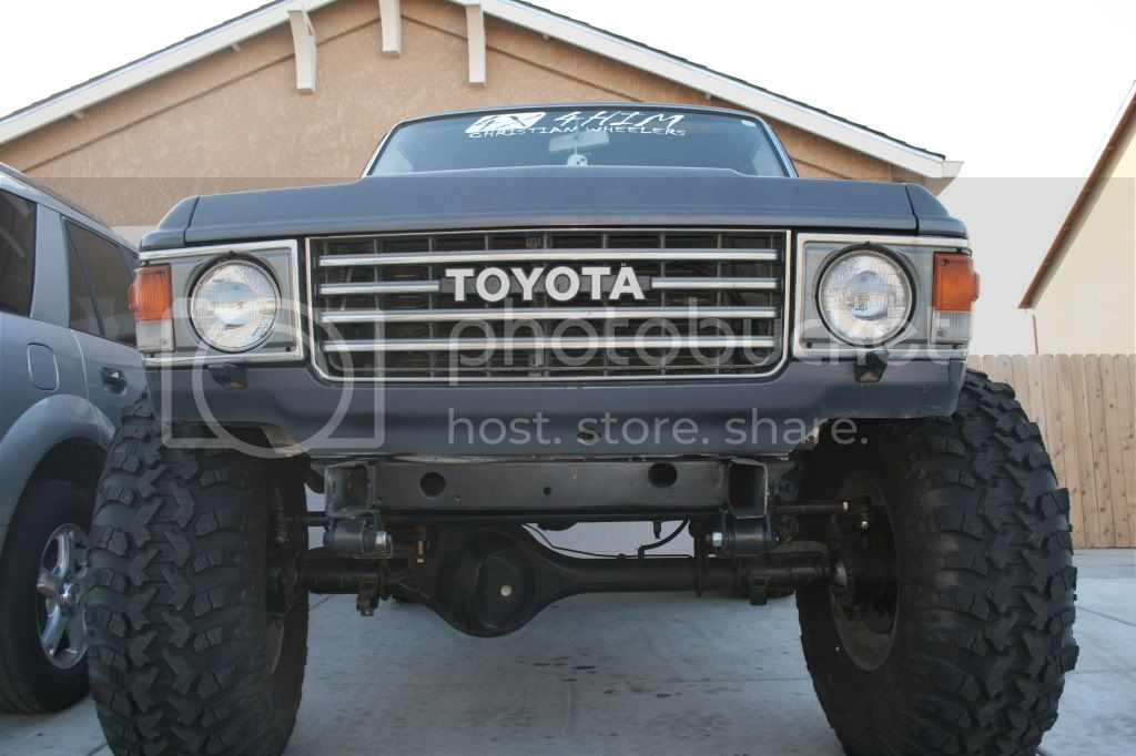

Noticed you did not capture alot of the axle with that beefy track bar mount, we have seen a few peeled away from those thin tubes....

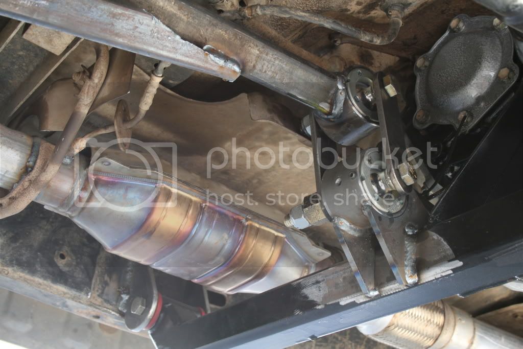

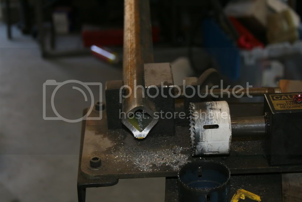

Been working on a trac bar. I decided to go with 1.5x1.5 square tube .25 wall.
I used Dan's axle mount. It worked pretty well. I had to open up the tube radius a bit. I'm going to add a gusset across the back of the bracket on the housing.
At the frame end, I did 2 RE joints with a 4" shackle.
The top tube is 48" long eye to eye so it should work pretty well.

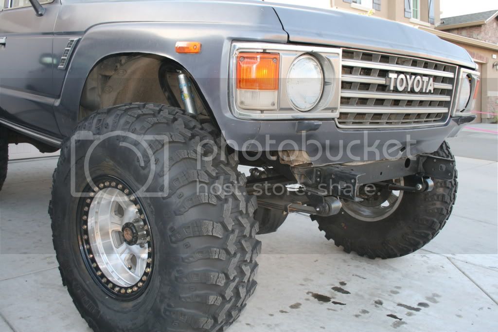

Fred, I was eyeing your front end bib trim at SNT,
Got any pics of it? (or have I missed them in the text?)
