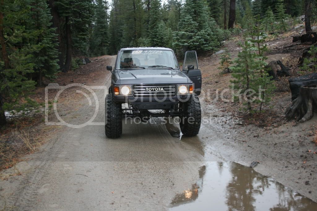

Finally took it wheeling today. TH etrip was supposed to be an overnighter and we were supposed to be in the midst of a good amount of snow. I took Hazel (my 4 yo. wheelin buddy ) and we were going to "camp" in the back. Anyway, from the time I pulled off my tow rig (I didn't drive but I'll give the low down on that later) to the time I pulled back on, it rained the whole time. So basically we raced in, hung out for a couple of hours, and ran back out.
I was driving so no action shots.
