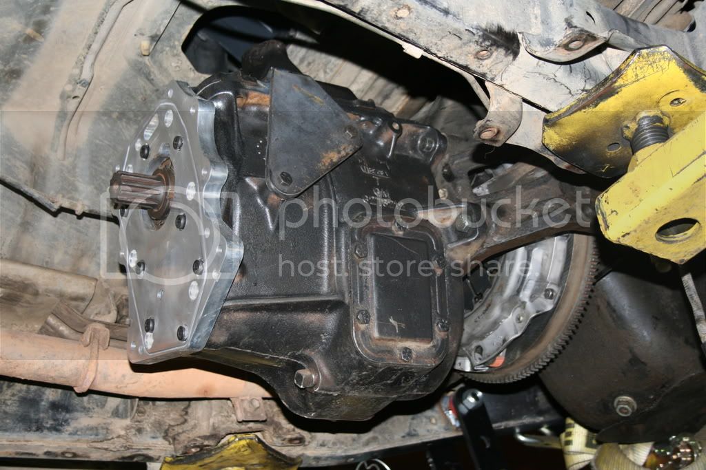

Got the tranny stabbed in. This took all of about a half hour versus the 3 hrs. I spent on the floor of the garage trying to muscle it in. I love having the right tools.

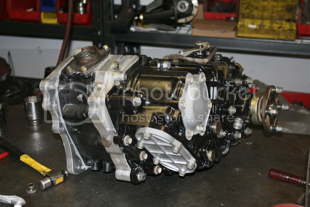

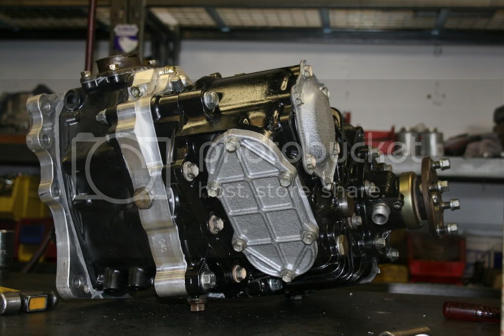

Split case buttoned up and bolted to the Toy Box
