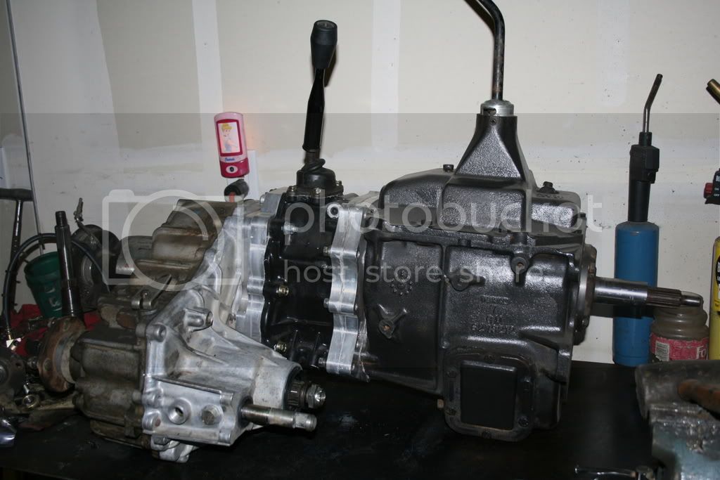

Got the flywheel resurfaced today and Marlin notched the front half of my split case. Threw it together quick like. Busy the next couple of days but hopefully I can get some time on the shift linkage this week.
SM465, MC 22 adapter, 4.7 mini reduction case, MC 23 split case adapter, 2.28 split case bringing up the rear.
With the 4.10s ( :rolleyes: ) I'll be running until I can afford the 4.88s, I'll have a 1st gear crawl ration of 2.88:1

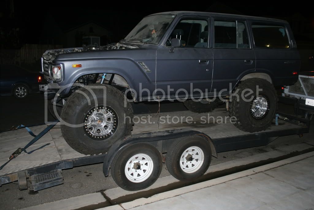

Should work out pretty well but I will definitely be using the Dodge and trailer for a bit to get to the trail head. :lol:
Looks like you may have one very short rear driveshaft.
Compaired to what? The drive line should still be 35 to 40 inches. That's the great thing about wagons, lots of wheel base for drive-train mods. I didn't even need to use a double cardin with my 420/toybox.
