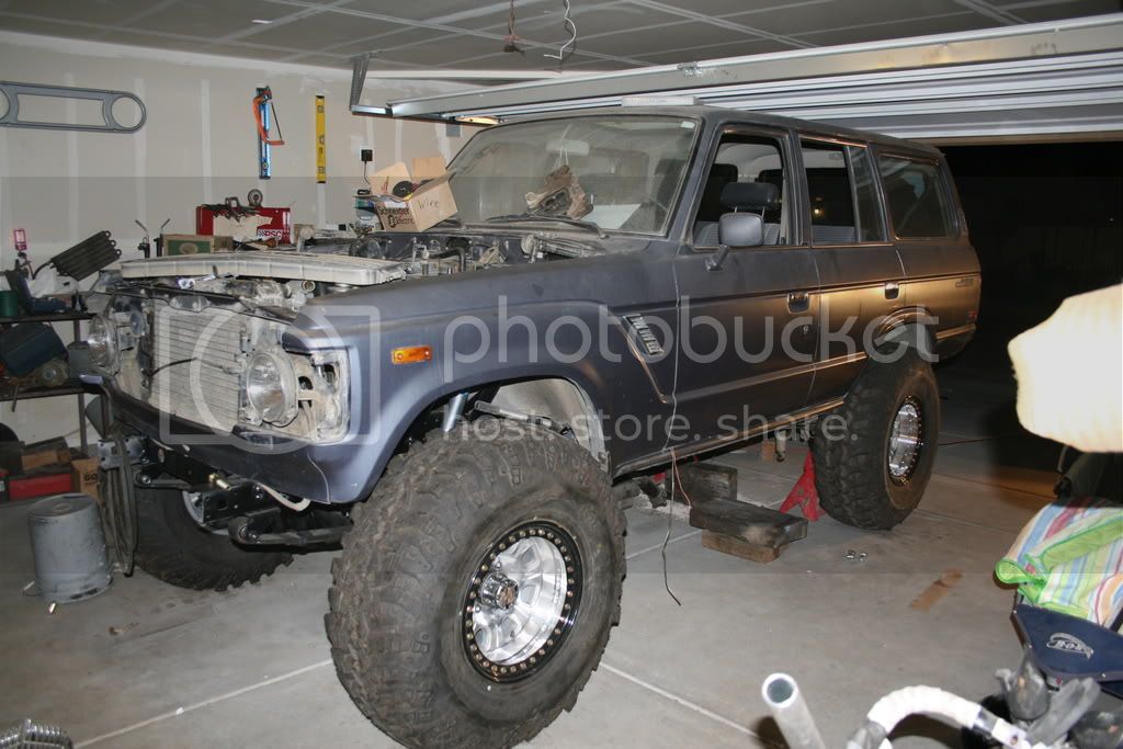

Freds40 builds a 60
The front end is now %100 done. It just needs PS fluid and the brakes blead but it is all together.

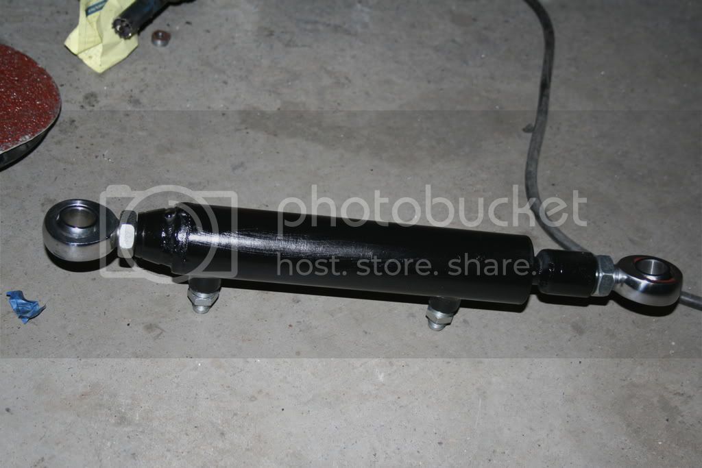

Heres the modified ram. It started out as Surplus Center Item Detail and I cut off the fixed ends and welded on some 3/4" tube adapters I had lying around.

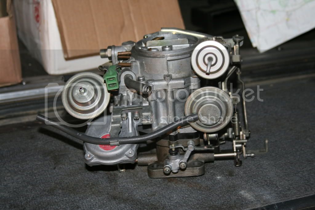

Got my carb. All nice and shiny and back from Jim C

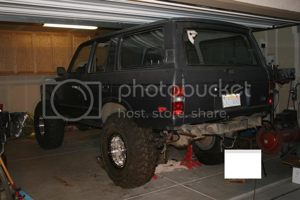

The rear suspension is just about done. Just need to burn in the sleeves for the rear shackle mount. Dropped it on the wheels to see how it sat.
The frame is right @ 25 1/4" off the ground. We'll see how much below the frame the drive train ends up.

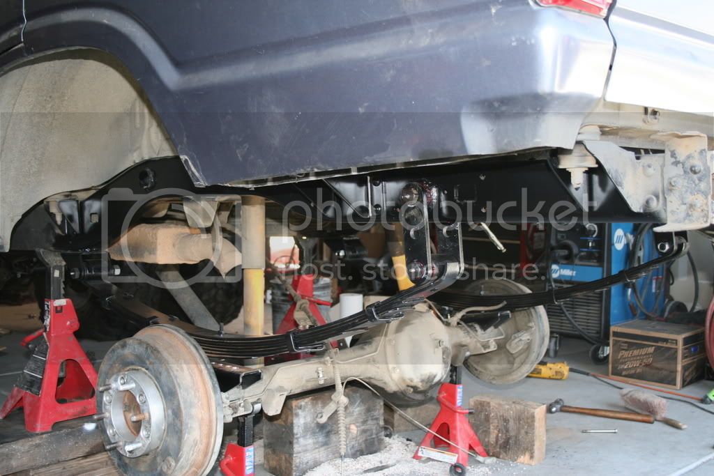

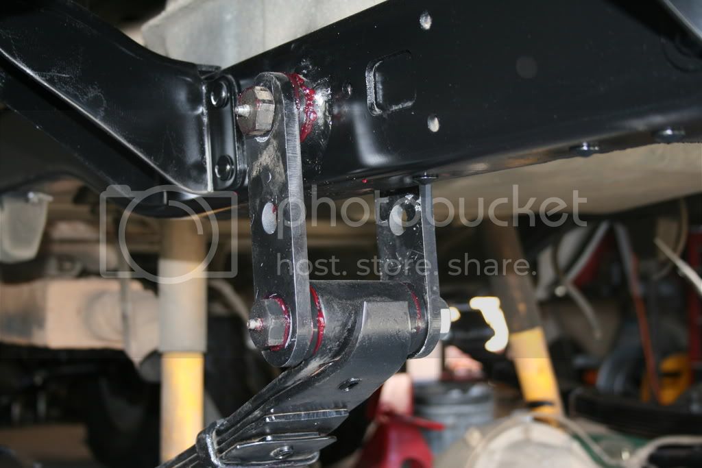

Got the rear suspension done. Just need to get some 12" Bilsteins and get them mounted, set the pinion angle, and burn in the perches.

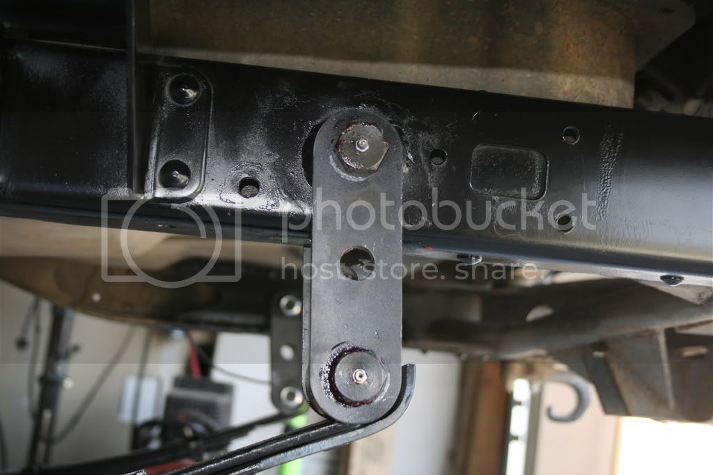

I added a leaf to the rear packs so I raised the shackle hanger location. Built a plate for the inside of the frame and ran the sleeve through.
Cleaned it up and threw on some paint.

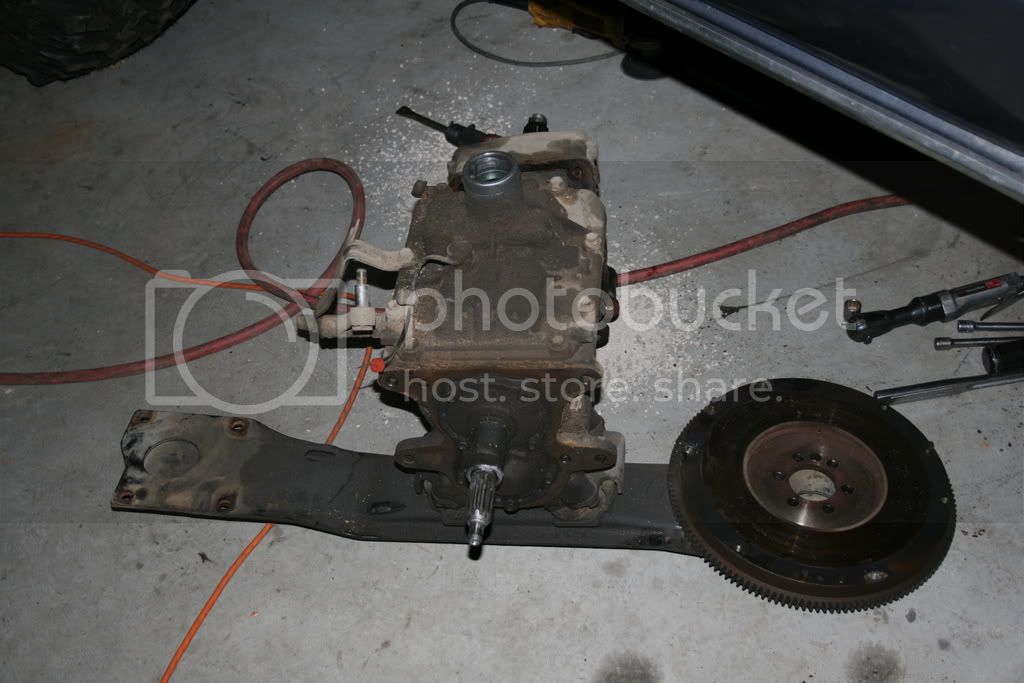

Got the split case pulled
And the tranny dropped
Tonight I worked on the flywheel, clutch, and Bellhousing. Everything went smooth except for the last bolt holding the pressure plate to the flywheel. Last bolt head was stripped out. I used the air hammer and my angle grinder and finally got it off. It shouldn't be too bad to extract the rest of the bolt as there is a fair bit still above the flywheel.
