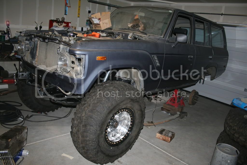

Alright, heres what I've gotten done.
The PS box is done. I got the assist hoses made up last night.

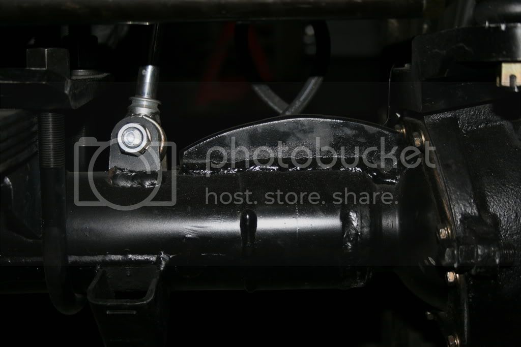

Got the Tie Rod end of the ram mount done. Just need to do the axle end.
You can kind of see the ram.
the tape is very temporary.
Made up some 1/2" knuckle gussets to tie everything together.

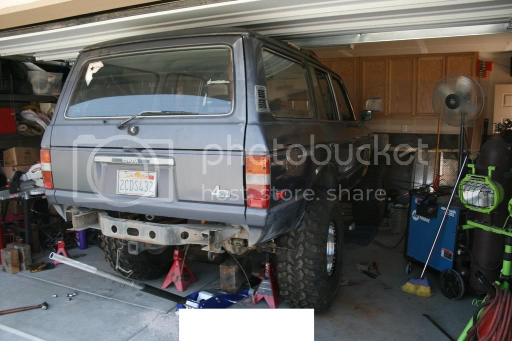

Heres how it sat as of a few nights back.

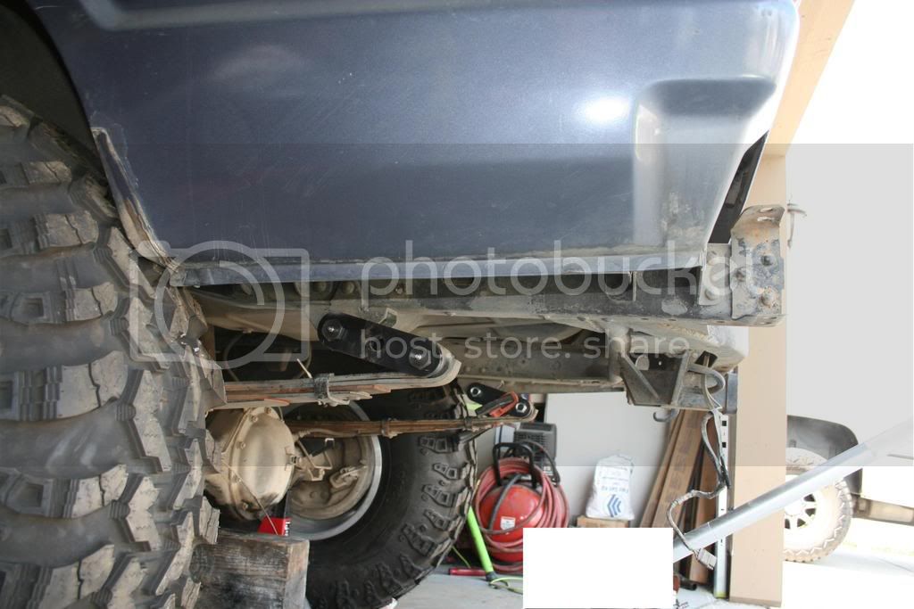

Today I worked on the rear suspension.
Got the leaves bolted to the front hanger and threw in the shackle end to the stock mount to get an idea of where I need to locate the new shackle mount. Hopefully tear into that in the next few days.
Beauty of a shackle angle. :lol:
edit: did it again :lol:
So there it sits. Hopefully next week I can get the rear suspension done and tear into the axle and maybe the tranny/cases.

What's the parts list for the hydro
Simple stuff.
You just need a ram (1.5" x 6")
4 re-usable -6 90 fittings
2 1/4 NPT male to -6 male adapters
2 fittings for the ram to take it to -6
I have a TON of hose if you want some. I think I have about 95' left. :lol:

Sure. It's pretty easy.
BTW, I forgot to add that on my ram, I cut off the fixed ends and welded on tube bungs for 3/4" Heims. On my mini truck I ran the fixed ends and had absolutely no problems even with DD'ing that truck.
I just did it on this one because I had the bungs and Heims laying around from past projects.
