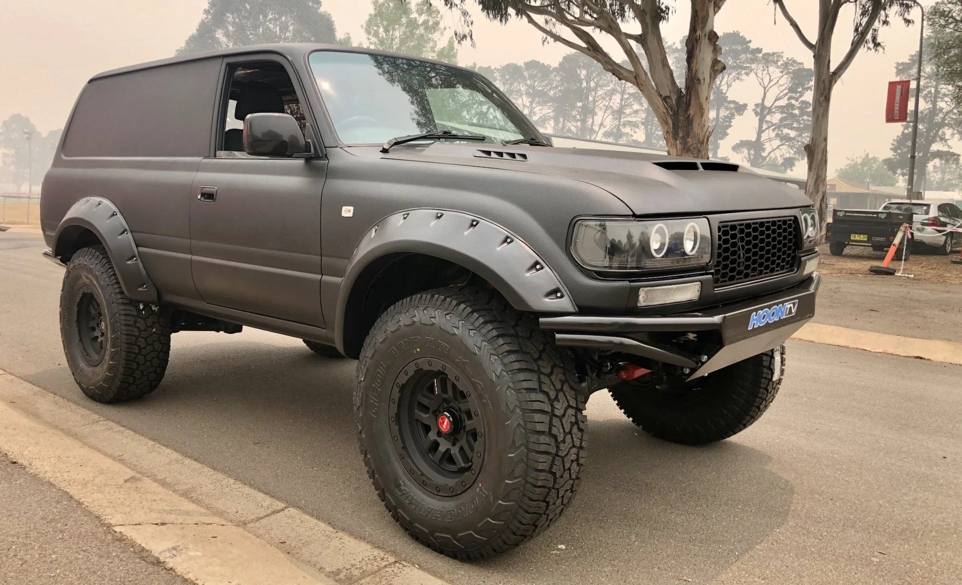

Hey all,
Bit late to the party posting this as it’s getting closer to completion, but I figured some people might be interested. I’ve been on here a while, I’ve just been more of a reader than a poster. Will try harder :)
I’ve had my 80 since 2010 and I’m the second owner. The first owner and his wife towed caravan around Australia with it a ton of times, so it’s has over 600,000km on it. A couple of years ago I decided to give it a birthday starting with the suspension and tyres, then made my own bars and fitted a Mark’s part time kit.
Last year I was approached by Burson Auto Parts here as they wanted to support a build in my YouTube channel HoonTV. I pitched the crazy idea that I wanted to turn it into a panel van and right now with the help of some great friends, it’s about a week away from firing up with the new 6-litre engine combo.
To check out the build, you can go to the build playlist in the channel, or follow HoonTV on Instagram.
FRANK THE TANK - Landcruiser panel van build
