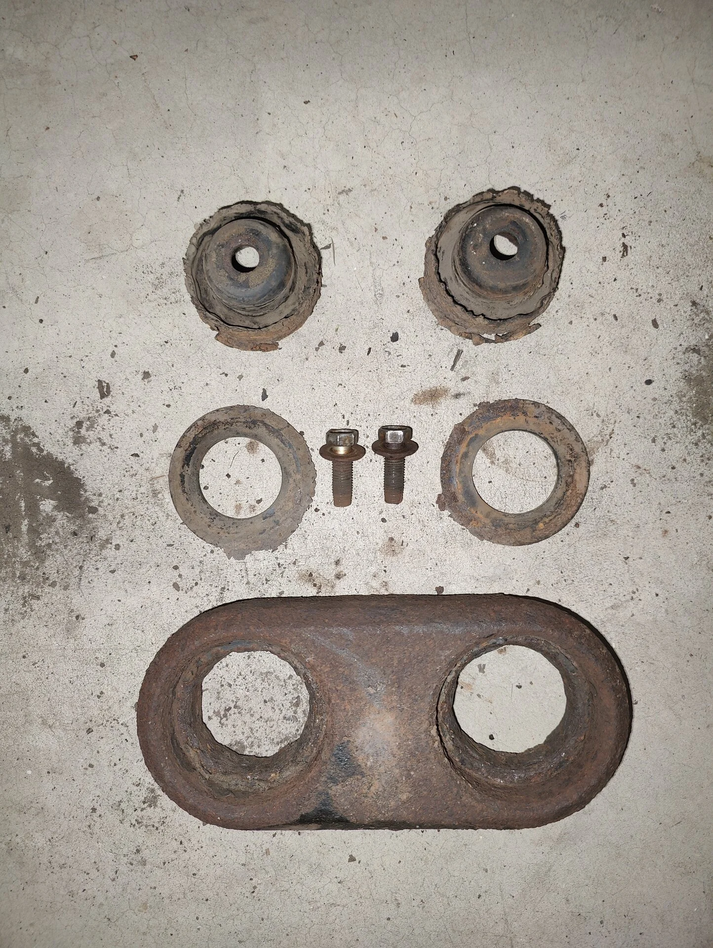

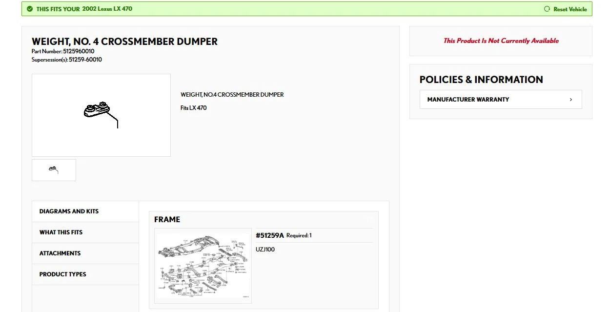

Hello, I just removed the frame weight from my 2002 LX. It was just flopping around, the bushings are completely shot. It was located below the passenger door. Does it do anything? Is it worth keeping? I would need to find some kind of rebuild kit. Based on my research this part is discontinued. The part number was 5125960010 and it was called, Weight, No. 4 Cross Member Dumper

With that amount of rust, the vibration frequencies are likely to have changed for several parts of the frame, so it might not be needed anymore in any case. Just try it out without.
I think it's silly to remove it when it's in good shape, but I wouldn't fret over replacement of yours.
In a brand new car (or a very nicely refurbished car), vibrations/noises are way more noticeable. As the car ages all the rubber ages too and almost nobody bothers to get in there are replace all the joints and bushings. There's a lot of things the average 100 owner should refinish/refurbish. I'm not sure this frame weight cracks the top ten list.
Keep it if it's in good shape, but don't fret losing it if it's deteriorated like the one pictured in the first post.
