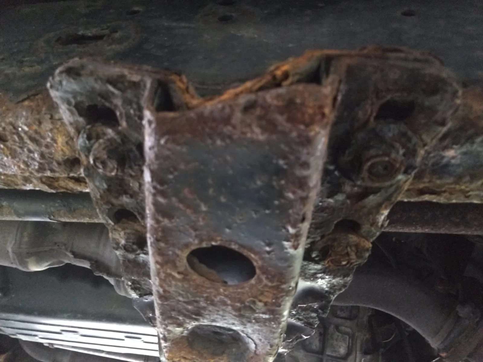

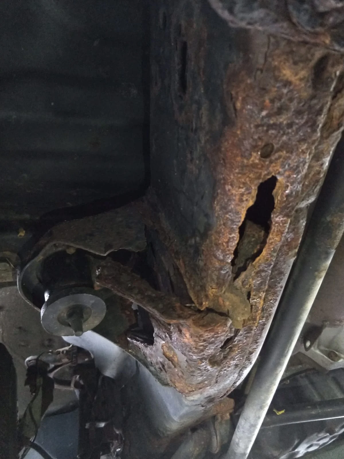

Here are a couple of photos of the frame that my son took this morning, driver's side fairly near the cross member. He's off getting a light to take better photos, but...it is worse, much worse than I thought...

That looks rough at first glance but once you wire wheel it and get all the flaky stuff out of the way and see where the true rot is, you'll still be way ahead of where I started from. Believe it or not, you can fix that safely and make it stronger than new with just a bit of angle iron, a grinder, some arc rods, and a bit of time. Since your son likes working on the truck, I'd have him lay under there with a hammer (and eye pro) and start banging away to get all the flakes off. After that, start hitting on the frame to see where the bad stuff ends and the good stuff begins...my guess is that you're going to find some more weak crust and nasty rot underneath where the crossmember bolts too. Also be prepared for the outermost crossmember bolts to wring off but the two inner bolts will probably come off. Have him brush a tad of brake fluid on them each day when he gets home from school so that they'll be ready when you get home. This is for both sides.
Once the crossmember is off and you see how bad it is, that's when the real fun can start:)!
But no worries, even if you work slow you can be good to go in just a Saturday and have a nice strong new section in place. Check your rear body mounts, I bet they're rusted off the body or otherwise in pretty rough shape.
