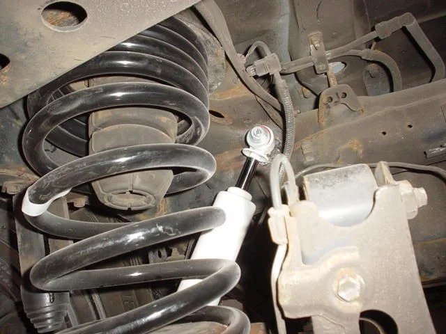

I spoke with Christo earlier today and he gave me a couple good ideas. When Sam gets back I want to talk with him about moving the upper rear shock mount to the top side...to get the shock approximately 3-4" farther up...then bring the lower mounts back up and actually above the stock studs (may require longer shocks). That'll relieve my worries about having the lower mounts so exposed...cause I will smack them eventually! And I plan to shield the struts with heavy rubber matting to keep debris spray from the front tires from sand blasting them into an expensive mistake :rolleyes:.
I wonder if you move the shocks top mount inboard, will it interfere with the sway bar on full droop? Take a look at Podvin's rig. I believe he ran 14" travel shocks.

Good idea to consider Les! I'm going to talk to Sam next week about options...I know the way it is now will be trouble. Sheeesh...I was crawling around underneath last night and discovered I have bent both lower front control arm mounting flanges....and have bent the the DS t-bar mount flanges...so the protruded shock will be an easy target for me :rolleyes:

that is a clever upper eye mount,
generally moving it inboard like that reduces the effectiveness of the shocks- is it minor so it doesn't affect it much? or is there a way to keep it more centered-in line with the orig. mounting.

As for the rear axle, instead of shortening/lengthening the links, how about just rotating the spring perch? Messing with the links sounds like it could invite some driveline vibrations and premature U-joint failure. But first of all, is it even a problem with 2-3" of lift?
Yup, another reason to get them fancy Fox shocks with the adjustable valving. :cheers:

Beer thirty coming up...Stone IPA time! Well...I've had a driveline vibe since the big driveline conversion over a year ago (I removed the front driveshaft and the vibe 95% disappeared...although to get a baseline comparison, since driveline vibes are hard to diagnose, I have not had time to remove the rear drive-shaft to compare. The pinion and t-case flanges are not parallel...although probably at borderline range of being acceptable (the pinion points directly at the t-case output...which it should be rotated down...which would put it back to stock #1 and take care of the spring perch issue #2).
The farther away from being perpendicular to the axle then the more energy it would take to initiate shock action; i.e. rougher ride until you hit the big bumps...all things being equal.
