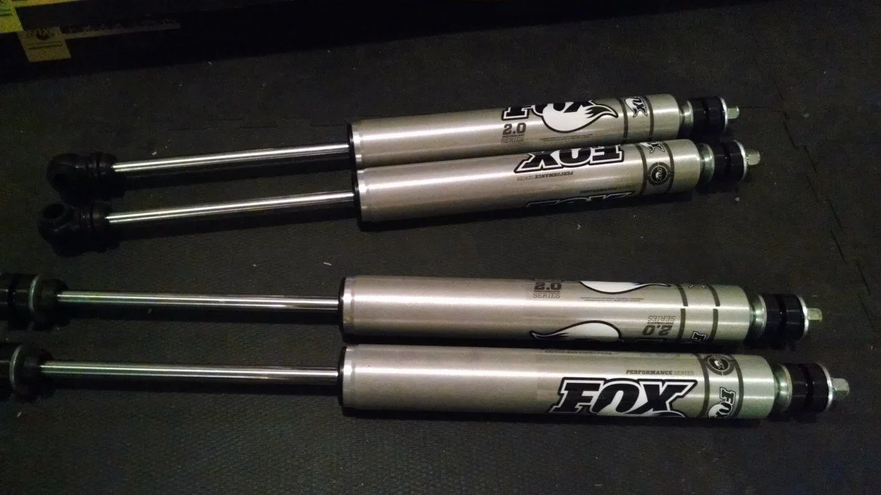

:doh: :bang: I'm an idiot. Didn't even notice the best offer and paid the 241 :bang:. Well done on bargaining skills. Oh well still a great deal for me too. I received mine this past Tuesday and Lord willing I'll get them in tomorrow. As straight forward as it is something always seems to happen.

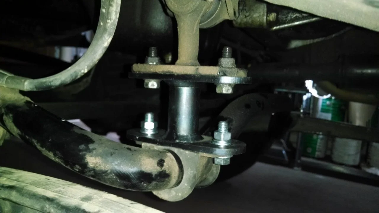

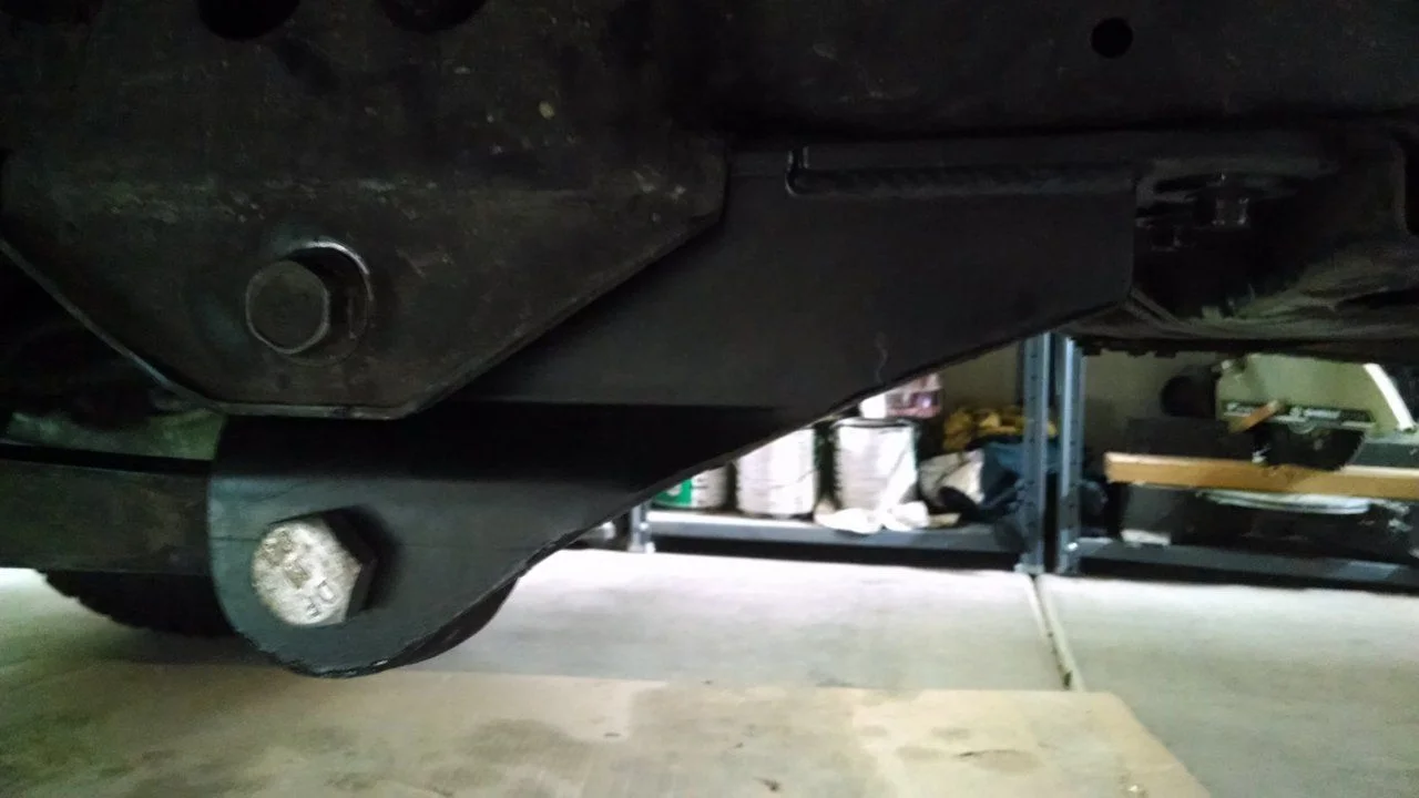

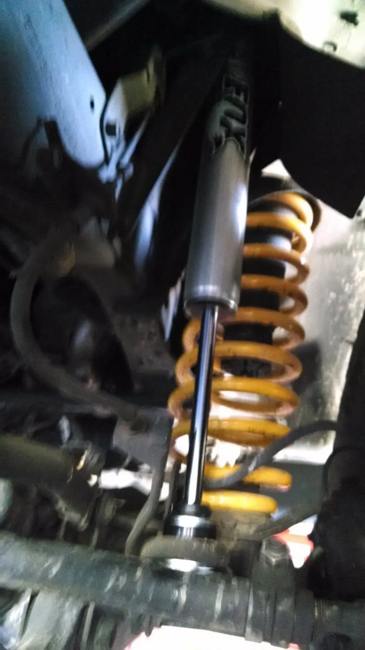

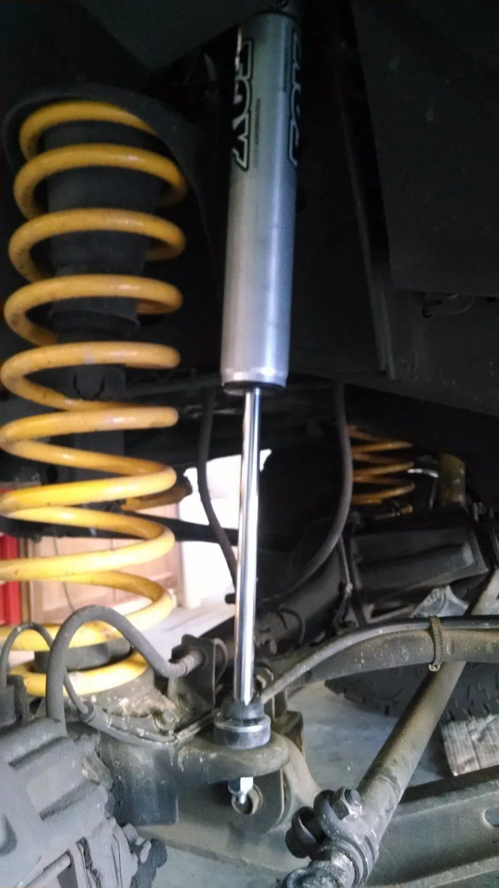

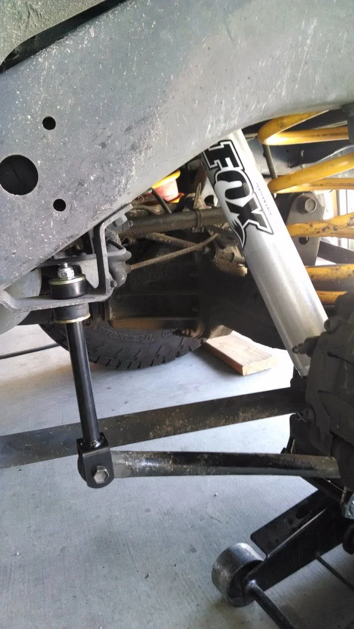

All right I was able to get them installed on Saturday! The combination of getting my castor dialed in more with the drop brackets,and new shocks, the ride is night and day. No more jarring and all the bumps are absorbed nicely. It will ride even better as more weight is added I'm sure (BIOR tube bumper and dual batt planned). With my wife and two boys on the way to church this morn even that weight made a slight difference as opposed to just myself on the first test drive...I think...may have been a placebo affect but don't care it rides awesome. Even my wife commented on how it wasn't enjoyable riding in it anymore and now she loves driving/riding in it. Now you have to understand I removed OME shocks with over 100k on them and two were shot for sure. Plus the other two Cruisers I owned were all stock (94 & 96) over 10 years ago. So with those things in mind others with more experience may not have the overwhelming noticeable difference I am experiencing. Just trying to keep it in perspective. At any rate I love them and stoked my rig is like new to me again!
