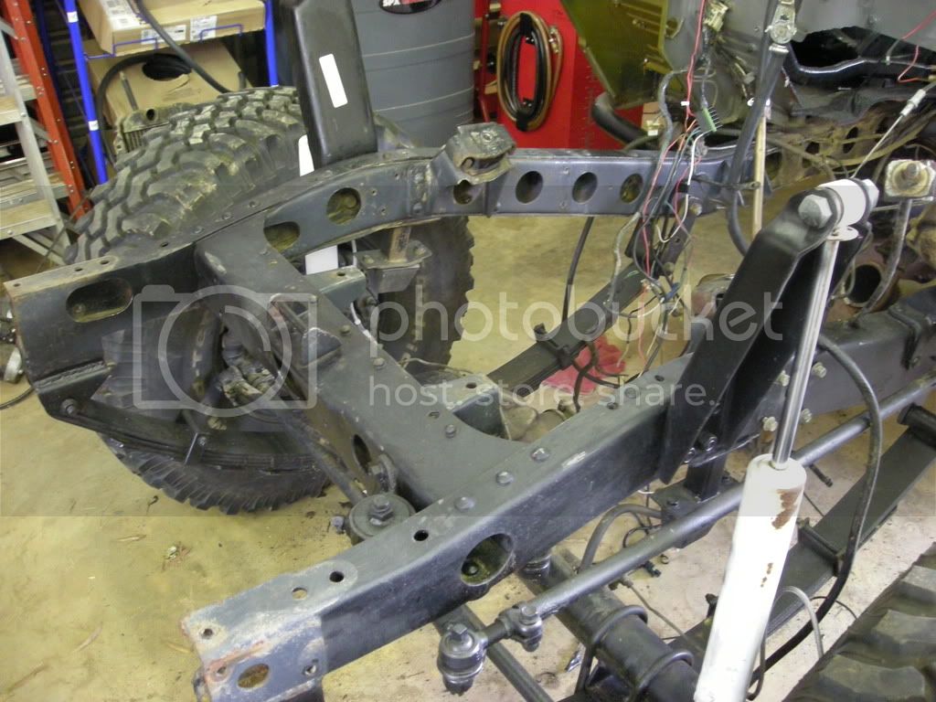

Pics:

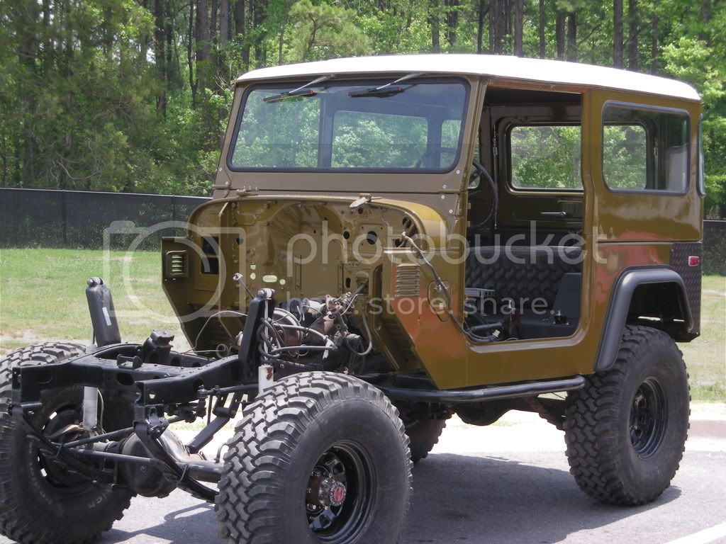

I agree with "grant5127's" Ford part number, we use them all day long. When I look at the photos of "fj40er's" rig, it just screems "please weld on a triangular back gusset between back side of shock tower and top of frame"!!!!!
I have to agree and disagree with this...
Those towers appear to be bolted on... and only to the outer face of the frame
under hard us I would be concerned that the frame might pucker at the mounting holes.
but... if you weld it on, which is how I have mounted more of these than I can remember right now... full length all the way around the perimeter of the contact between the frame and the mount... that will be absolutely strong enough... the shape of the tower is it's own gusset... it was designed to work under a much heavier rig than a '40... and has done so just fine for Ford. and we have had zero failures under '40s... and I have heard of zero failures from others.
Welding a gusset to a bolted on piece would seem silly to me too... just weld the tower itself on. that is the best way to mount it... and no gusset is needed on that tower
Mark...
