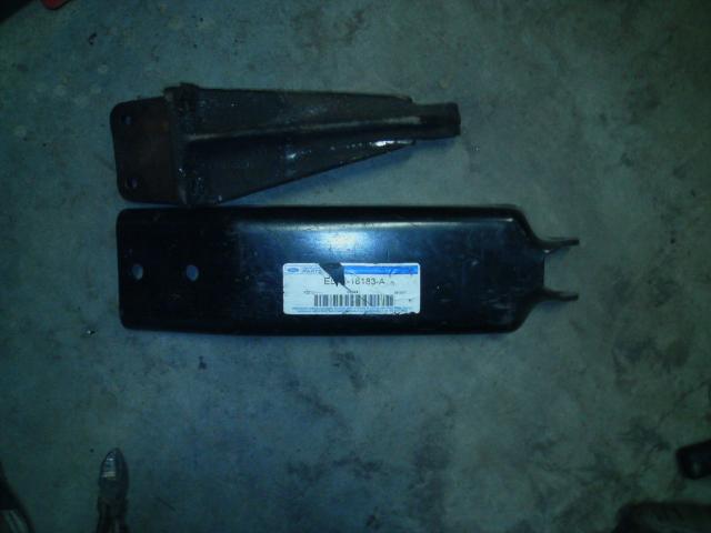

stock vs ford shock towers
Not to hijack the thread but, IF you do go with the Ford towers do you have to buy different shocks being they allow for more travel?

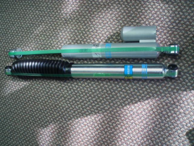

its probably advisable as the current shocks could be too short. i used it as an opportunity to get some of these:
Chop the ford tower off at the bottom of the top mounting hole when stock length shocks are to be used.....
