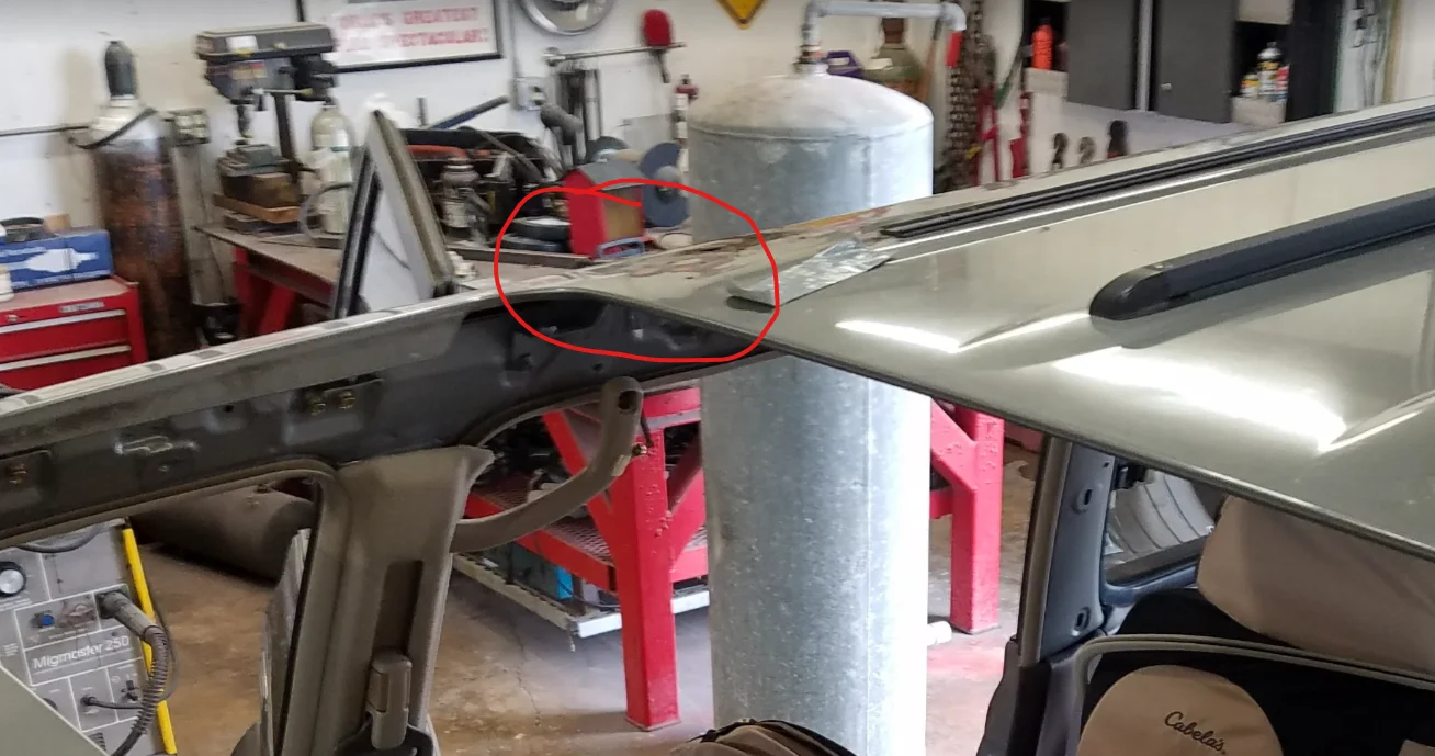

My sunroof was removed when welding in sheet metal for the front roof rack holes. It was years ago but IIRC the rear portion of the assembly was in the way.
Found this pic. Kinda shows how close it is
