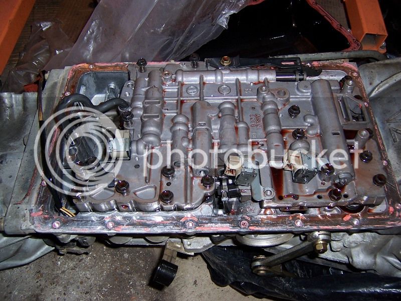

Regarding the transmission... Toyota used the A340F for all model years of the 3rd gen with 4WD. The trick is that Toyota used three different valve bodies to control the A340F over the years, and not all of them are interchangeable.
The early model years (1996-1998?) used a VB like the one below. Notice the overall length, which is shorter than the later versions, and the presence of the tubes (there should be two tubes, one has been removed in this photo) on the left hand side. The tubes are transmission fluid paths that were integrated into the actual VB on later versions. Also note the connection for the transmission kick-down cable @ bottom center. The other end of that cable connects to the throttle body and controls line pressure in the transmission @ various throttle positions. Last, notice that there are only three electronically controlled shift solenoids. Two along one edge and the third at the end near the tube.

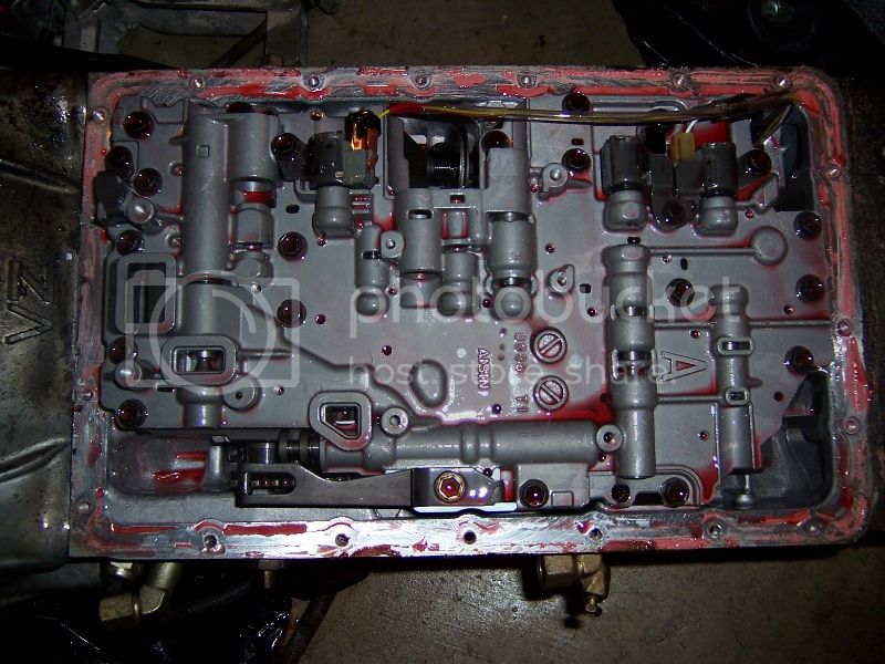

The mid generation model years (1998-2000?) used a VB like the one below. Notice the increase in overall length, and that the VB now encompasses the fluid paths that were previously separate tubes. Also, notice that there is still a connection for the transmission kick-down cable to control transmission line pressure. Finally, there are still three electronically controlled shift solenoids, but their position on the VB has changed. All three solenoids are now aligned on one side of the VB.

You will not be able to install the valve body from the early/mid models into the '01-02 transmission due to the presence of the SLT solenoid on the '01-02 transmission valve body and the fact that the early/mid valve bodies use a kick down cable, which the ECU on the '01-02 has no means of controlling.
A transmission with the mid-gen valve body should install into a rig with the early valve body. They have the same number of solenoids and both use a kickdown cable. The ECU wouldn't have a clue that the valve bodies are laid out differently as long as the electronics are the same (solenoids).
There is a chance that you could use a transmission from one of the early/mid-gen model years in an '01-02, but you would have to swap over the valve body from the '01-02 trans. However, I'm not sure that would work because there might be differences between the fluid paths on the transmissions themselves. Also, if you installed an earlier trans with provisions for only 3 solenoids into an '01-02 that uses 4 solenoids you would have to modify the wiring harness to allow for the extra solenoid.
Hope that helps.
