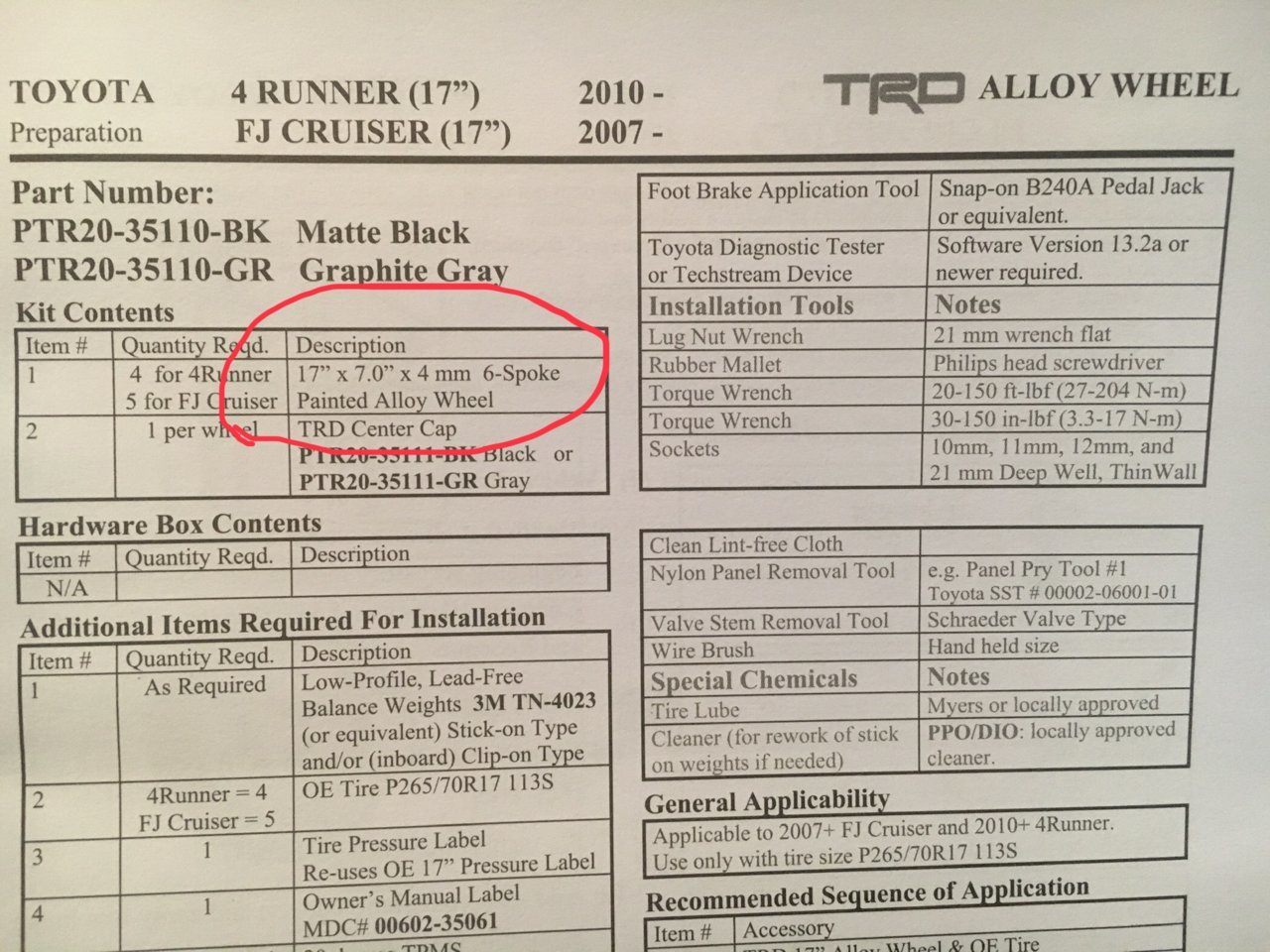

And what are the specs on your TRD Pro wheels like width and offset? I always get confused if they are 7" wide or 7.5" wide.
7x17 I think with 4 mm offset. Hopefully it’s the right specs
Yep. They are 17x7 +4 offset

I read somewhere that a rule of thumb for off-roading is to get wheels that are 2” to 3” narrower than the tire.
I think it makes a difference when you lower the tire pressure for off-roading.
285/70R17s are typically 11.5” wide. So, a wheel that’s 8.5 or 9 wide is in the rule of thumb guidelines.
Moreover, the tire mfgs tell you their recommended range and I believe it’s 7.5” to 9” wide rim. And these 285 tires are usually tested with 8.5” wide wheels...from what I’ve read.
Anyways, many others run the trd pros 17x7 with the 285/70R17 tires and I haven’t heard any complaints or issues.
