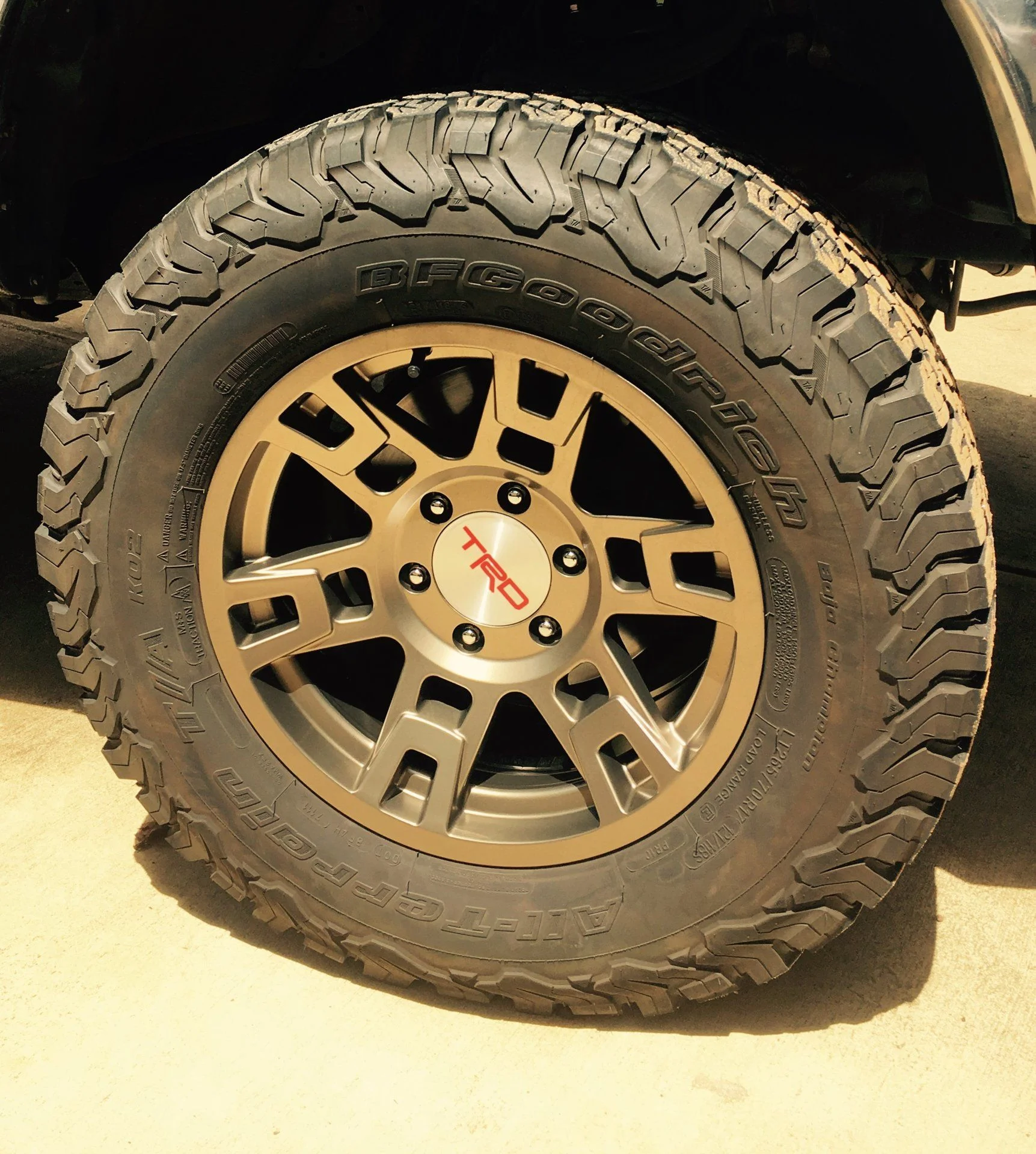

I'm running the FN fx pro on 285/70 BFG AT KO2.

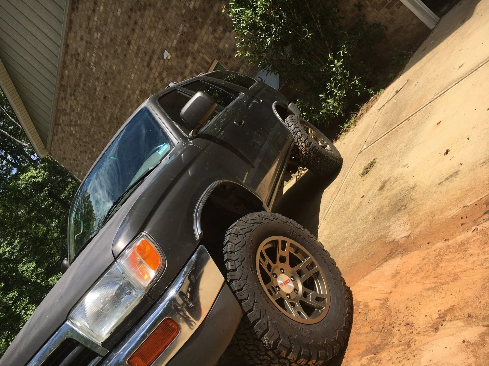

FN F(x) Pro on my 98 4Runner with 265/70 KO2s. As much for the want for Bronze wheels as for the extra width if future build calls for wider tires.
BMC. Had to pull the fenders forward slightly and trim some of the plastic from the upper running boards.
Looks really good! Did you have to cut the fenders or modify anything to prevent rubbing?
