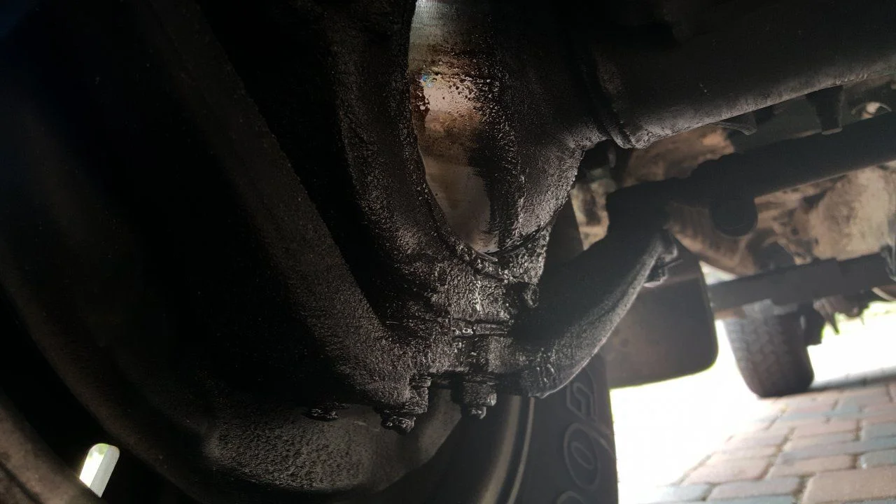

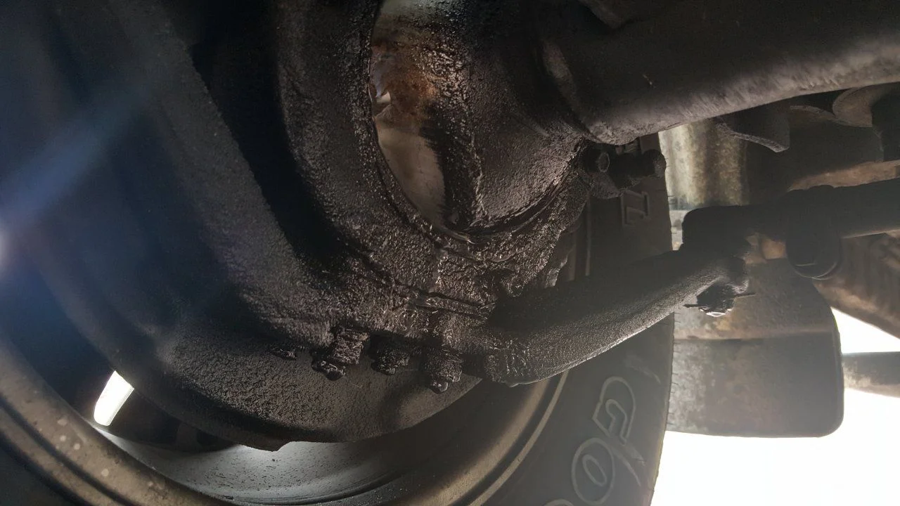

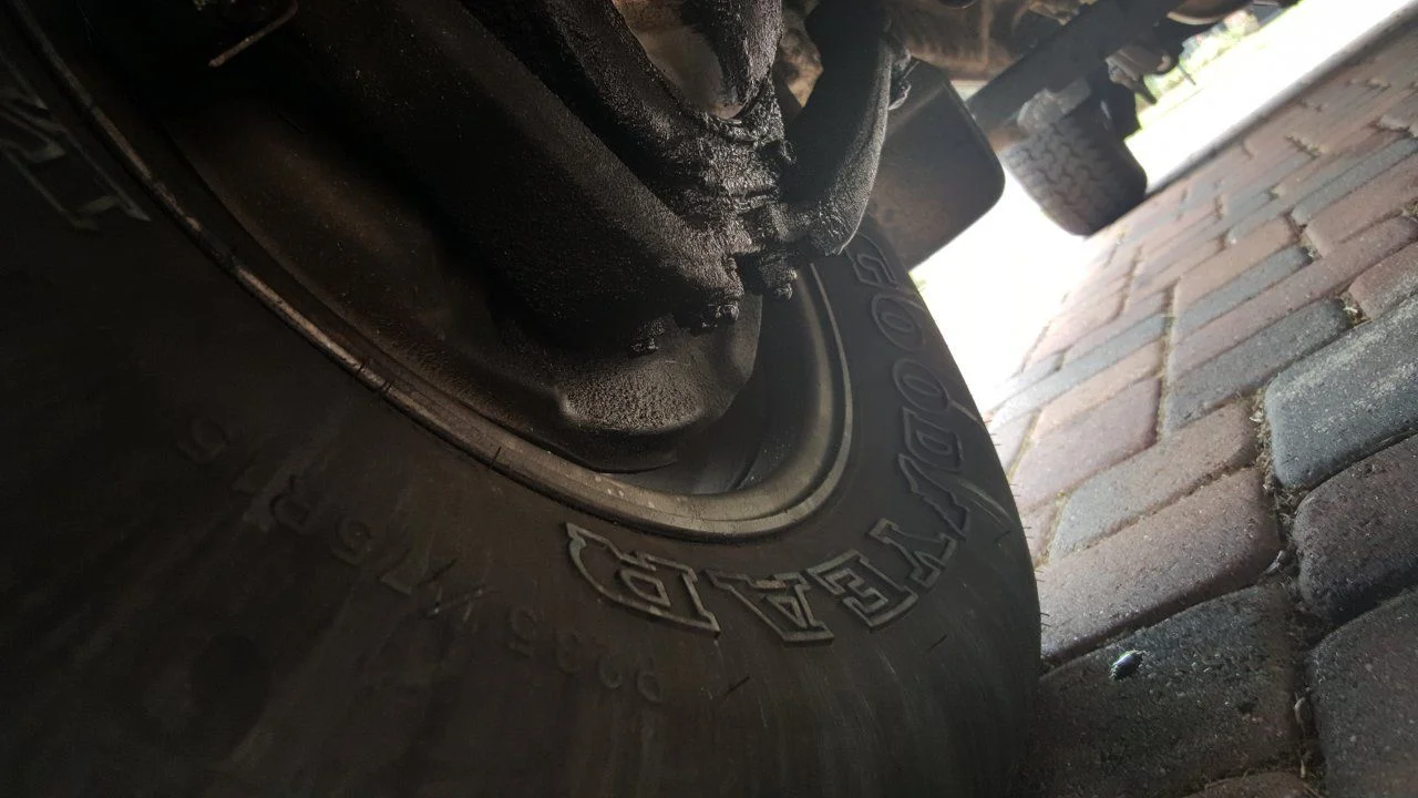

Right knuckle has some thick black fluid coming out of it when the truck stops for an extended period there will be a puddle of it underneath. Fluids are good, power steering pump is leaking a little, and the oil at the dips tick is clean and clear. This smells like burnt grease but runs like oil. Attached pics. Any help appreciated

Looks like your axle oil seal crapped out

Knuckle is full of grease that is thick like peanut butter.
If you have leakage then it's likely that inner seal that separates differential oil from knuckle grease has given out.
