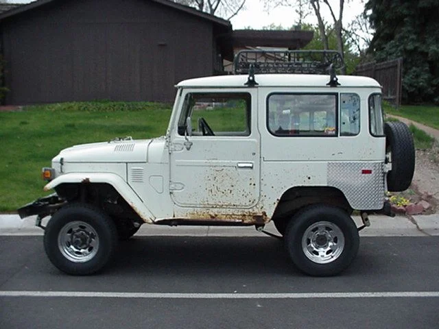

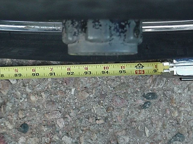

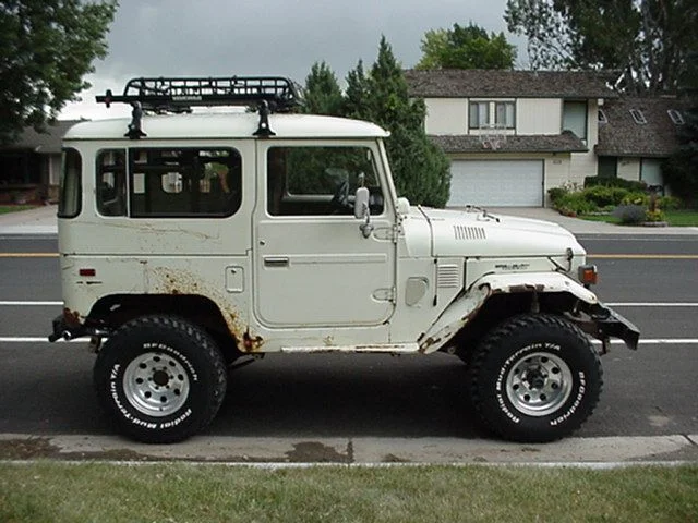

Can someone post some pics of this. I have a 4" HFS lift and want to get an idea of what the rear fenders would look like if I flip the springs and cut the rear fender.
attachment.php
with trimming:
attachment.php
attachment.php
wheelbase:
attachment.php
