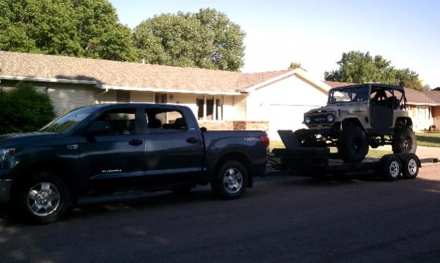

Got the trailer done today and it works great. Did a test load to see if everything works. Pretty good find for a grand just needed some paint.

Holly s***y day on the road. It took 7 hrs to make a 3.5 hr trip. Thr trailer blew 3 tires and had to unload cruiser on interstate and drive 40 miles to a town to get tires. The kids where shot ny the time we teach co. But we are here and headed to the trail in the morn.
So much for that "Got the trailer done today and it works great. Did a test load to see if everything works. Pretty good find for a grand just needed some paint. " lol looks like it needs some new rubber as well. ;)
Hey if you need anything while here in CO let me know man
I know right, who new the guy who put stiffeners in the fenders left a pices of metal down the center that slices tires in half while loaded. I will thanks for tje offer will ne at indy in the morn if close come join.

I see a bunch for the stock "roll bar", but I cant seem to find any for the family cage like we have. I looks friggin MEAN on the trailer! Cant wait to see the action shots!
