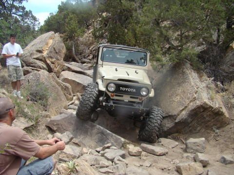

I only have my phone so I will how this works. There will be no order and will only post a few. The trail was liberty and we drove in and back out. Had to move a fj that was broke and abandon in the middle of the trail. The top was made by a local guy he used boat vinyl and only charge like a hundred I think. I had him make tje sides down farther so rain would run off. Here is dome pics I hope.
The pit bulls where awesome gripped like mad. I had them down to 15psi and should probably do 10
Man that truck looks good. Glad you like the pitbulls, I'd like to get a set myself.
Yeeeee haaaaawww!!!!
I can not wait for my maiden voyage!!
Good for you. Looks great out there!
It was a blast we didn't get vary many pics going back out due to one guy in the group broke and we spent a couple hours getting him out another way. Uphill is defiantly way more fun. Will post some more pics later.
