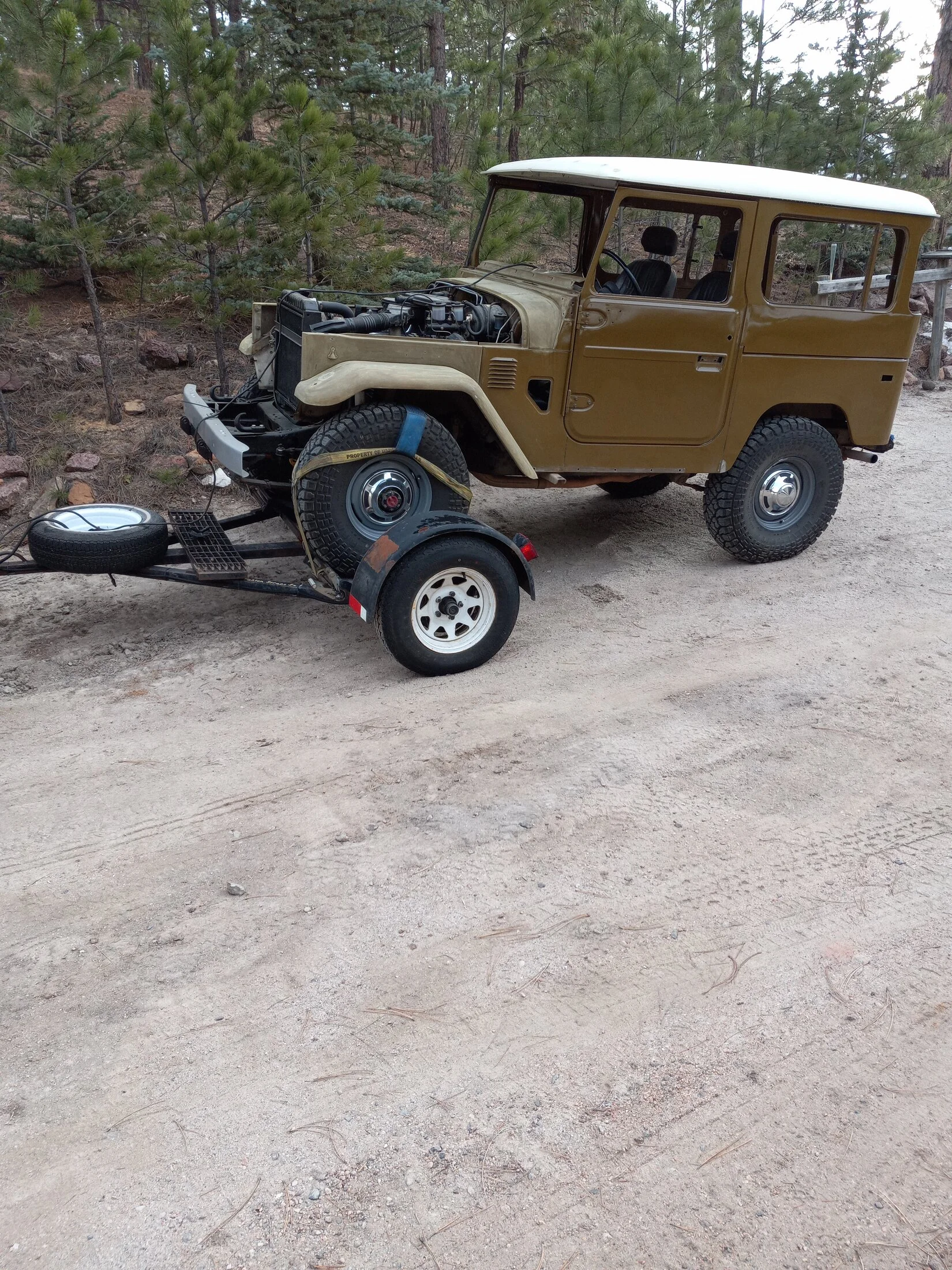

Reviving this thread - I'm going to flat tow my FJ40 to the paint shop. I have never flat towed it, but installed the equipment so I could flat-tow it out during a forest fire evacuation.
Is the idea behind 'bungee cord through the steering wheel' to allow some wheel turning, but not lock-to-lock? I have minitruck PS in my FJ40, so it may not easily turn with the engine off. 1978, so no steering wheel lock.
I presume when you turn a corner flat towing, the front wheels will turn a little from the road force and keep from skidding things?
Steve
Steve
If you can avoid making any sharp turns, you're gonna be okay. Those sharp turns are what cause the wheels to go the wrong direction.
I used to flat tow a Willys and even though the steering seemed good, the wheels would turn full lock in the opposite direction around a tight corner. I tried the bungee cord method and it didn’t hold the wheel tight enough.
Instead I used a rope lightly ran through the steering wheel and back to the seat brackets with just enough slack for the wheels to turn a bit but not enough to make a full revolution of the steering wheel.
@Mike Shull - thanks, that's what I had heard and wondered what it took to prevent that. Your method sounds good!
I will do a test-tow around my 'hood and be sure it's ok to go across town.
Follow-up:
I ended up using my tow dolly for various reasons...but appreciate the advice on the tow-bar, as that may get called to use someday.
Off to the day spa for some paint work...
