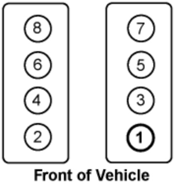

Sounds like a coil pack died. Pretty common but easy to fix with just a 10mm socket. OBD codes P0301-P0308 are for misfires on cylinder 1-8 respectively. Part numbers are Toyota 90080-19027, or Denso 673-1303. Buy from a reputable seller to avoid counterfeits (I.e. not Amazon or eBay). Here’s the cylinder map:

This is what I was thinking was the highest probability. My dad told me a few hours ago he had already replaced 4-5 so it would make sense. Thank you for the tips and the picture! Genuinely appreciate it.
This was a really helpful illustration!
