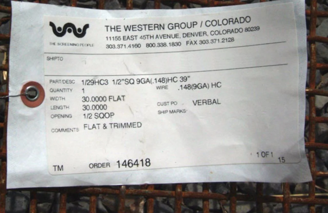

The answers to all of your questions are on the first page of this thread. All of that info is in the pictures...
Darasick- maybe I'm missing something but I don't see the information I need. Specifically:
2) The opening of the screen you need. If you want a duplicate of the attached pictures just measure the inside of opening, wall to wall.
3) The diameter of the wire.
4) What type of material you need: plain steel (hi-carbon) or stainless steel.
I'm looking to purchase exactly the same wire screen treerootCO used, and from the same source (The Western Group), so I figured he could let us know exactly what he ordered. If this information is obvious to you, it would be more helpful if you were to post it up.
It's all there in the tag photo. 30"x30", wire gauge, opening, high carbon, etc. Hell just email them this picture...
Darasick- thank you, sir! Not sure what's going on, but that photo is not showing up for me on the first page, but your attachment works just fine.
30x30, 9ga wire, 1/2" opening
For reference, I just ordered the same thing treerootco did through The Western Group and it cost me $50 + shipping today.
