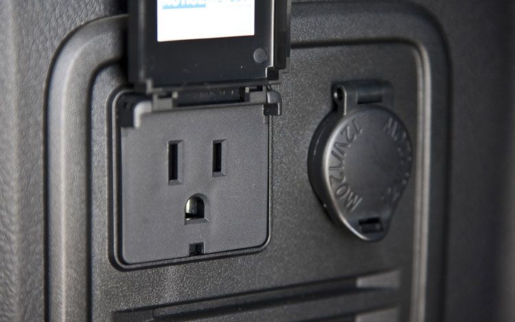

Well, a '05 Matrix is my daily driver. I beg to differ. You can definitely use a 3 prong in this outlet (see pic, with the small hole on top of the two). I charged my laptop on it without a problem.
I picked up one of those matrix plugs. If you look close that third hole or ground post is not really a hole. It is just a space left after the molding process or something - it doesn't go all the way thru.

I stand corrected. I just checked and you're right. I must have been mistaken by my previous laptop whose plug had two prongs sted of the current one with three. :whoops:

I like the Matrix's 115v button, if you want something you can install in the dash/center console to activate. But the factory setup in the 2010+ 4Runner has a really nice setup too:
Accepts 3-prong plugs!
