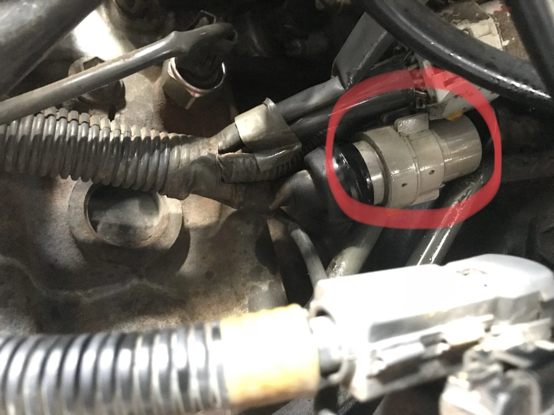

Bad ecu’s happen about as often as you win the lottery but neutral safety switches and the associated wiring has been the culprit several times during my 6 years of reading Mud. Send an erroneous signal to the ecu and it will send incorrect signals to the transmission.
If you haven't done so yet, please inspect the Neutral Safety switch barrel connector. Located driver's side, back of the engine up high and is below the Pesky Heater hose as I recall. These things are about 9 out 10 times the problem with shifting due to corrosion that they develop from water/mud sling from the front tire.
Is this it?
Is this it?

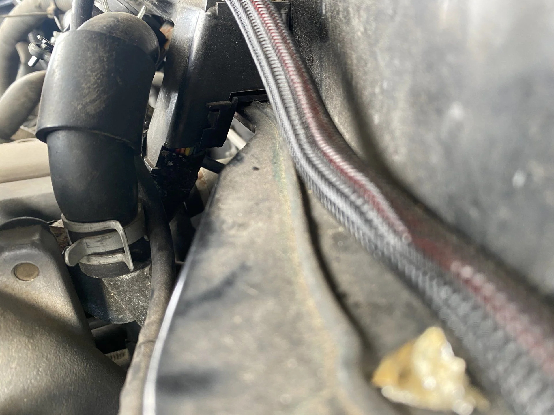

He says the connector in question is located “up high”. It’s actually just below the pesky heater hose as he states (would not consider that up high) and just inboard and above the starter. It is the only round shaped connector in that clot of connectors.
If that connector is good to go then the neutral safety switch needs to be tested.
Here's another thread with a pic of it. I know it takes some long arms to reach it and work on it. That's why the up high comment but below the Pesky heater hose.
