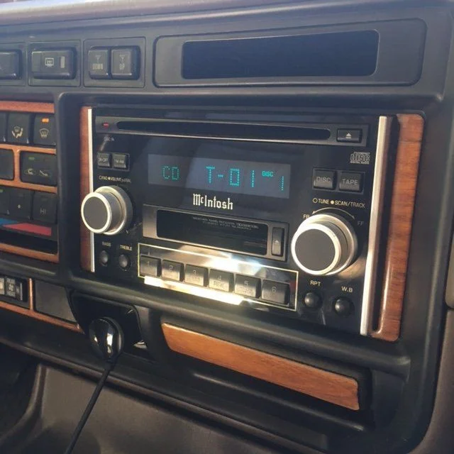

I also just put the Morel Virtus Nano's in the front door. They sound amazing. Crazy how similar in shape they are to the stock speakers, really shallow with the cone inverted over the magnet. They are slightly larger in diameter, so had to make a little room to mount. ended up having to extend the hole where the stock grills attached and then epoxy the grills back on. They are a 2 way speaker, and the tweeter easily mounted on the dash, where there were already stock tweeters.
I found a double din Mcintosh head unit/amp combo on ebay that came out of a '01 Subaru and also installed that. The amp turned out to be dead, so got a small Nakamichi amp instead, and installed under the drivers seat. Sounds really damn good. Still haven't messed with the rear speakers or the sub, but almost don't even need them as is.
The head unit is slightly taller than the stock, and cracked the woodgrain sticker, so i just pulled the top and bottom of the sticker off and left the sides for now. Oh, the unit also has an out in the back for a cd changer, which I was able to plug a bluetooth adapter into. Works great. The adapter has a usb and 1/8 input as well that I just snaked into the glove box.
