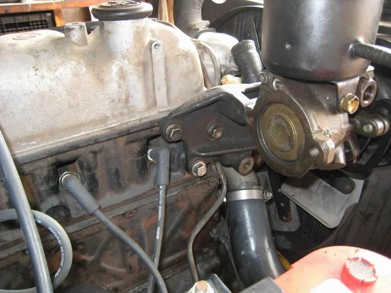

Long story short, I mounted the stock FJ80 (3FE) power steering pump, bracket and pully on my '76 engine block on the passenger's side. It mounts where the engine hoist goes. I will have FJ80 style lines made to go from one side of the truck to the other to mount into my "stock" ps box. I might even run the return lines up in front of the radiator just to get that "stock" cooler feel. I tried to reuse the tensioner and A/C compressor, but they are too different. I would need the engine mounts and they don't seem to work for the 2F.

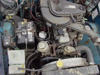

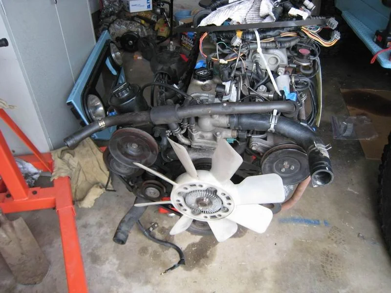

Here is the donor motor...

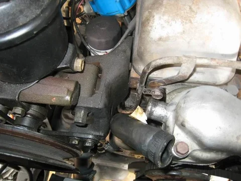

The PS pump bracket close up...

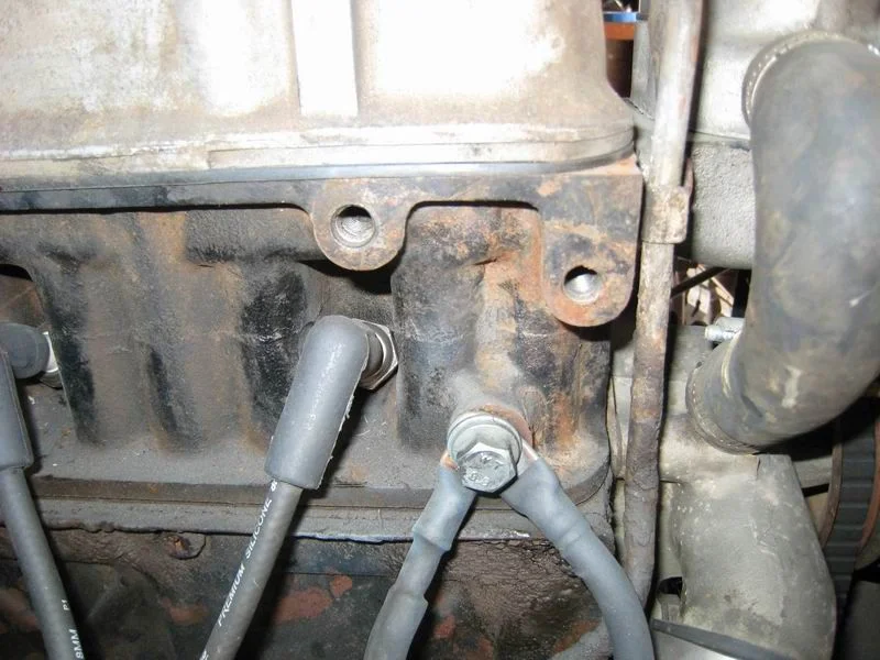

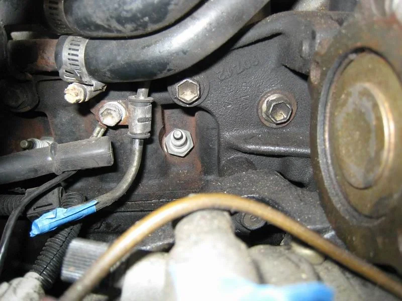

The 2F bolt pattern...

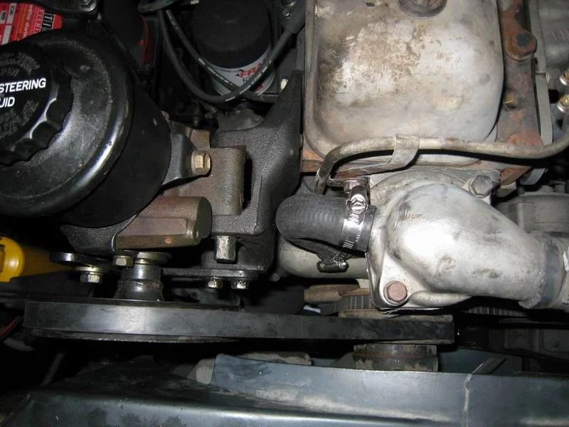

It fit perfectly...
Had to change the water pump to thermostat hose...
With the new hose and belt...

The pump bracket has a tensioning system on it. Basically just swing it up or down. There are other tensioners ont he rest of the brackets but they would not fit onto the 2F.

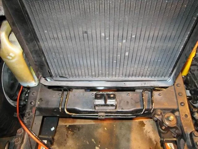

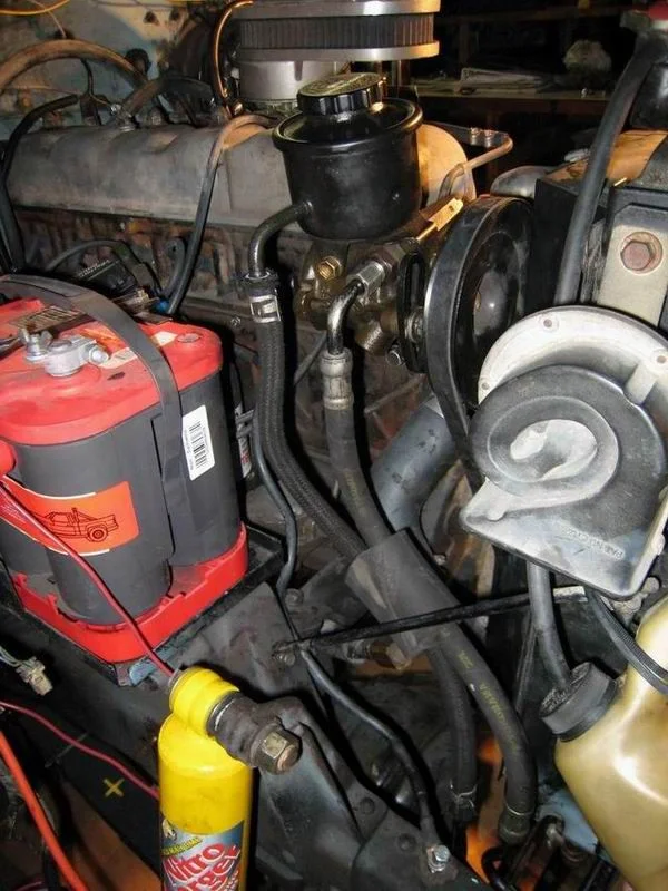

  2. I routed the PS lines along the frame and in front of the radiator. There are holes in the frame suitable for adel clamps to hold it down. It takes about 8 feet of hose.
  3. I used a 17-1.5 to -6AN and a 16-1.5 to -6AN on the PS housing and a 16-1.5 to -6AN on the pump.

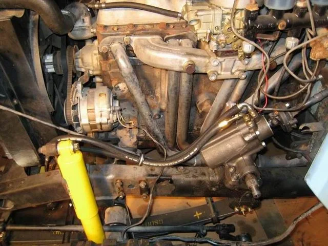

I swapped out the soft lines I bought for FJ80 hard lines. Very nice fit. They also make a nice cooler as they run along the frame.
And finally the pics:
This is where the power steering bracket is stock on right hand drive 40's. The problem with this set up is the alternator is down under the smog pump much closer to the mud :crybaby:
The 3FE bracket look like our right hand drive 2F bracket. Holes in the 2F and 3FE heads are the same for mounting.
This is the reason I run my power steering on the USA side with the alternator above the air con pump as high as possible.
