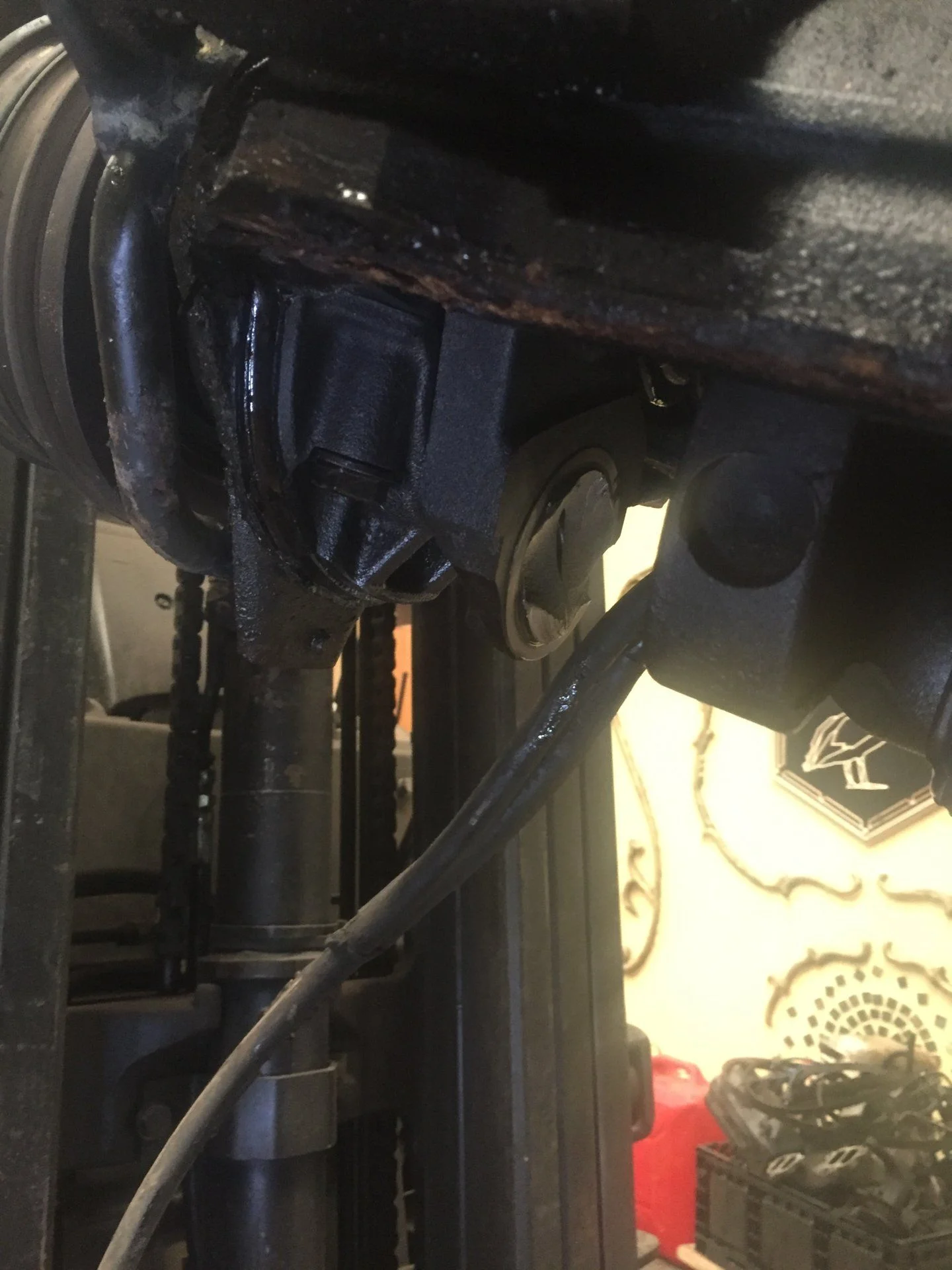

Just wanted to quickly post the results of post-mortem on my 3F-E:
The missus drove my car while I was away interstate, made it 2 blocks away from home, car stalled, wouldn't start again.
Dragged it home, wrenched for 5 days to no avail. Discovered cranking would turn the accessory pulley but turning the accessory pulley wouldn't turn the flywheel. Searching ih8mud told me that this was impossible and cranks don't usually break. Decided to yank it out and there you go: Broken crank.

So cranking the engine WOULD turn the accessory pulley, ie: the harmonic balancer? How the hell does THAT work when the crank is broken?
