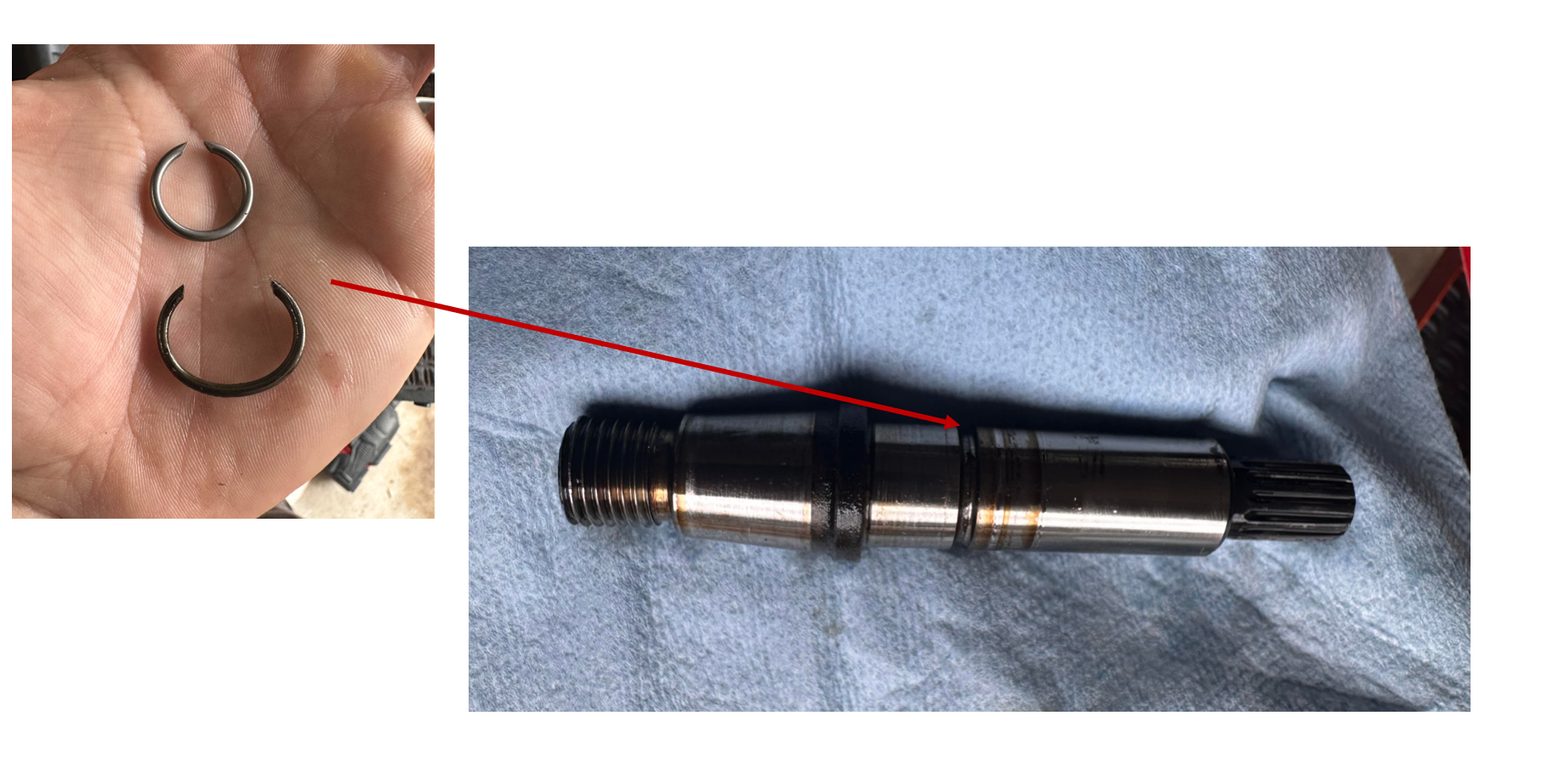

I may have missed it but I think there is a gap in the steps when removing the bearing from the shaft. There is a C clip (I see the part listed in the rebuild portion but not removal) that has to be removed (and will more than likely be damaged). My kit came with a new one. See below.
Also, bearing removal is directional.

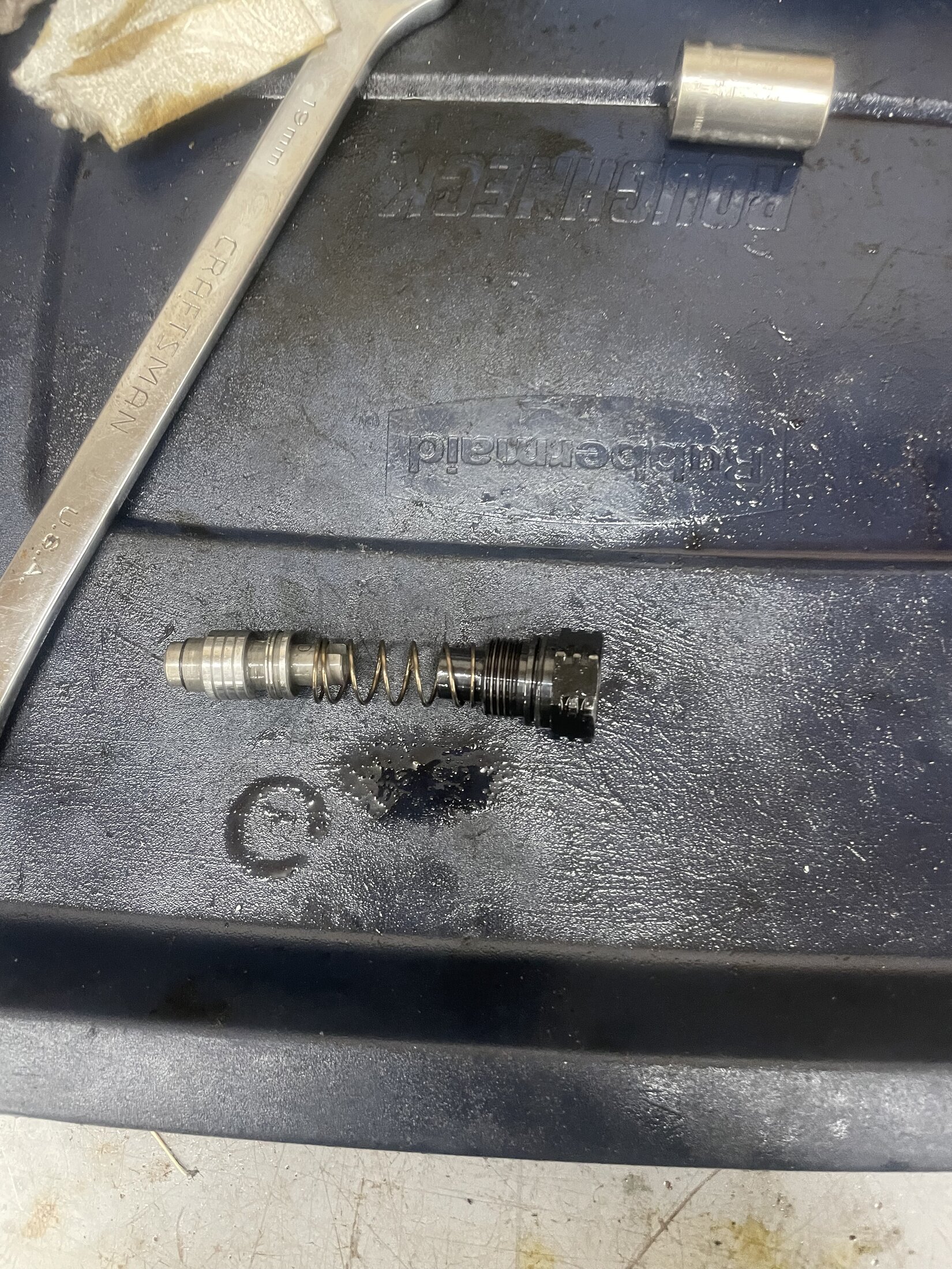

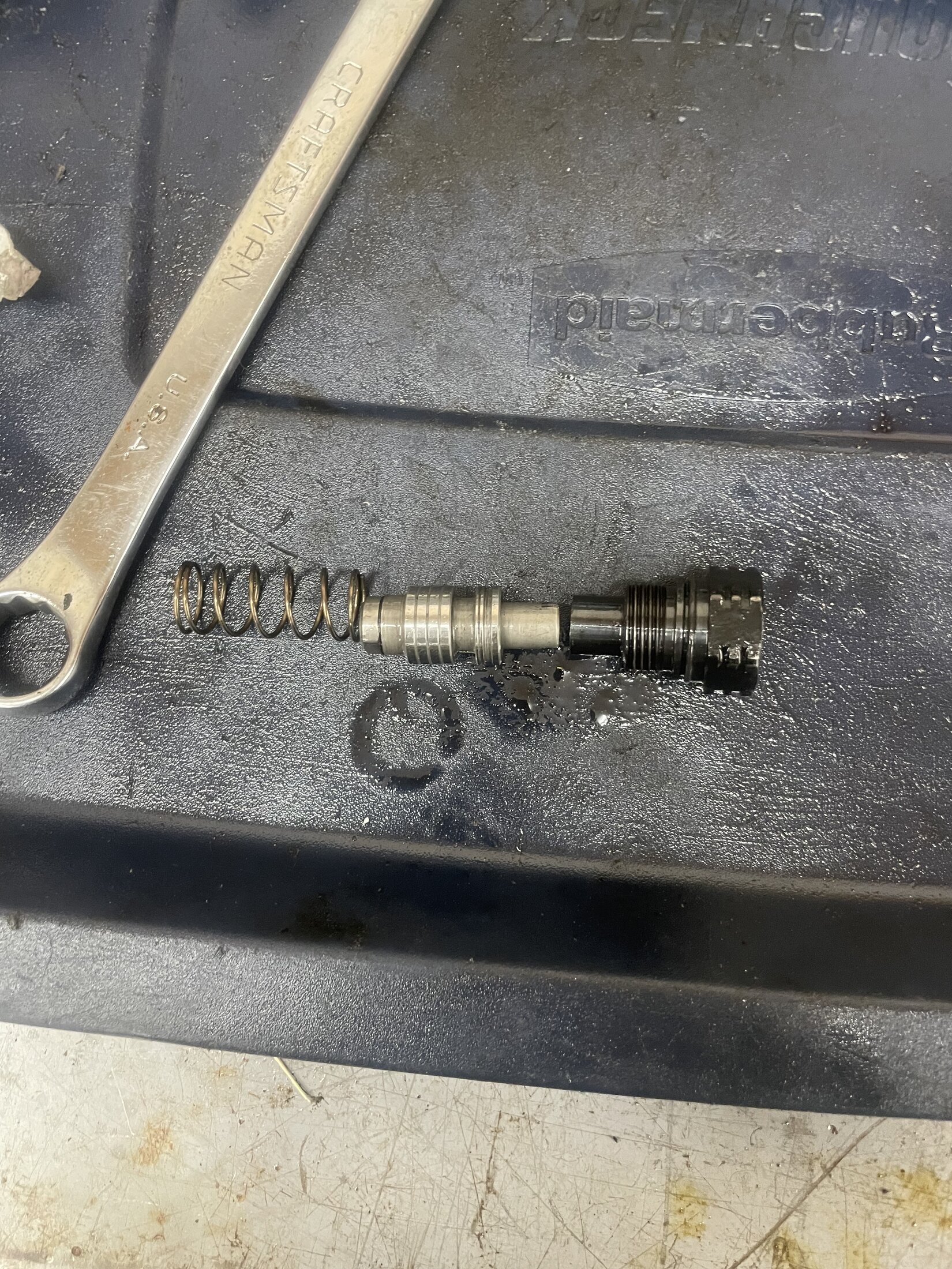

Just preformed this and now I have no power steering even after intensive bleeding… Any ideas? Tempted to just buy a reman from parts store :/
i would say possibly the vanes are backwards or the valve is stuck or something.
take it apart and go back through.
you're always better off with an oe part vs parts house trash.
Turns out I had the flow control spring in the wrong order…
Correct order shown in 2nd photo.
I didn’t even have to remove the pump to fix it :)
